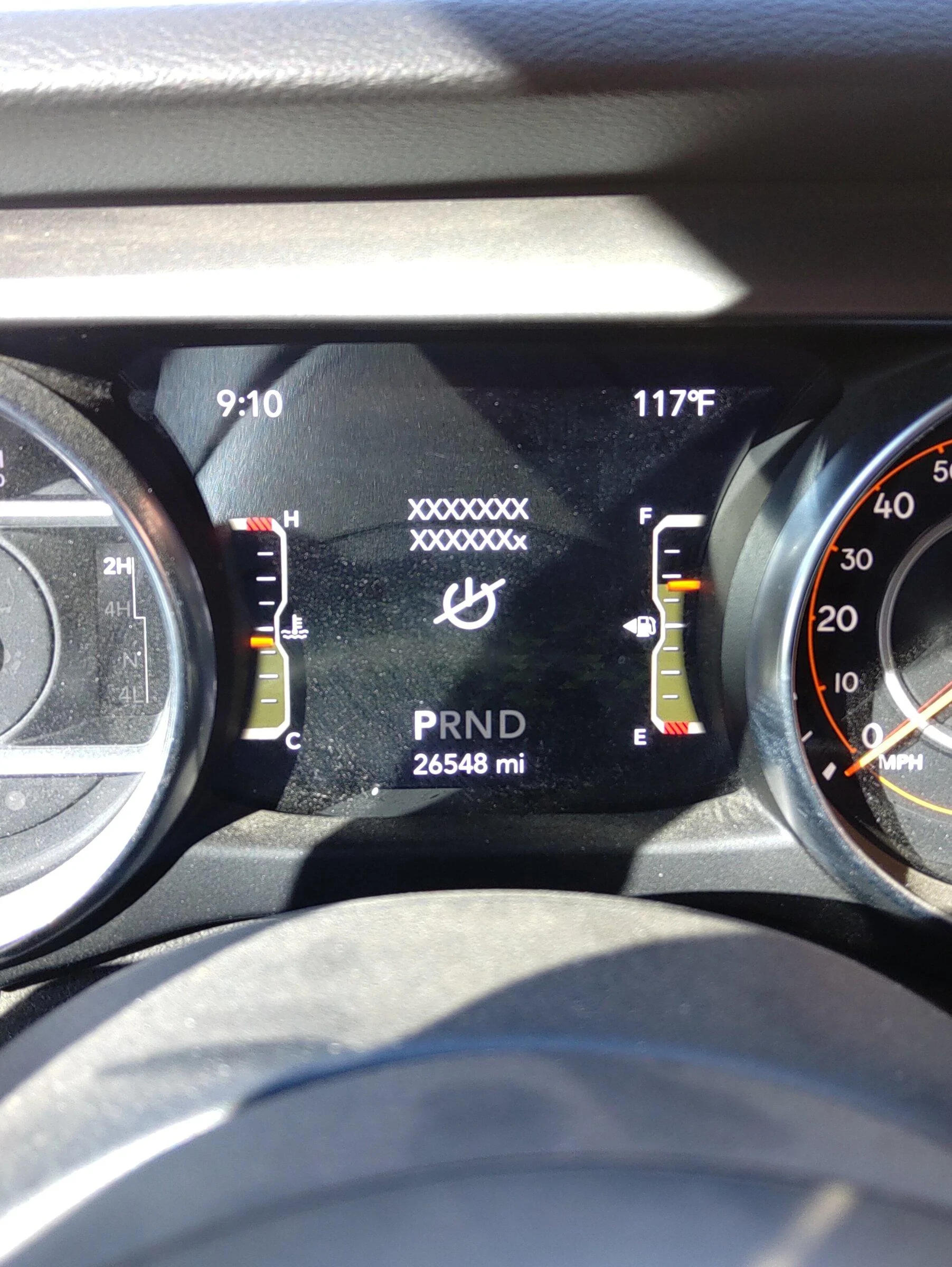

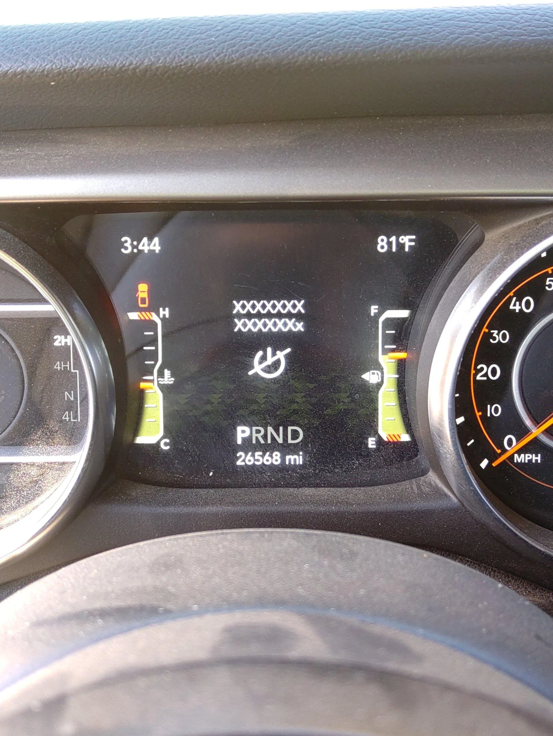

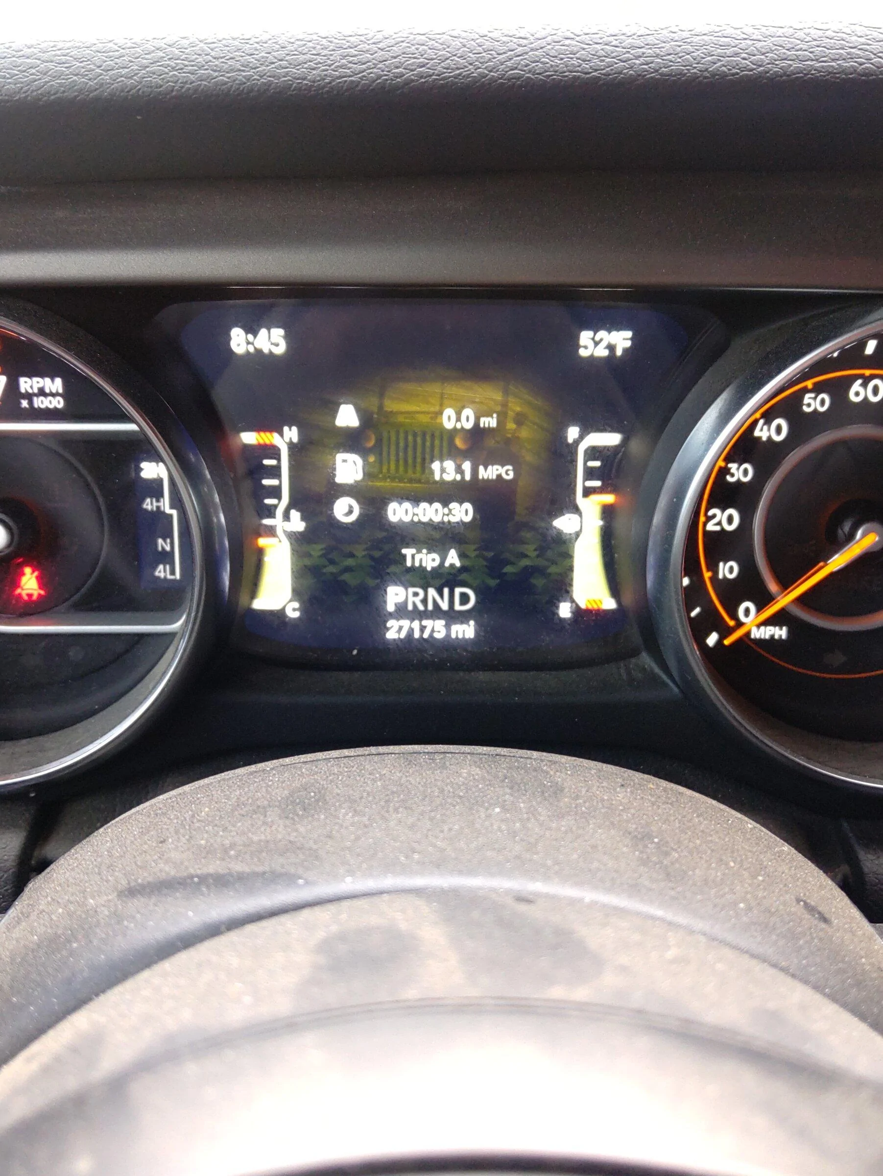

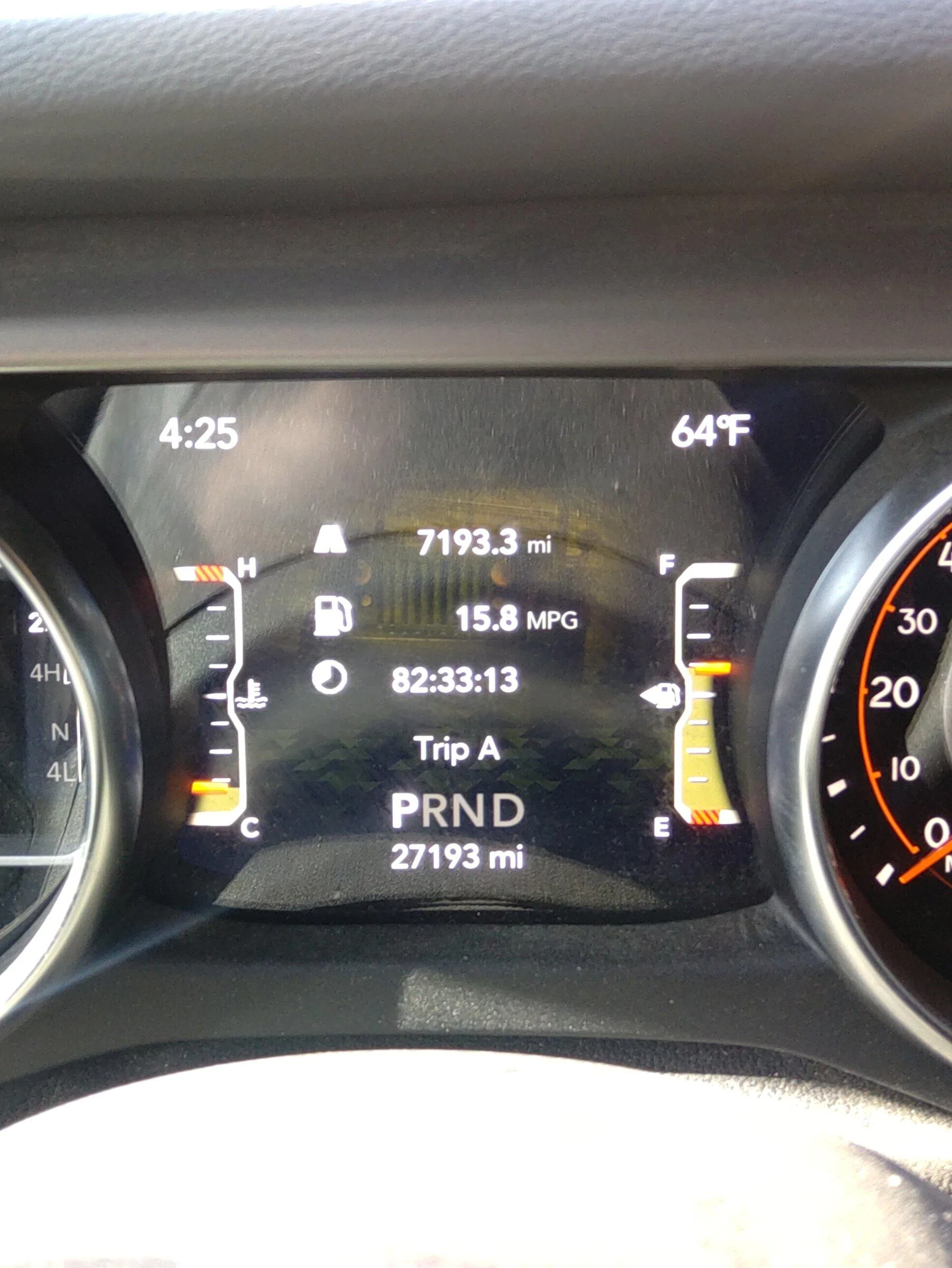

Totally valid suggestions here, I get you. That's my biggest concern - shouldn't. I have these problems that aren't supposed to happen (bad their "engineer" seems more confused than I am) that started once the tazer was married the first time and don't go away when it's unmarried. None of this happened before the tazer was introduced, but their team has been zero help.
I was able to recreate the trip meter issue. I zerod it before work this morning and took a picture when I left the house and again before I left work in the afternoon. It's only been.. 8 hours or so? Not 82.. and you can see the odometer has only moved by 18 miles, but the trip meter reported over 7000?

Sorry, just realized I didn't address your comments on the Audio page of the dash display. There are two problems there, I'll try to explain more clearly.
1) the audio page used to work, with the insane Audio unit, before the tazer was installed - album art from Spotify etc would show on the dash display.
2) the dash display used to remember what page it was on - if I was on the speedometer when I turned off the truck, it would return to that when I started the truck again. Now it just goes to the audio page with the Xs everytime I start the truck. Gotta tell ya, being greeted with a reminder that my firmware is goofed every time I start the truck is not doing a lot of good for my stress level.

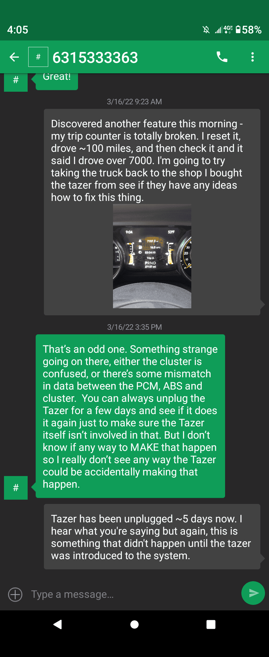

Sure, there could be worse problems, the truck isn't stuck in limp mode, but there are a few key concerns here.
1, I didn't pay $400 for this module to goof my firmware.
2, if these are the issues I can see, what's going wrong that I can't see?
3, the issues with the audio page don't go away when the unit is unmarried, which means it's done some sort of permant damage (in my mind anyways)
The only responses I've got from texting them are basically "that's weird" or "I don't know how that could happen" which.. isn't great..
