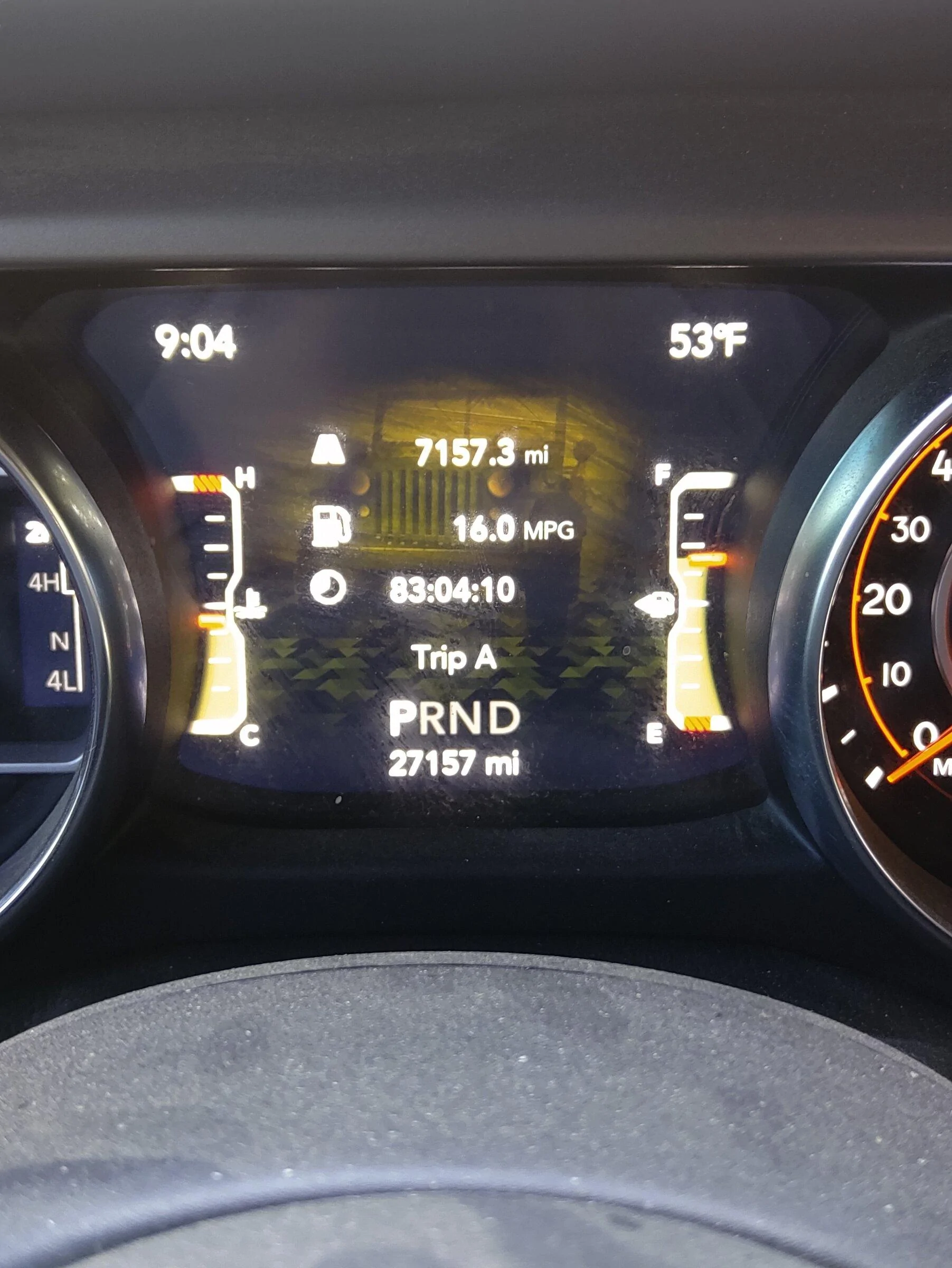

This is cute - I filled the tank a few days ago and have done maybe 100 miles since, trip counter shows I've done over 7000.. thank God the odometer isn't completely broken too, that seems to be staying accurate.
Wow. I truly hate that I even need a programmer. Thankfully we can just use it for vehicle settings and skip the rest. Have you tried unhooking it, but leaving it married?
Agreed. Shouldn't have to waste money and stress on this janky aftermarket stuff to change basic settings.
After multiple "unmarry"s failed to remove the quirks that were created by marrying the tazer initially, I just said screw it and left it married so I could have the tire size set and speedo calibrated - no value in not having those dialed in if I'm going to have these quirks anyways.
As you said though, married, changed settings, sleep cycles etc, then plugged the factory module back in and stored the tazer.
