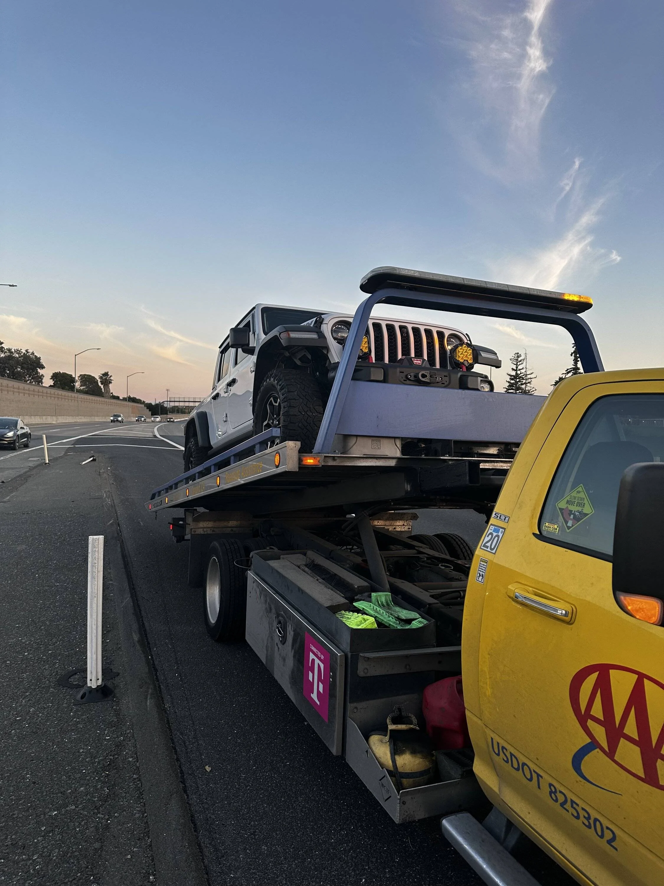

“On June 27th I experienced an abnormal rattling sound and then loss of all power as I was driving home on the freeway from a birthday dinner. I had my 21 JTDR towed to the Walnut Creek Jeep Dodge Ram service department. As it was an overnight drop off, the service department couldn’t start testing until today. I was offered a rental but declined due to the over abundance of vehicles in my driveway. I will pick up my rental tomorrow morning as the Service Adviser(Charles; he’s excellent) informed me that their diesel tech confirmed that the HPFP has left the chat. I will head into the dealership tomorrow and talk about next steps.
I don’t want a buyback. I want this truck. My last JTR had catastrophic engine failure due to camshaft issues and I had to initiate a buyback(lawyer threatened). I don’t want to go through that again. I own this truck. I don’t want to be forced to renegotiate to buy another, again. I will wait for it to be repaired. However, I will probably buy another work truck in the time being. The JT chassis is ideal for me and my work, but so is a Tacoma. I still have my 2015 TRD Pro Tacoma and I’ll likely sell that to buy another.”
