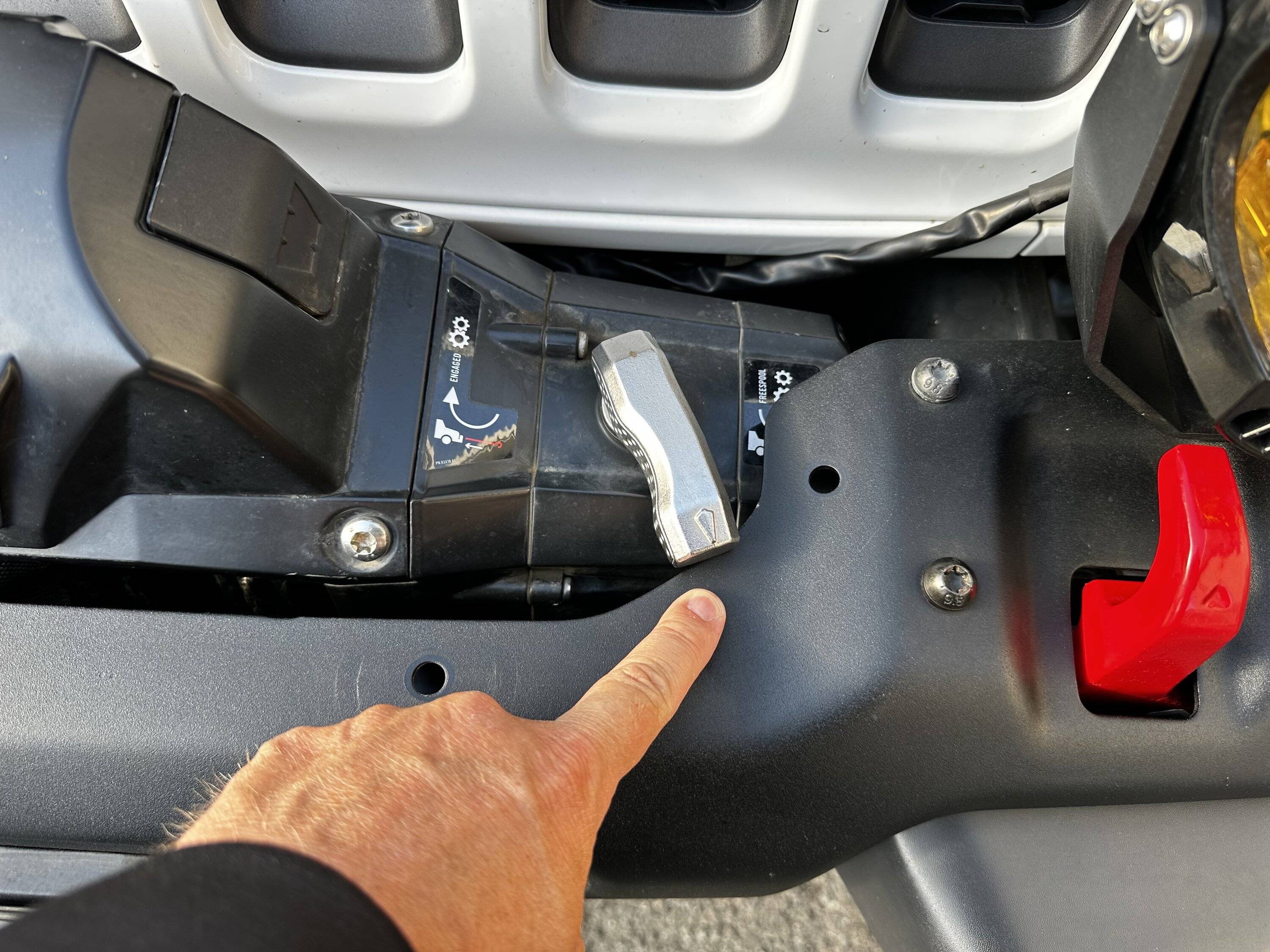

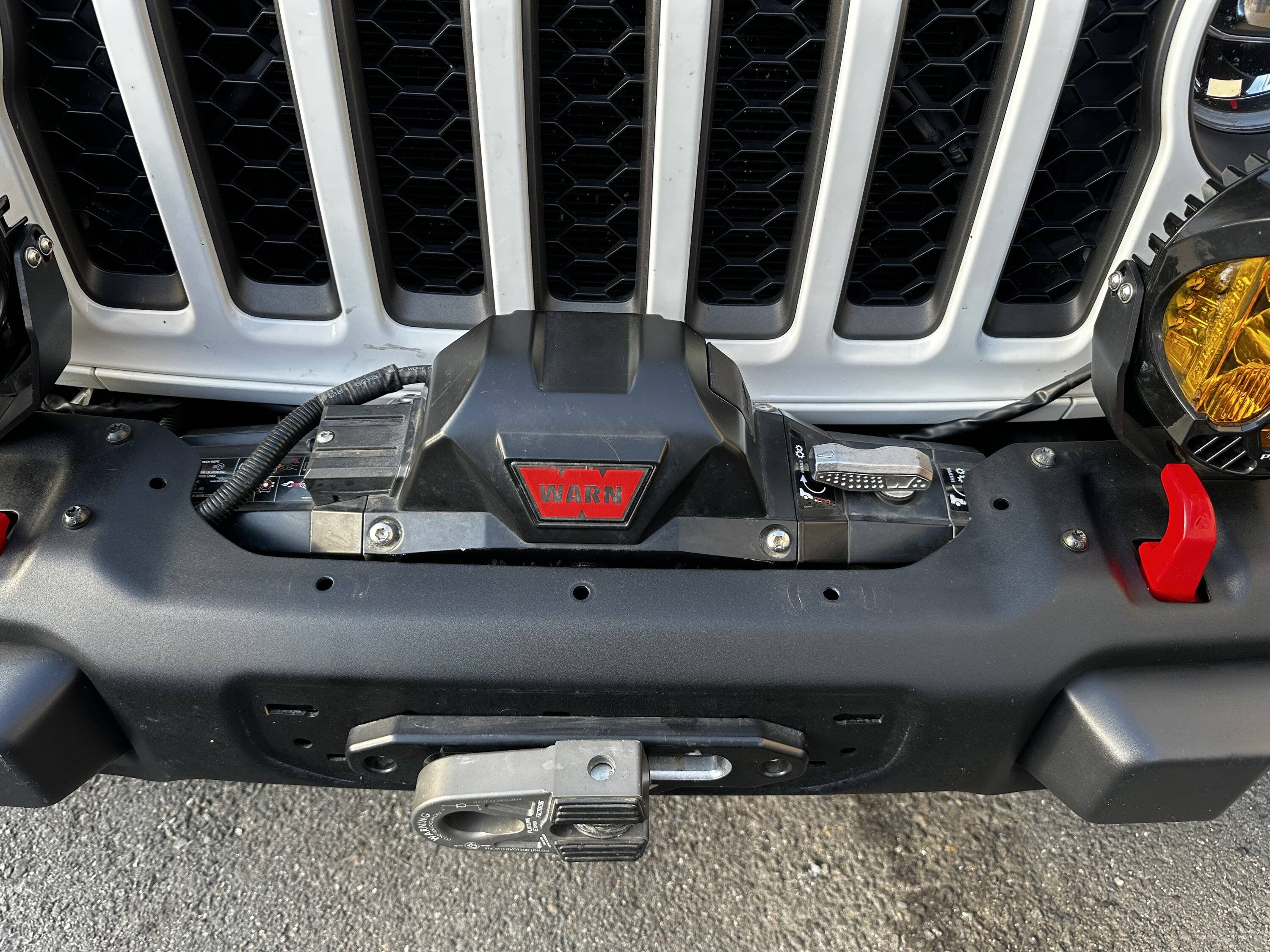

The factory steel rubicon bumper is designed to house a winch. MOPAR specifically uses Warn winches in their design for their bumpers. So, naturally, I purchased the MOPAR winch plate kit.
The instructions are kinda crap. I understand they have to accommodate all bumper models in their instructions, but damn if they aren’t a pain to dissect. And, it doesn’t help that the winch plate is designed to accommodate an 8k winch form factor. Of course, I have a 10k.
The fit is SUPER tight. I actually had to remove the grill to “find” that extra mm. The down side to the extra girth of the 10k is that I now have to trim the bumper so my engage/freespool lever can clear. I’ve left it engaged for now as I haven’t had time to trim the bumper.
Pictures of installed winch.
Jeep Gladiator The JT TRPR IMG_6406
Jeep Gladiator The JT TRPR IMG_6405
Jeep Gladiator The JT TRPR IMG_6129
I totally recognize that I could have offset the winch, as there are holes provided to do so, but that would look “off” to me. So my struggle is really my own on this. I plan on posting a photo of the trim once performed.
Warn has a service part to shorten the throw on the clutch handle specifically for the Mopar bumper I remember reading about. It makes it so the throw is only 90 degrees instead of 180 degrees.
Now that’s a solid tip! I’ll start digging for a part number. Thanks!
DO NOT CUT THE BUMPER. Rotate the handle or get the shorter handle.
I’ll take your “demand” into consideration…

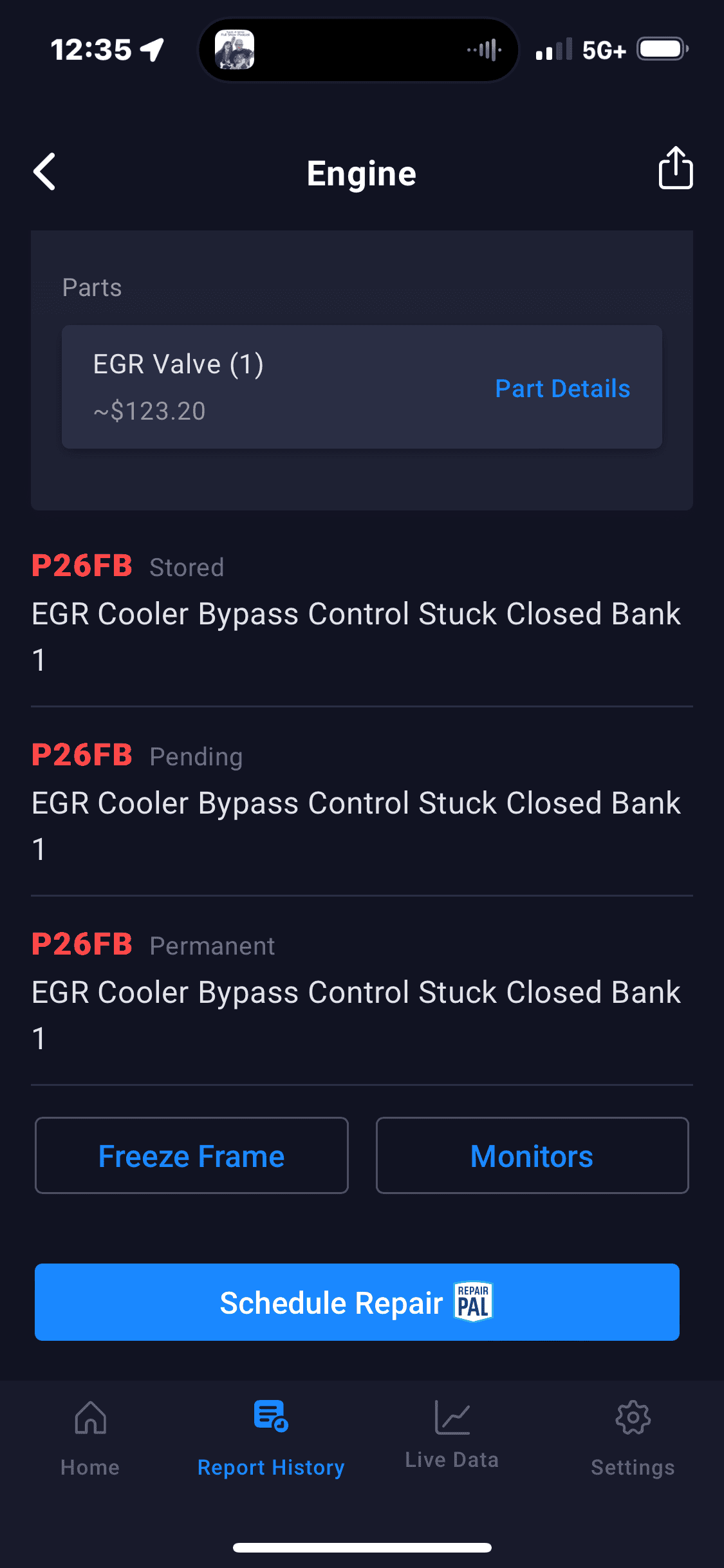

in other news, the Gladiator has sprung another CEL. This one has a TSB associated. So, back to the dealership for service.
Just trying to help.

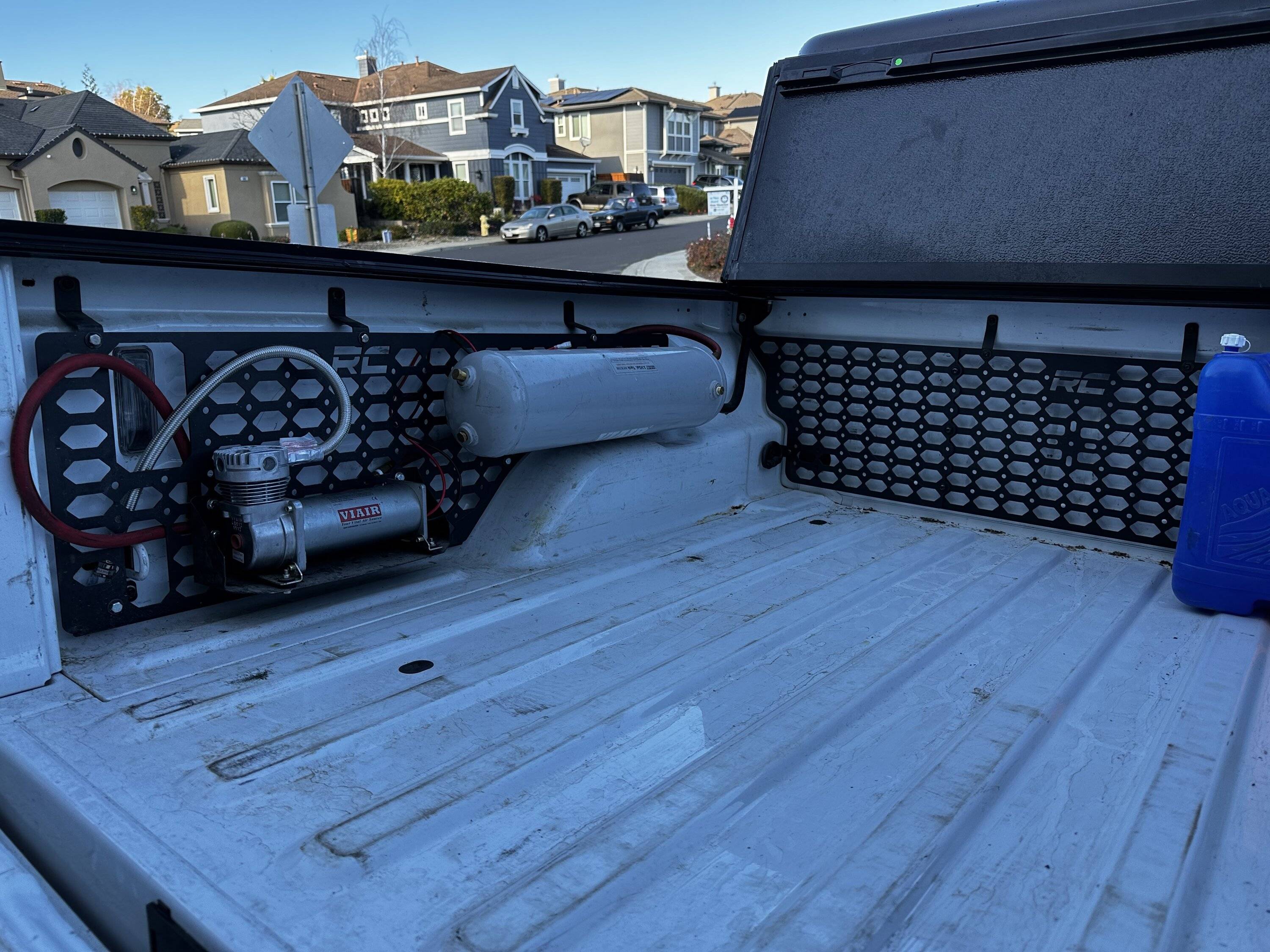

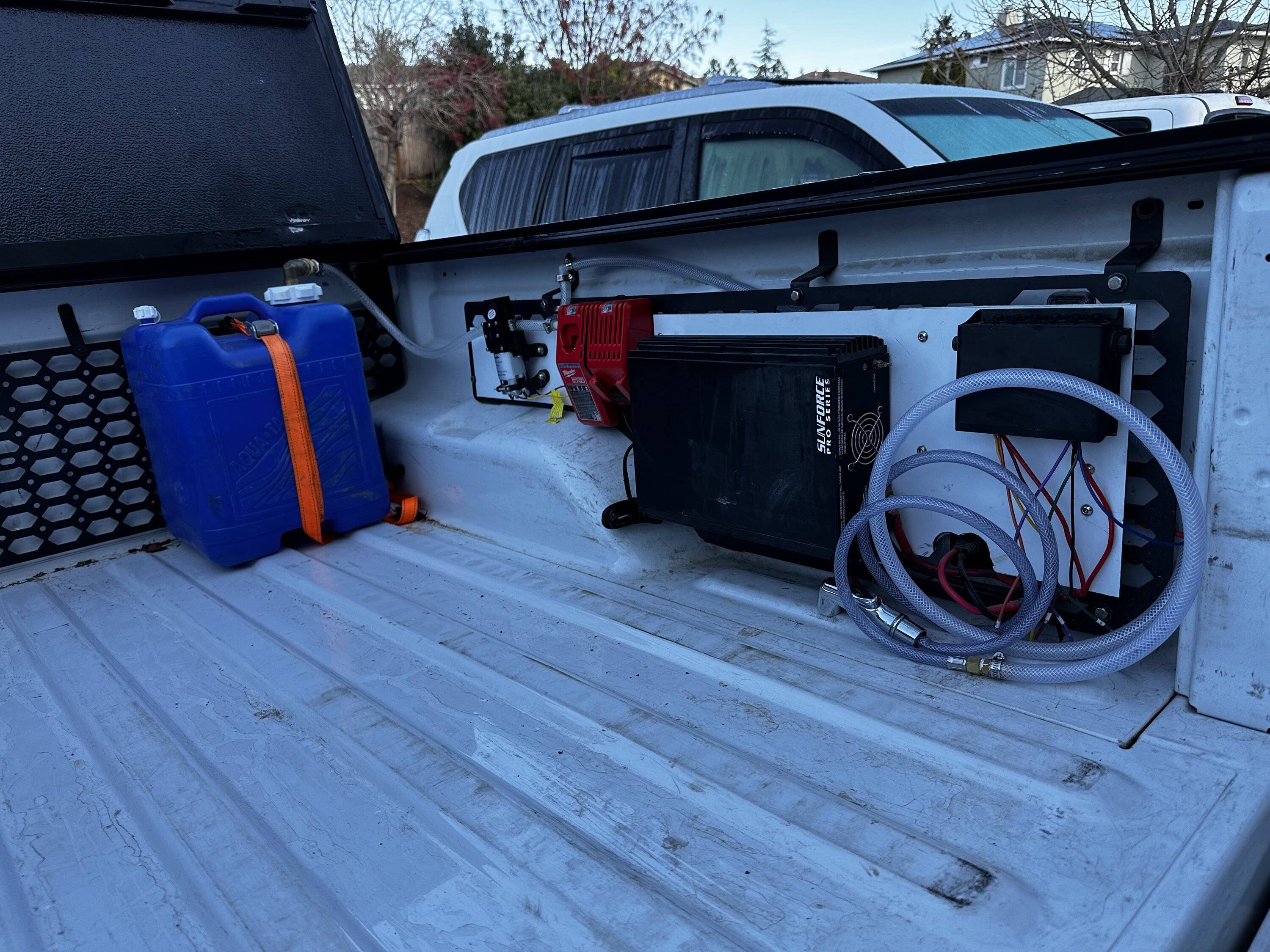

Last week I replaced the batteries due to an error on my part. The error was leaving the inverter on overnight for two days. I had shown a customer my electrical setup and forgotten to turn the inverter off. I had a battery charging in the Milwaukee multi charger and it drained my batteries dead dead. Yes, I have a 2000watt pure sine inverter installed in my bed. I also have a 7gallon potable water storage and delivery system as well as a hard mounted Viair compressor and tank(it’s not hooked up still because I am on the fence wether or not to add in the secondary pump).
A few days ago I replaced like for like tires due to hitting the wear bars. The Goodyear Duratrac tire has treated me and my adventures well, especially in the snow. I wanted to go up to 37’s, but time and indecision prevented me from doing so. I really would like to have a taller tire, but at the same time I have to remind myself this is the “work” truck.
Regarding the HPFP; I have the recall pump on order with my dealership and it will get replaced when they have it onsite. I haven’t had any issues with the replacement pump since getting it back from the dealership, but it feels like a ticking clock to me. Eventually it will come around to midnight again…
Pics of bed stuff for interest:
Jeep Gladiator The JT TRPR IMG_0819
Jeep Gladiator The JT TRPR IMG_0820
