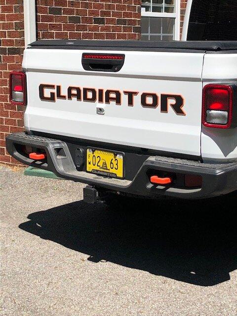

Took off the Hauk gladiator letters today & what a PITA!! Jeep letters were a breeze to remove compared to the Hauk’s
Curious, How did you remove the Jeep Letters? do they just pull off or do you use dental floss or are they mounted with bolts?

Thanks! I removed them today, it was 100 degree's so no heat gun required. It was kind of a pain getting the glue off I'm not gonna lie lol, Just got to keep dabbing with the glue roll, nice and clean now.

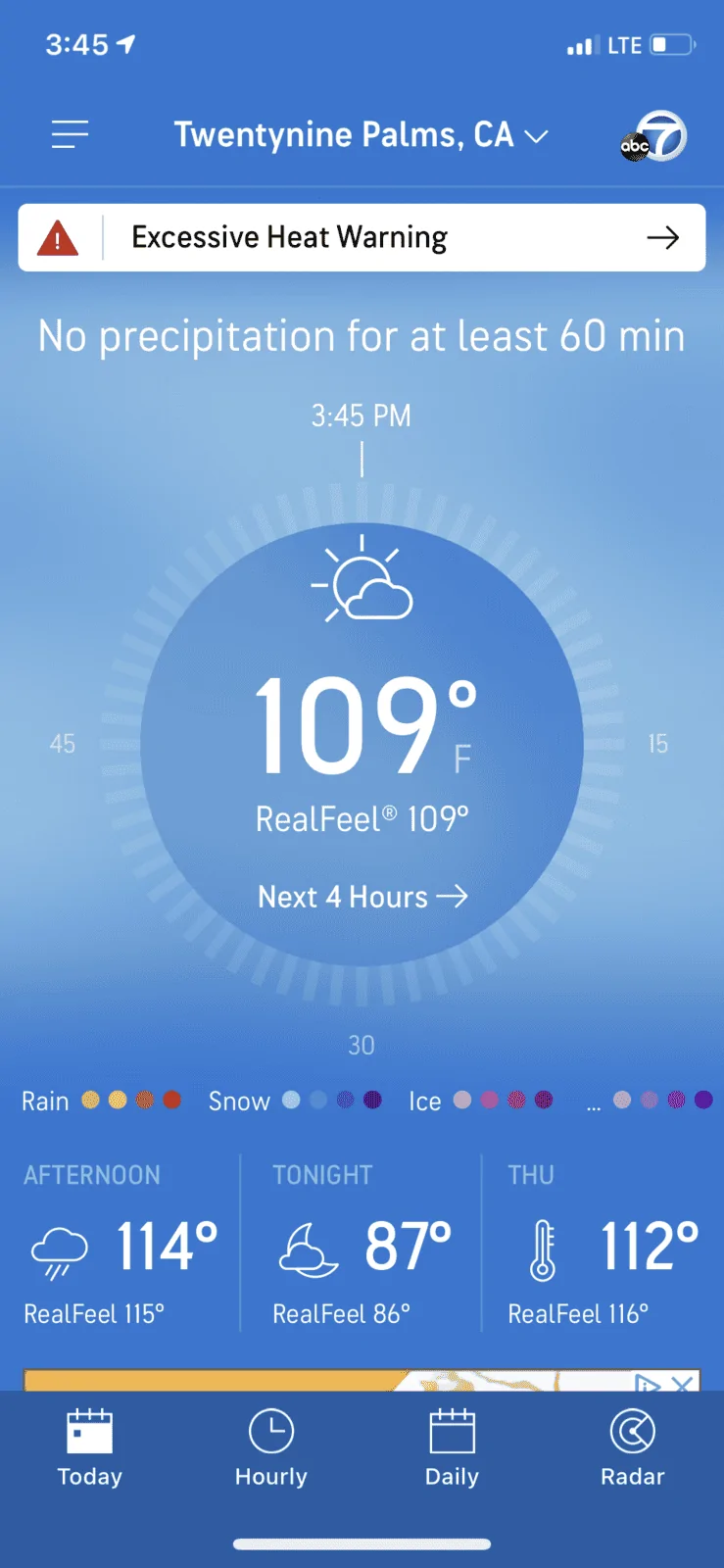

LOL but we may have -20 below here in a few months :) 114 is a bit too hot, 100 today was good enough to heat the tail gate to remove the emblems without burning the hands. I waited for the clouds to come by so it had cooled things down just a tad.

Makes sense with the adhesion piece. I'll be replacing the Jeep emblem with the GLADIATOR tailgate emblem, it's on order but wanted to get the hard part out of the way while the temps were high so I wouldn't need to purchase a heat gun. I also removed the dealer stickers, didn't want to be a rolling advertisement for them.
