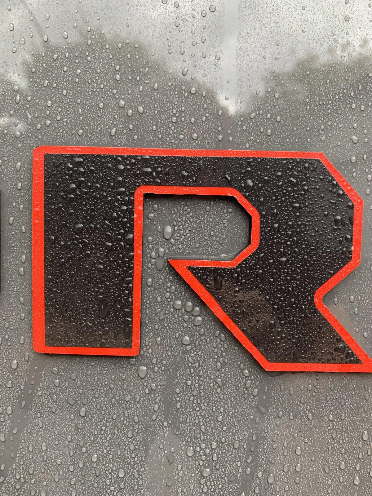

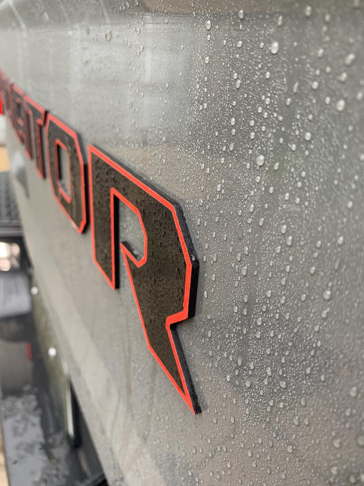

For those that have the limitlessparts gladiator letters, are they made from two pieces of acrylic to form one letter, or is the outline of the letter cut into one piece of acrylic to make it look like two layered pieces?

Looks to me to be two layers of acrylic. The bottom red piece is 4 or 5 times thicker than the top gray piece. The whole thing is just under 3/16 thick.
I would use my calipers to measure if I didn't have a teenage son that didn't put tools back when he used them
Mine is still sitting on my bench until I can figure out how to install it straight.

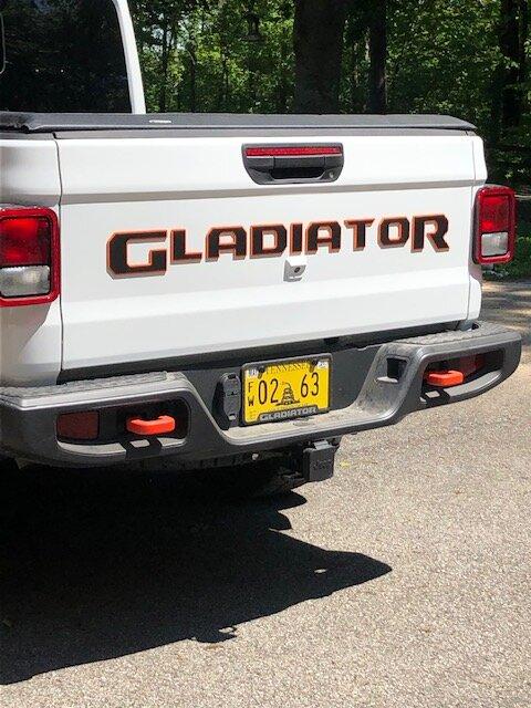

If your lettering is flat on the top, simply level a long straight edge and tape it with painters tape. Then, start by centering the letter "I" in the middle and then space them 1/2" apart from there. If you were not provided a spacer of 1/2" it is easy to make one. That way you have the top and the space between established. All else falls into place.

That looks fantastic on the white. Thank you for the advice, that is the method I will use
