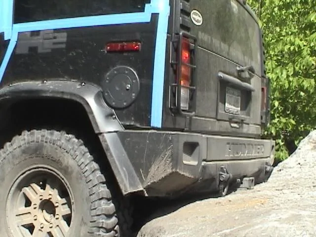

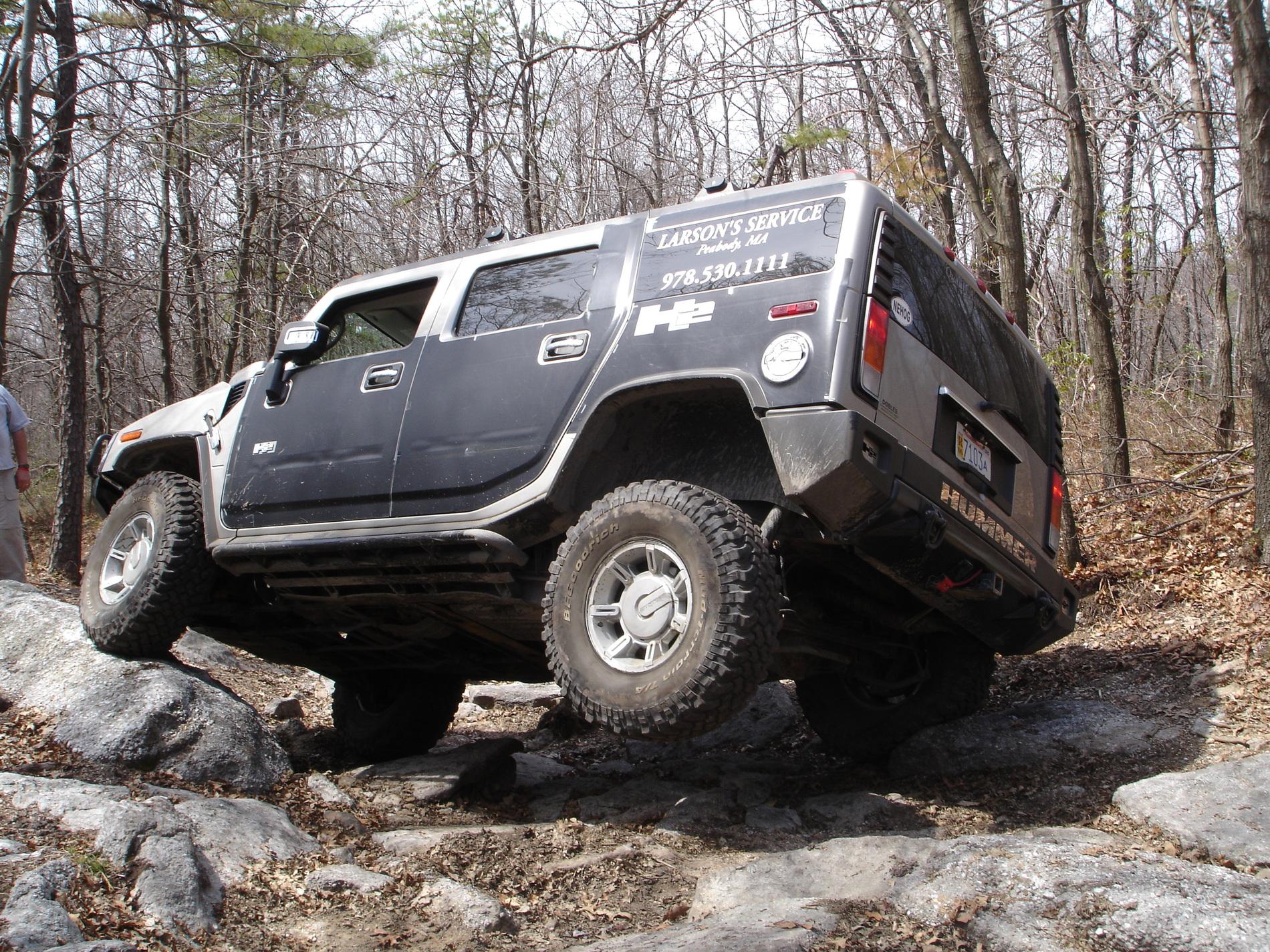

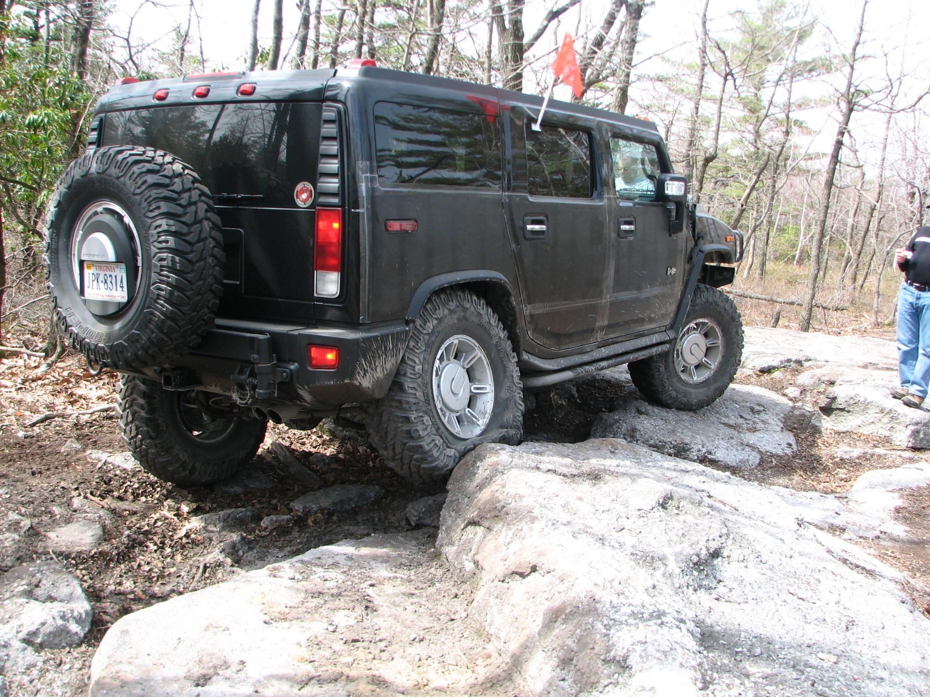

Wrong. I had an H2 I drove for 120K miles, and they had strong rear locking axles with the SOLID rear axle. They did not come with locking front independent axles. Wrong. H2 friends I wheeled with who put aftermarket lockers on their front end broke them regularly when the rear axle lockers didn't break. Not a coincidence. It's much stronger to lock two solid axles together than a bunch of pivoting parts. The H1 and the Military HMMVSs I drove for thousands of miles are stronger because they are hugely over-built. But you can't really claim that the Offender has that. You can keep arguing, but locking pivoting parts are inherently weaker than a solid locking axle. You can compensate for that with huge amounts of steel. Are you claiming that that the Offender does that? Not.
H2s had independent locking axles? You really should talk about things about which you have some knowledge.
They only came with rear lockers on solid rear axles. Here are pics of mine and one of my friend's:
Solid rear locking axles:
Jeep Gladiator The new Defender 110 XDPZRon
Jeep Gladiator The new Defender 110 EF0PS0U
No locking independent suspensions on H2s. Wrong.

Lol, sorry, not h2, the original h1. That thing had full independence suspension and lockers and was a far sight tougher than a rubi (and especially an h2). The h2 was a souped up tahoe. You were brave to off road it.

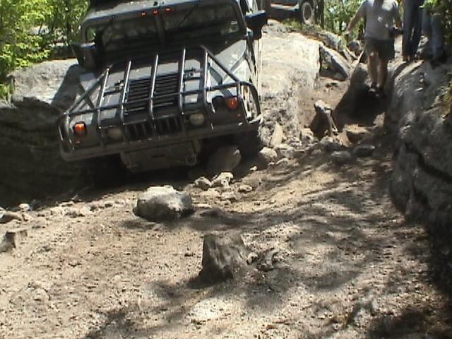

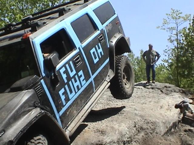

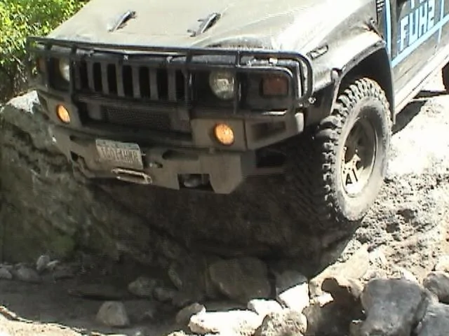

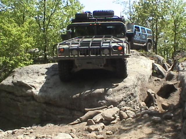

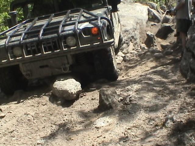

Yeah, the Jeeps fit into some places where H2s don’t, and they have greater front axle articulation. But the H2 has some advantages on open terrain, including that you could put 37s on them with no lift, which made then, IMO, really stable on inclines with a pretty wide stance and low center of gravity.
The H1s/HMMVs do have crazy strong lockers and control arms. In the pics below, the guy in the H1 just smashes over that rock in the second pic with no trouble.
Jeep Gladiator The new Defender 110 Prfidaq
Jeep Gladiator The new Defender 110 8JJhmgt
Jeep Gladiator The new Defender 110 fSnUklO
I am unaware of any other relatively-mass-produced vehicle that has that amount of steel in the front-end components.
