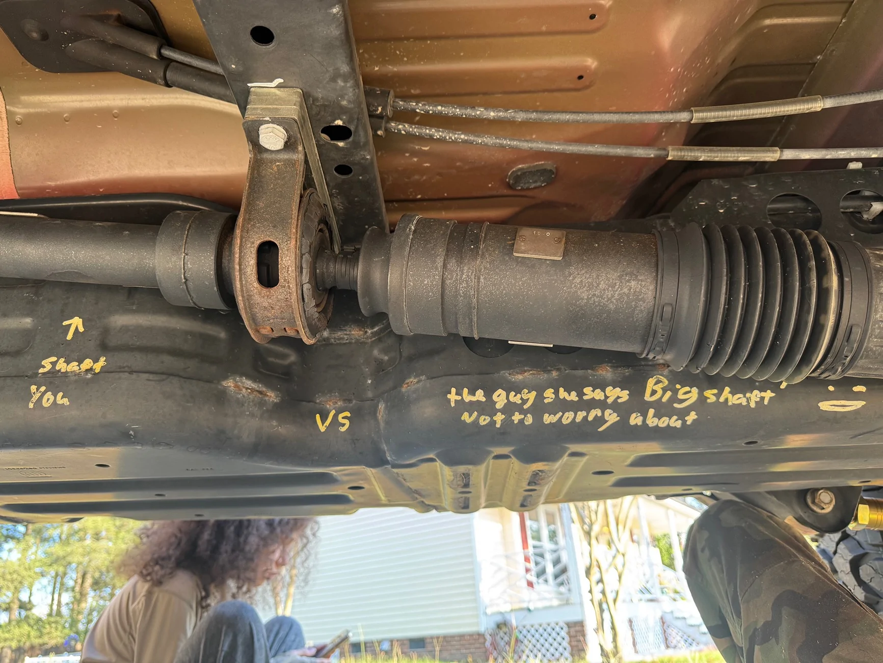

I bought a used 2021 Willys with a 6-Speed manual on 26 October 2024. The previous owner had installed Oracle LED headlights, and someone that crawled under it prior to my ownership installed a joke.

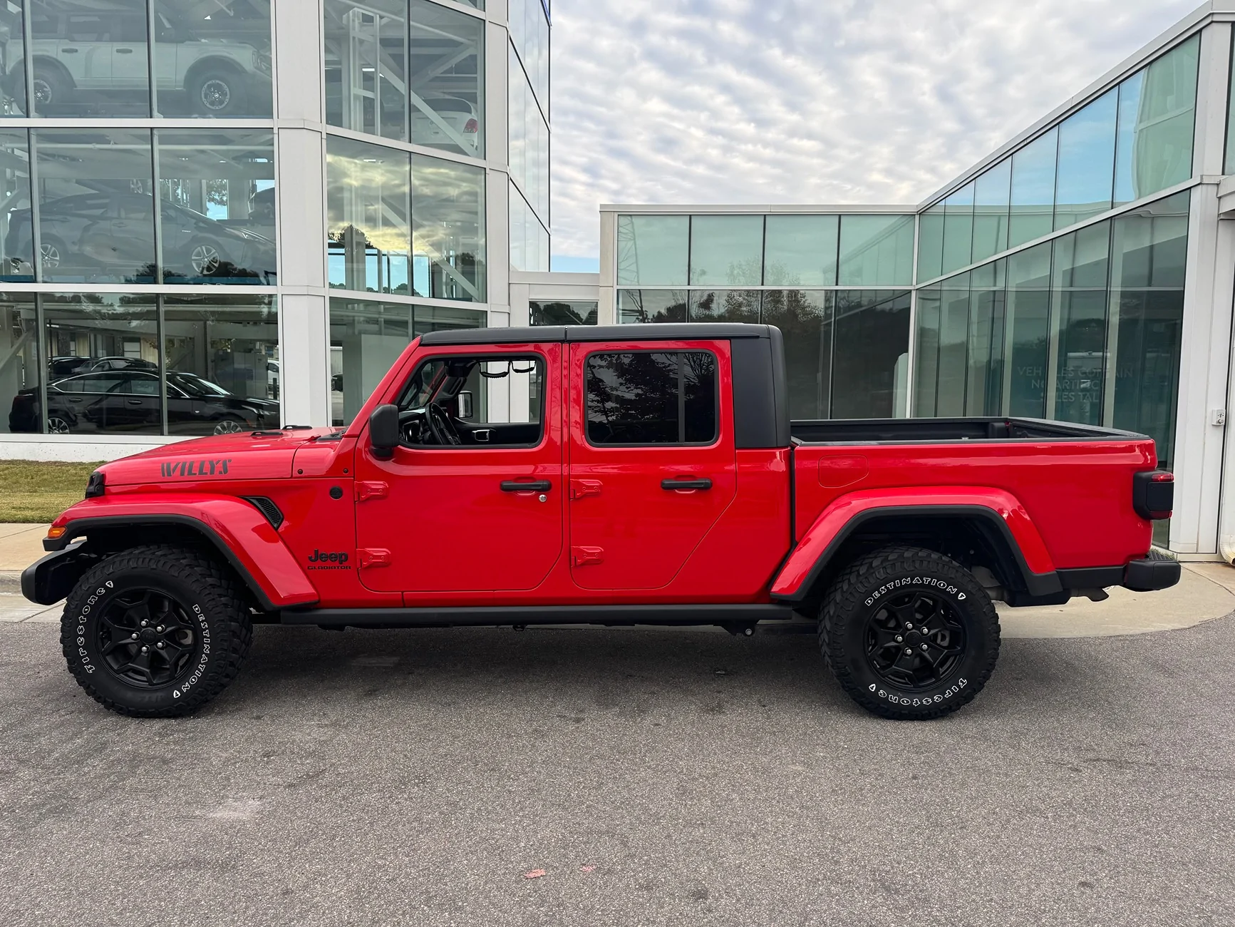

As I got it:
Jeep Gladiator The Robocon on 38's IMG_2735

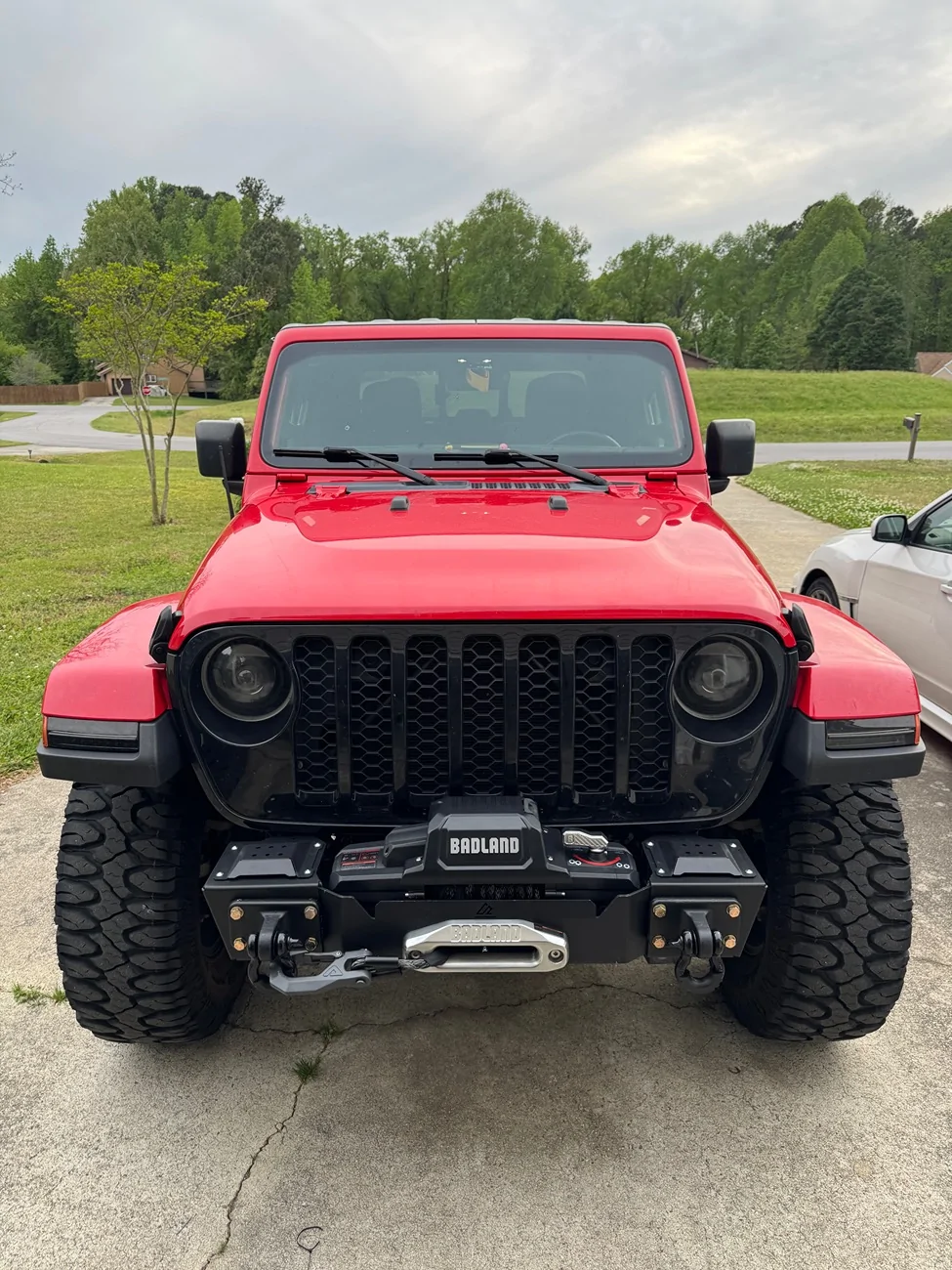

Bumper and Winch
Jeep Gladiator The Robocon on 38's IMG_4720

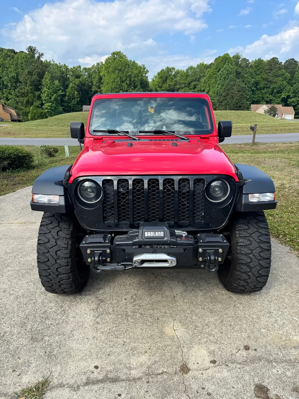

Fenders
Jeep Gladiator The Robocon on 38's IMG_4944

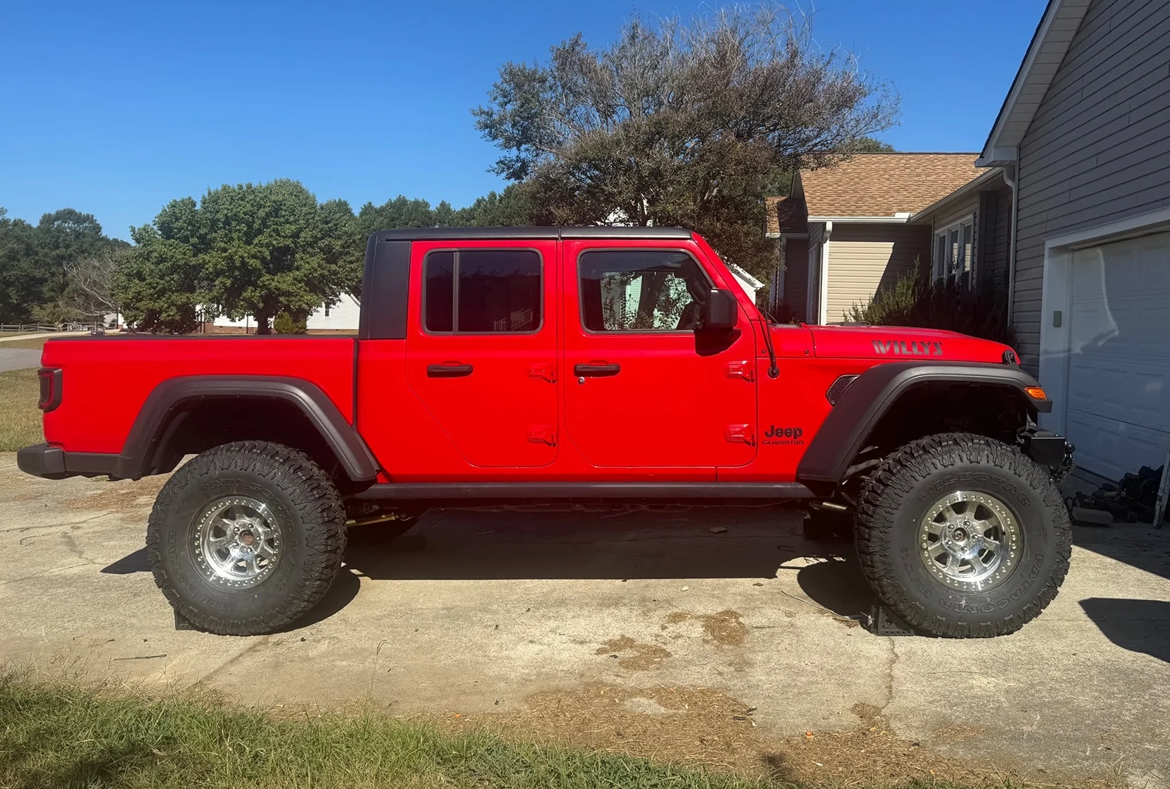

Currently
Jeep Gladiator The Robocon on 38's 483293-9f208e2ccb06c38170edea30cb8598b1
The Joke:
Jeep Gladiator The Robocon on 38's IMG_5244

That's a good looking side view.

That’s a good looking side shot , standing tall !
