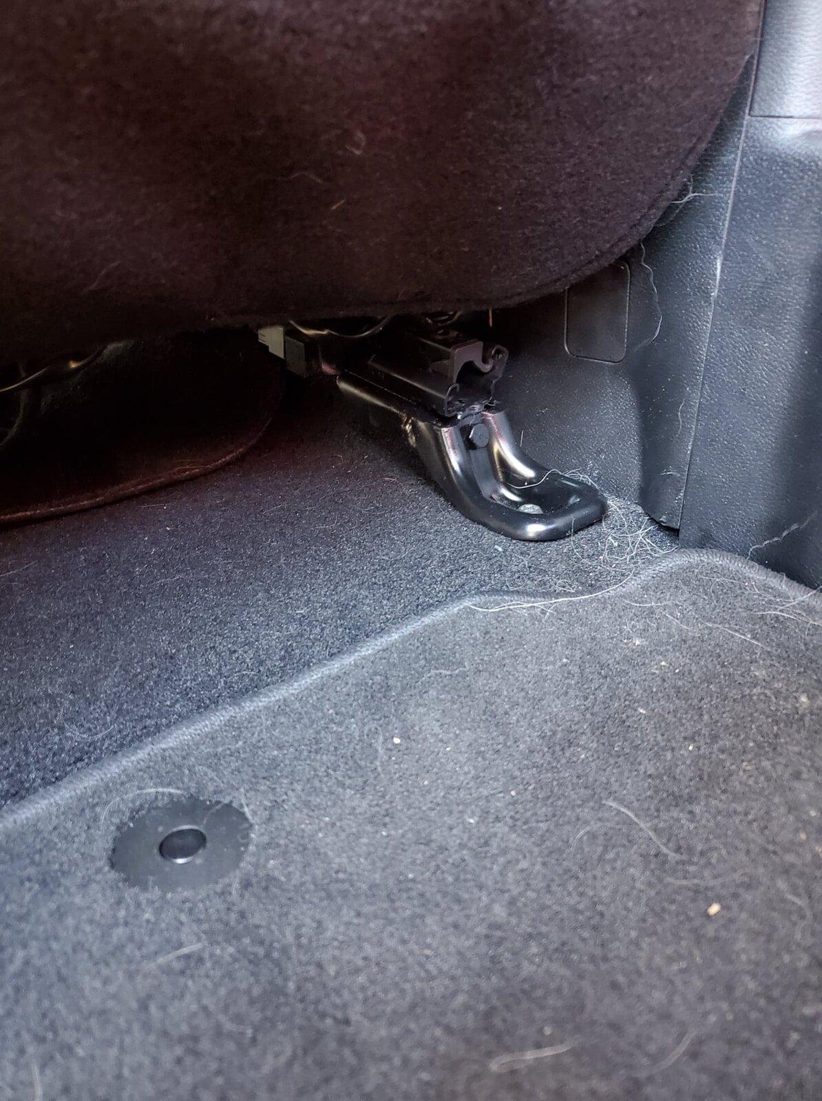

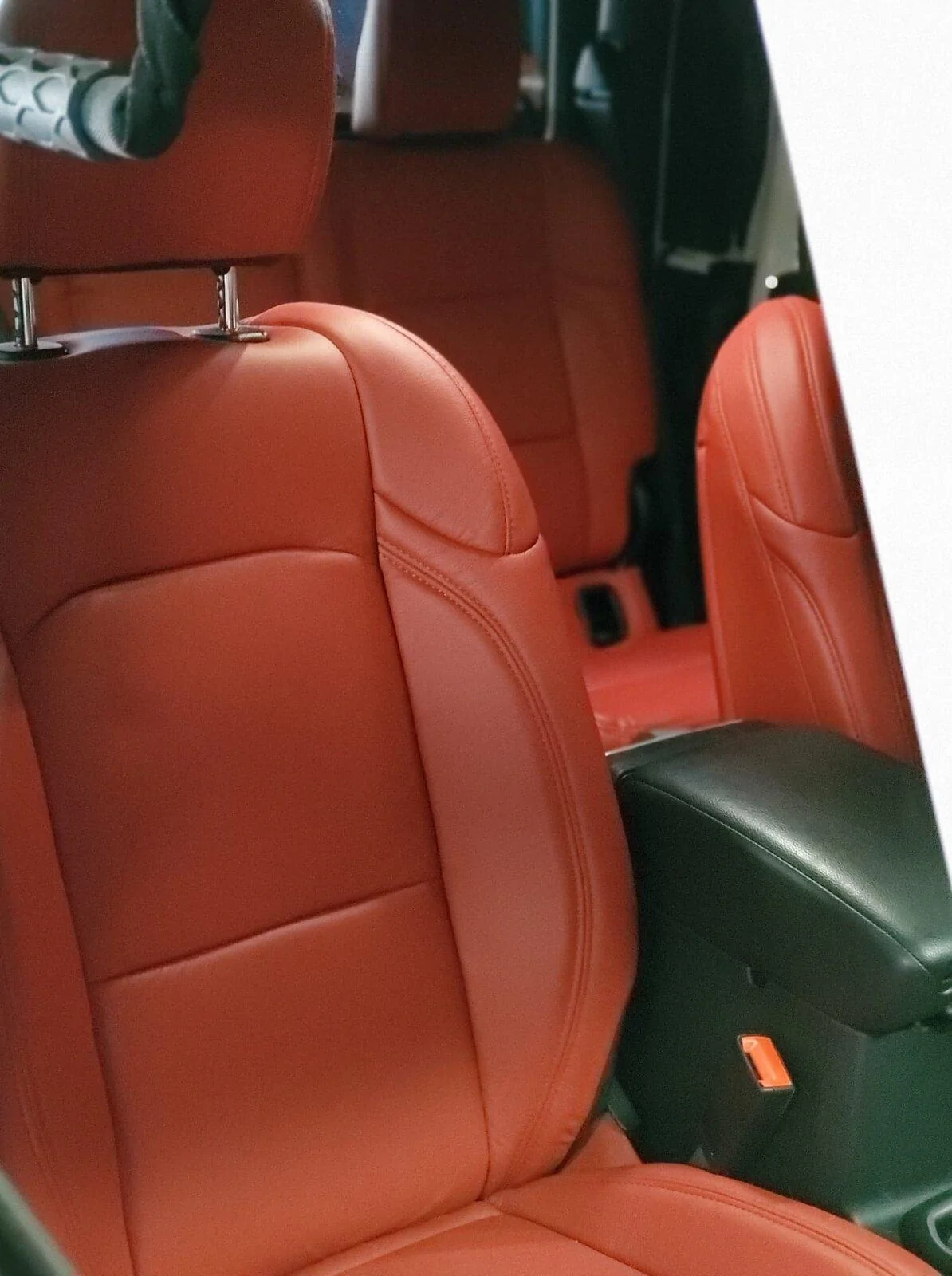

GREAT thanks! I am going to yank the seat and give the gear seat lowering stop a quick grind. I tried the leg replacement using 1 1/4" tubing AND the Misch brackets, that did not work for me. The Misch brackets are such heavy steel and are one piece for each side it gave a huge angle front to back for the seat and actually RAISED the overall height of the seat! i think with JUST a little back angle, my knee will be out of the dash and I am good to go!

I got a decent back angle out of just chopping the back legs. The seat is visibly lower than the passenger seat now. It went back together so smoothly that I don't think anyone would look at it and realize that it had even been altered. This did the job for me, although it would have been even better if I could have dropped the front an inch too.

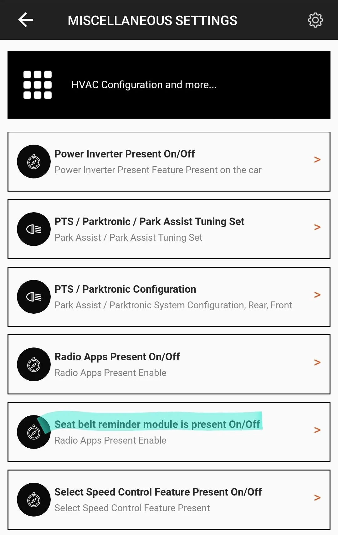

Absolutley love my gladiator but the only thing that drives me insane is the dam seat belt beep screaming at me. I don't mind wearing my seat belt but just a 5 min drive to the store or down a dirt road ...come on? And on top of that it doesn't stop like most past cars Iv had after 3-4 beeps. It keeps going and going and going.....is there any fix for this? Or setting ? Does it drive you guys nuts to?

JScan can do it
Jeep Gladiator The seatbelt beep driving me nuts!! Screenshot_20220703-141333_OBD JScan
