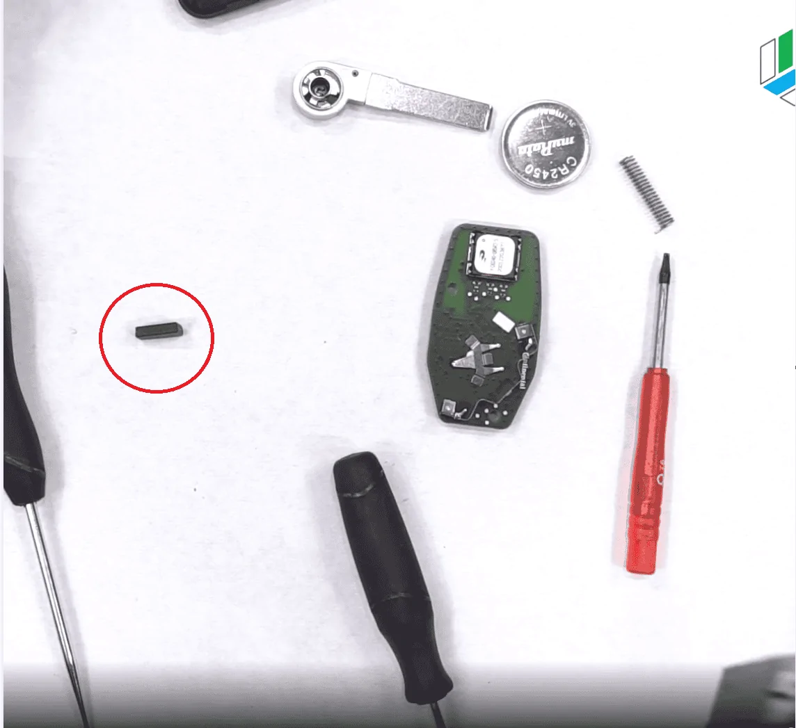

Disassembled Jeep fob with RFID circled. Probably no way to trigger prox locks with that. Can start the truck though.

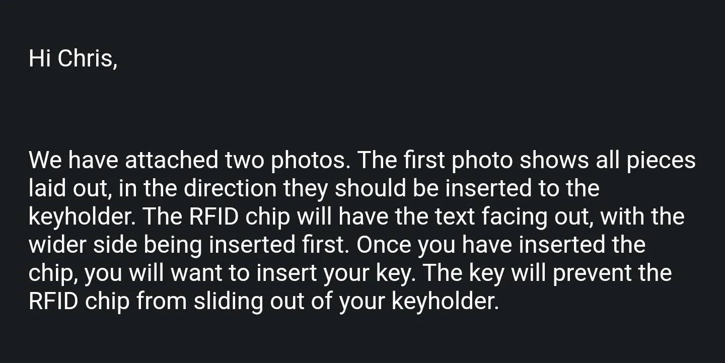

Confirmed with Threedom in case any doubt! :)
Jeep Gladiator Thieves Use Proximity Key Fob Relays to Gain Access. 1652900298435
Proximity attack = defeated
Keypress code attack = defeated
My plan is to have 2 setups:
Fob 1: Fully operational with battery. Keep in faraday box in house and use when going somewhere this isn't an issue.
Fob 2: Remove key and RFID, install onto Threedom key holder. Remove battery. Set aside. Use this when any concerns such as going out in the city etc.
Wait...so if my gladiator has manual windows/locks (aka big a$$ key fob with no buttons) I can disassemble my fob, take out that little thing you circled, attach it to any keyring of my choosing, and it'll start my vehicle???
please say yes. that would be awesome!
ecidiego
Nov 3, 2021
55
2,910
4,317
San Diego
2021 Gladiator Mojave
IT
Yes. You have to physically touch the key to the start button while pressing though....getting the area of the RFID as close as possible or you may have issues.
This exists so a dead fob won't cause a no start.

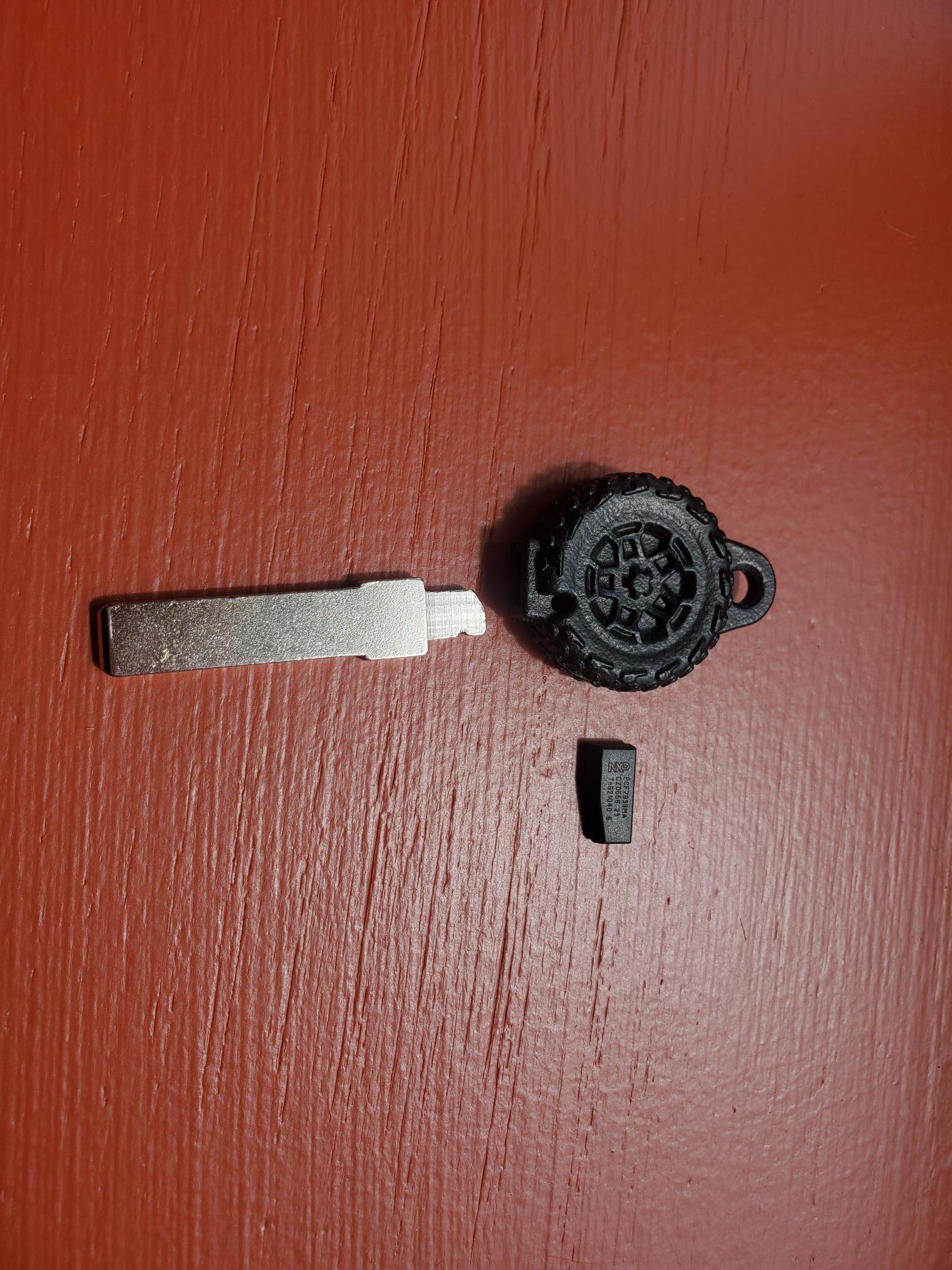

You'll need the Threedom key holder with RFID pocket. Pics above. Looks like removing the RFID can be a pain, so watch their videos. You lose or damage that thing you're out the cost for a $350 fob programmed by the dealer.
If you want to test, remove the battery from your fob. Touch the fob to the start button and press it.
