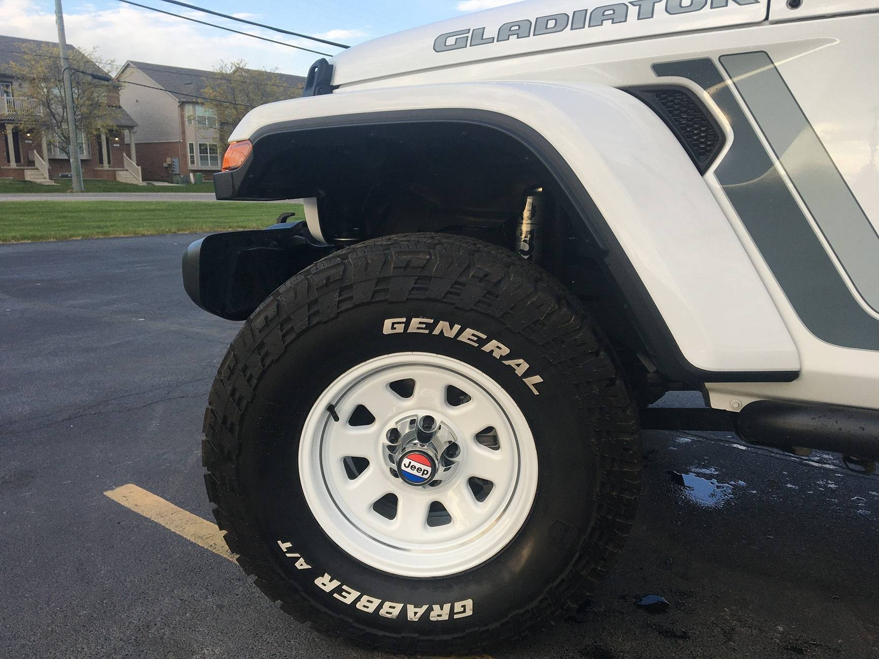

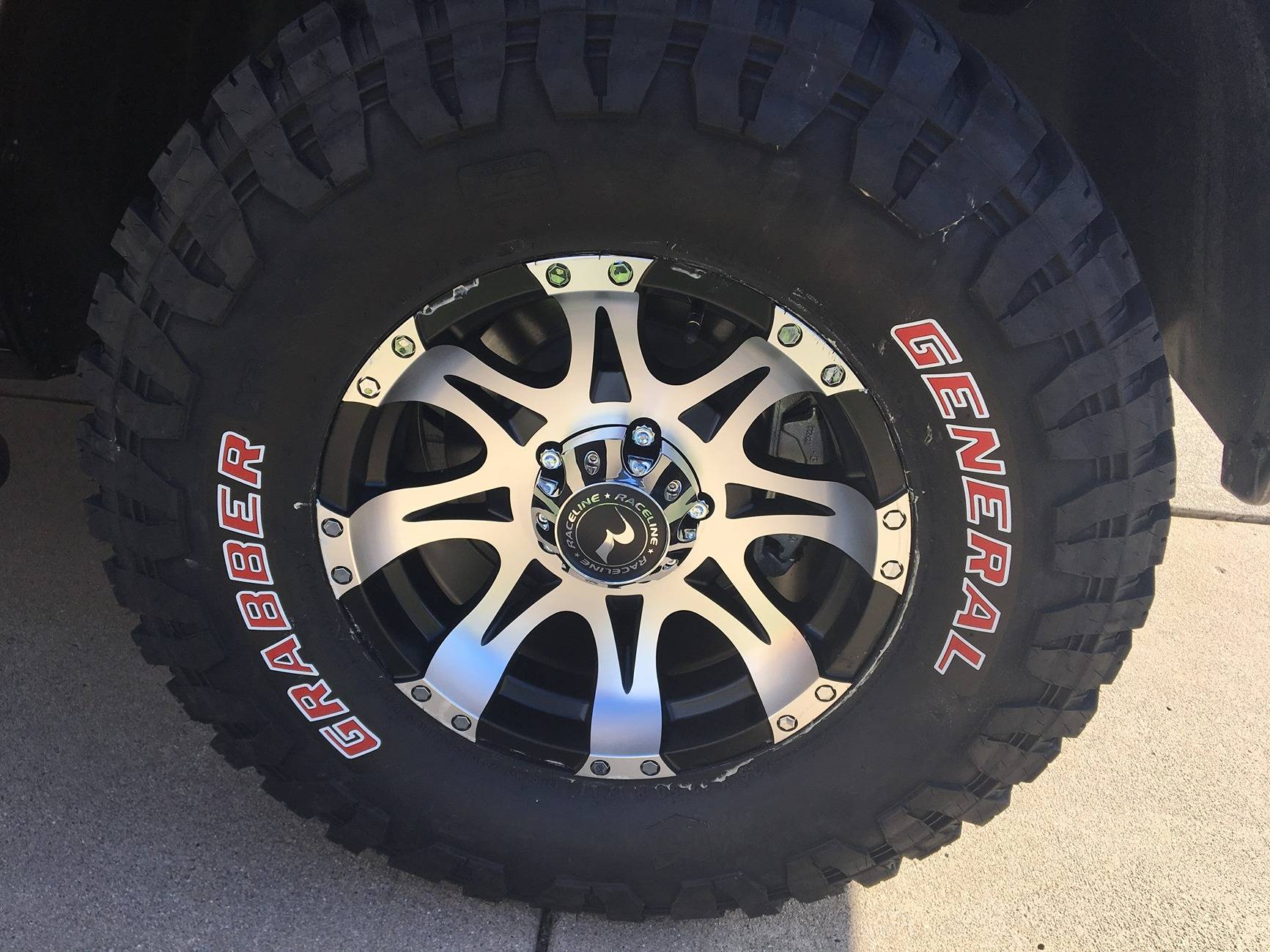

I had Gen. AT/Xs in 37s years ago and they worked very well, not great, but very well. I put over 30k on them in 6 months in everything from highway, to snow, to light rock crawling as we crossed the country 4x with them.
They wore as "perfect" as I could have ever wanted (almost zero feathering).
Where they lacked most was on rock only, at 20 psi, they were hard to hook up. That's Ok, it was a small give for all of the other takes (weight, wear, quietness, etc). And considering I don't live in a place of rock crawling, I was happy.
I'd buy them again if they still made them.
