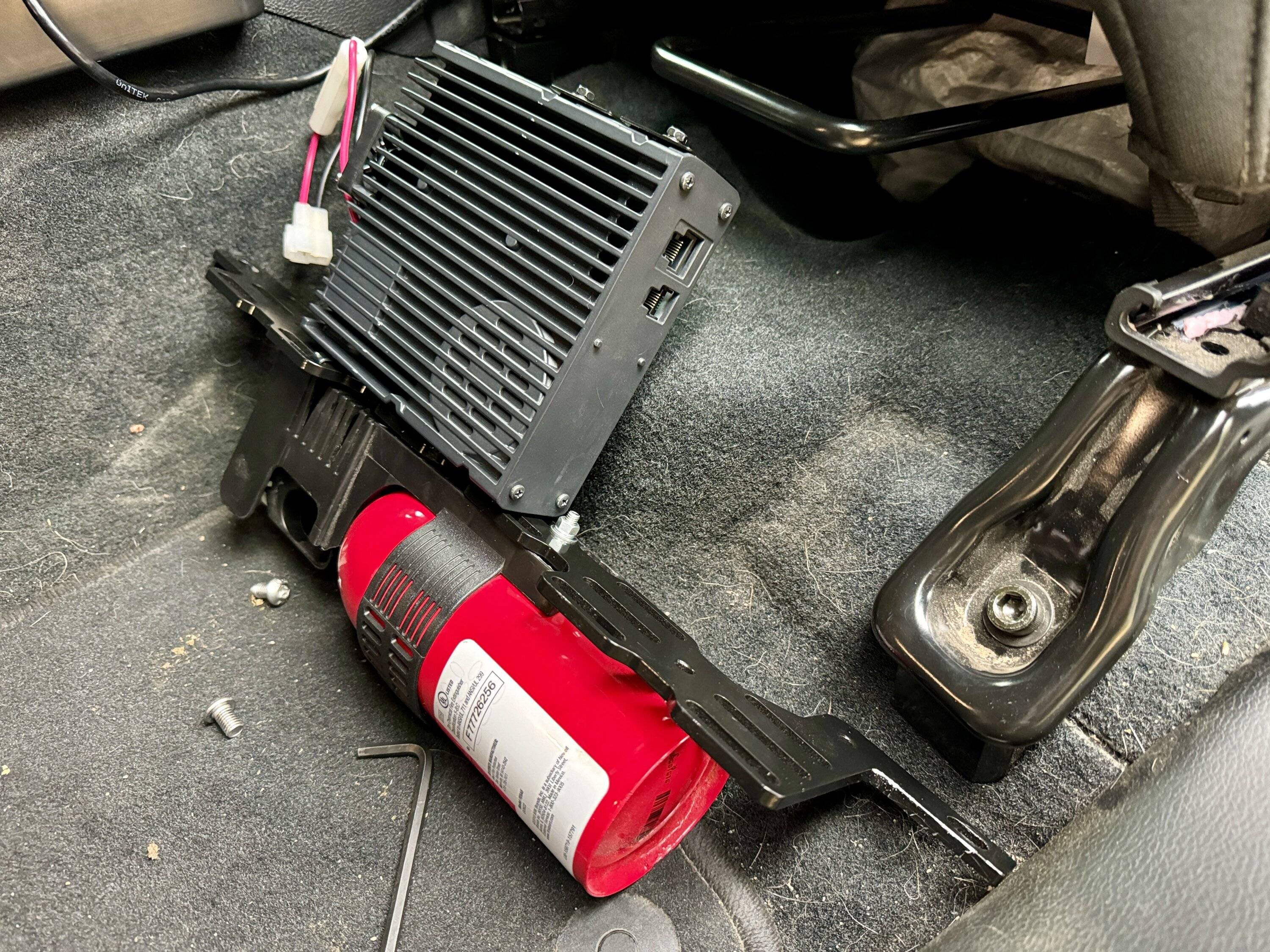

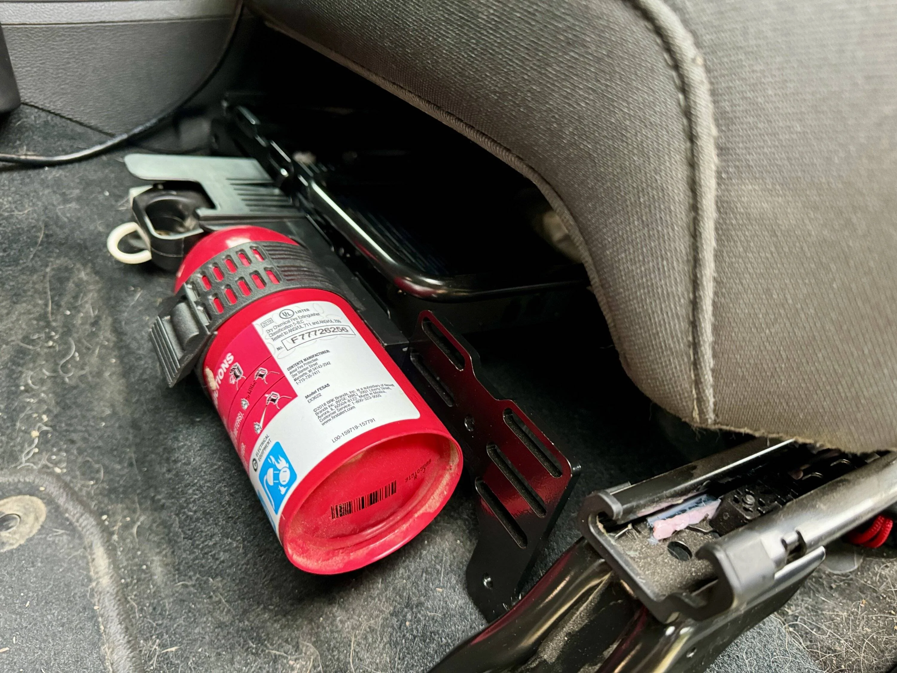

I'm installing a VHF/UHF radio under the driver's seat, but all the wiring I need (coax, power from an AUX circuit, mic extension) is on the passenger side. Not going to install on the psg side as the space is taken up by my under-seat air compressor. Plus I have a driver-side seat jacker and MOLLE plate, which makes for a super easy and solid install there.
Any tips on getting wiring to pass under the center console? Seems like there are no moving parts under there to cause problems, just the parking brake cable housing. I was thinking of undoing the front seat bolts, loosening the rear ones, tilting the seats into the back seat, then see if I can fish a coathanger thru
Pics of the mounting setup:
Jeep Gladiator Tips on getting wiring under center console? IMG_2702
Jeep Gladiator Tips on getting wiring under center console? IMG_2701
