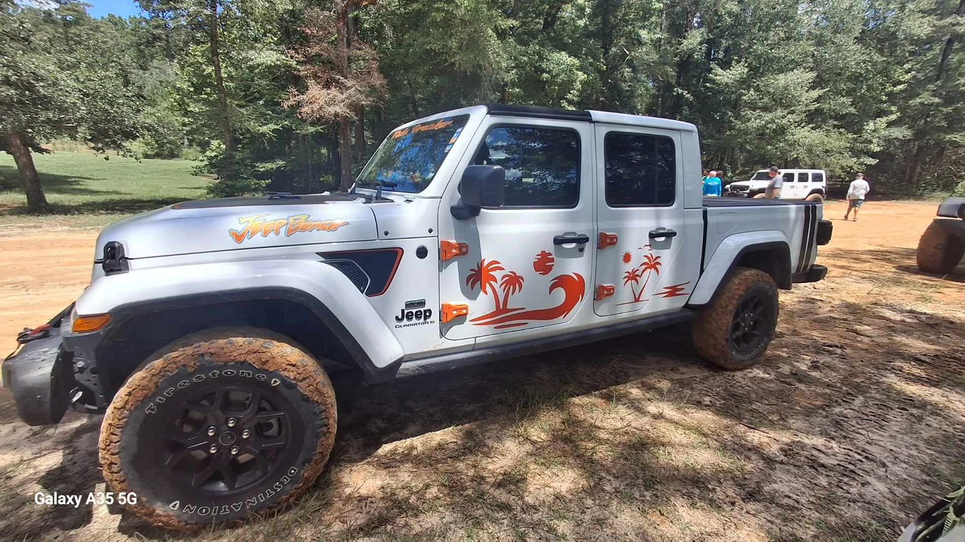

Wanting to replace my tires with a larger size but was told they will rub! I have 255 75R17 firestone destinations original tires on a 2024 gladiator jeep beach addition. What size can be installed? It does have a leveling kit.

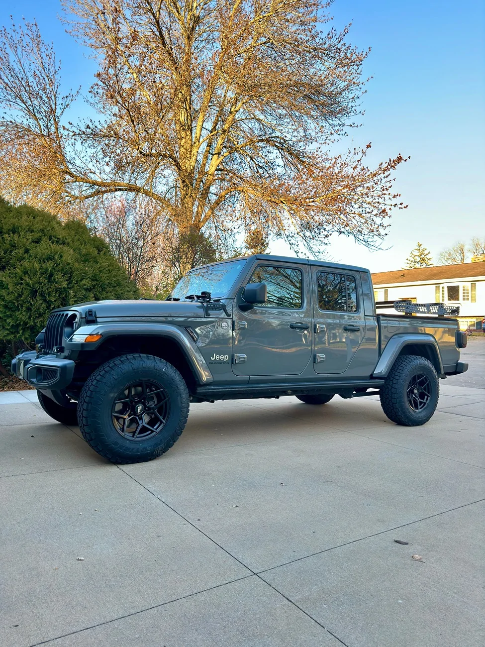

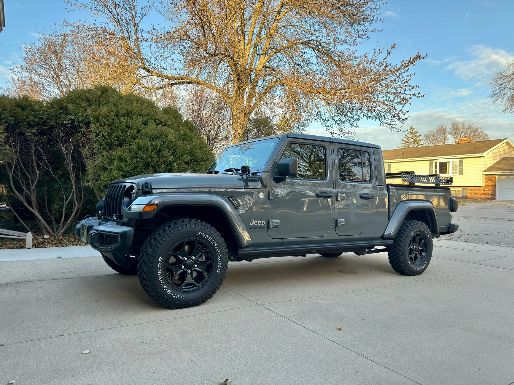

I literally almost did the same thing except my tires are 34s (285/75r17) with my +12 Rocktrix wheels. I added rubicon shocks and springs and a level kit. I do have a Rocktrix code if anyone needs it
