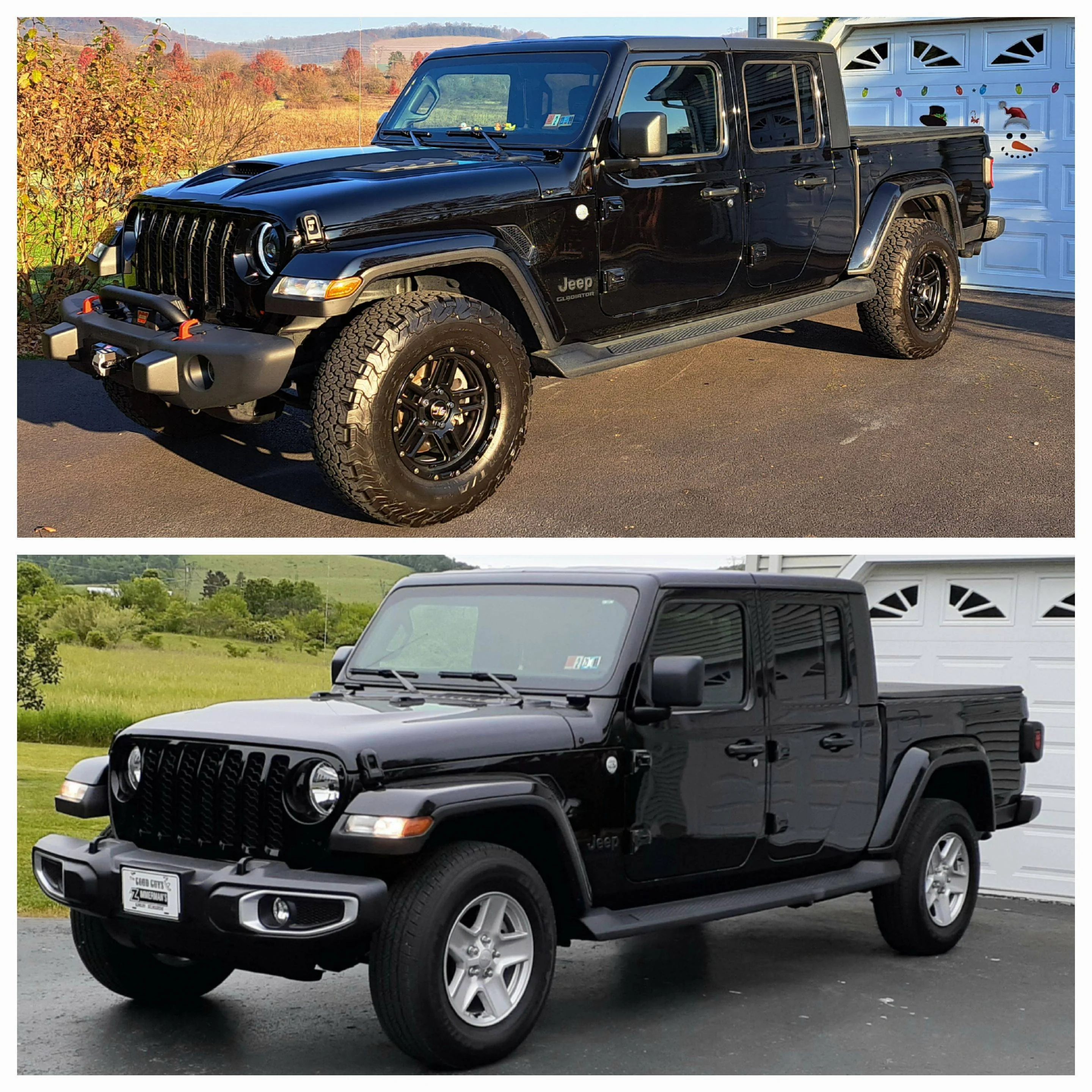

I went with 285-70-17's BFG KO2's
and a 1 inch Teraflex spacer to bring the front end up a little after adding a steel bumper, winch plate, skid plate and winch.
Nice transformation! Rig looks awesome! Thanks for sharing.
