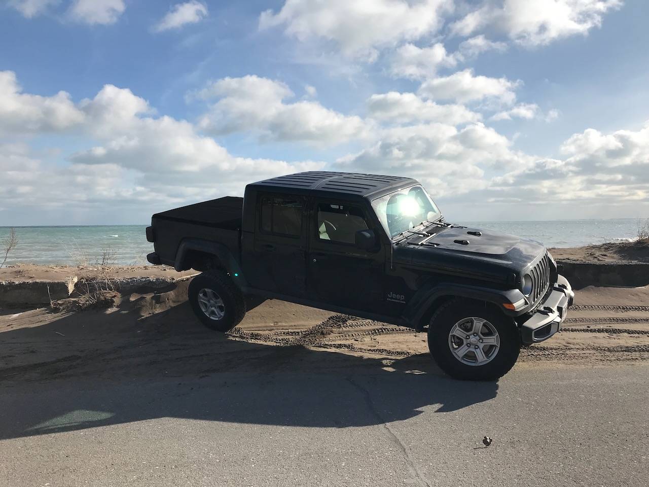

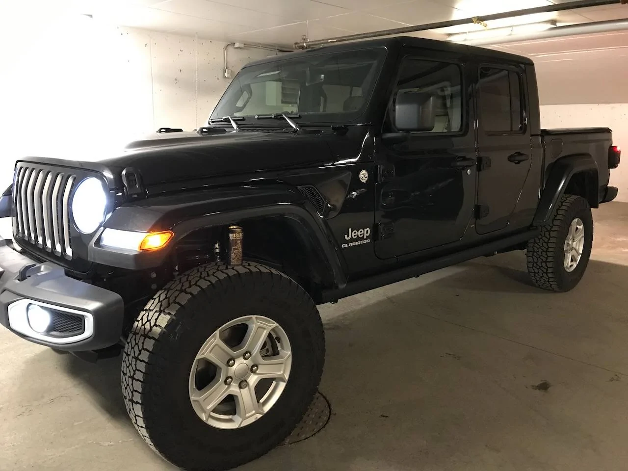

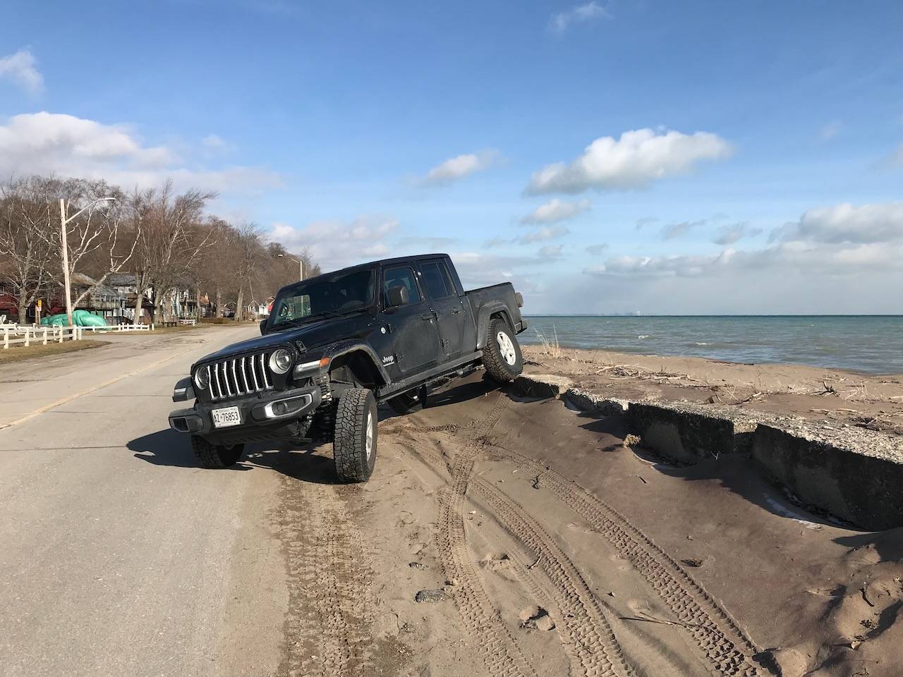

Bjeepz
B
Nov 21, 2019
1,009
1,062
Canada
2025 Willy's
I ran 285/75r17 on my Overland with the JKS lift and stock sport wheels. Lots of room, no rubbing anywhere when disconnected up front, I did have 2 inch bump stop extensions. Very nice middle ground between the 33 and 35.

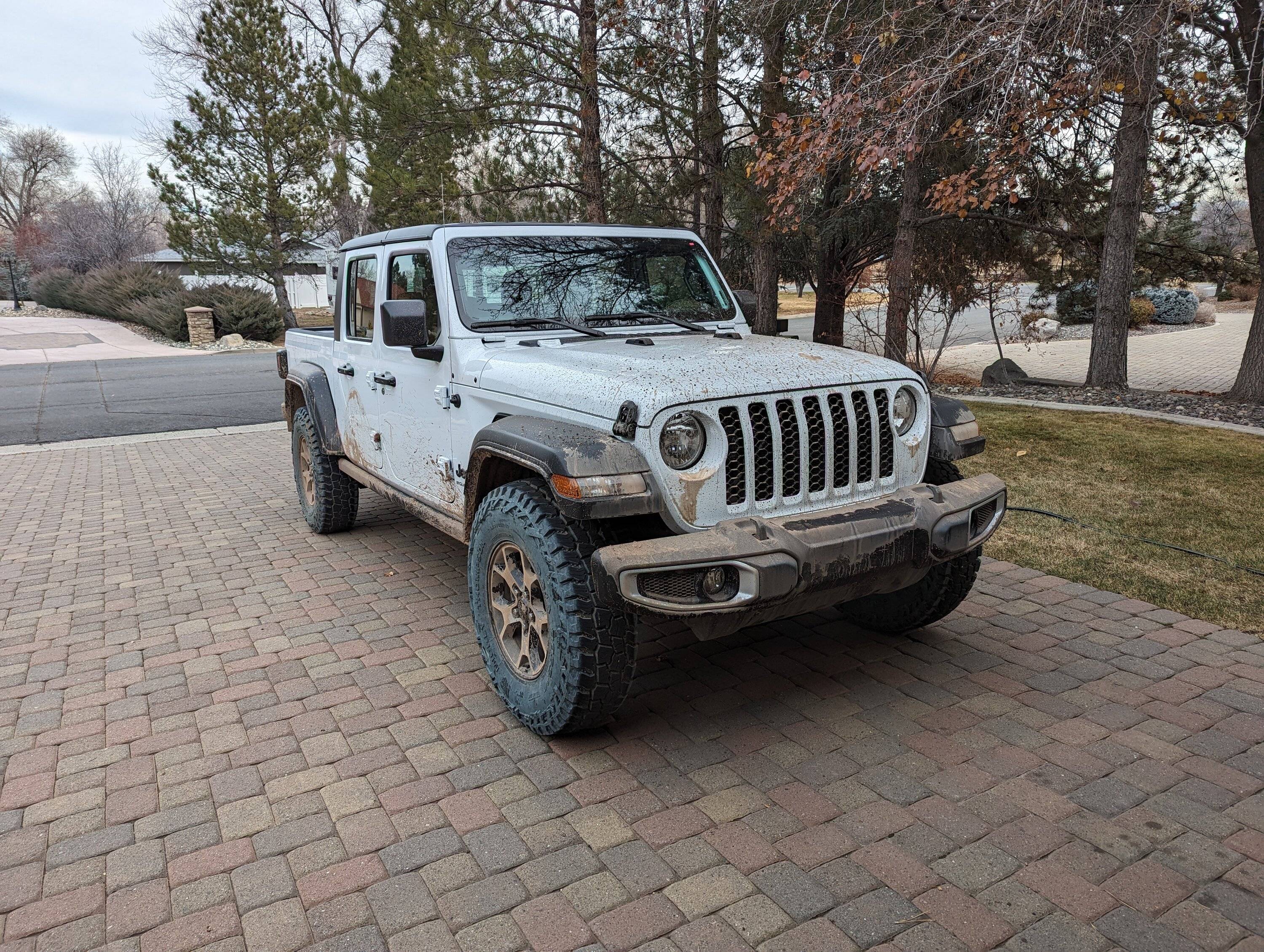

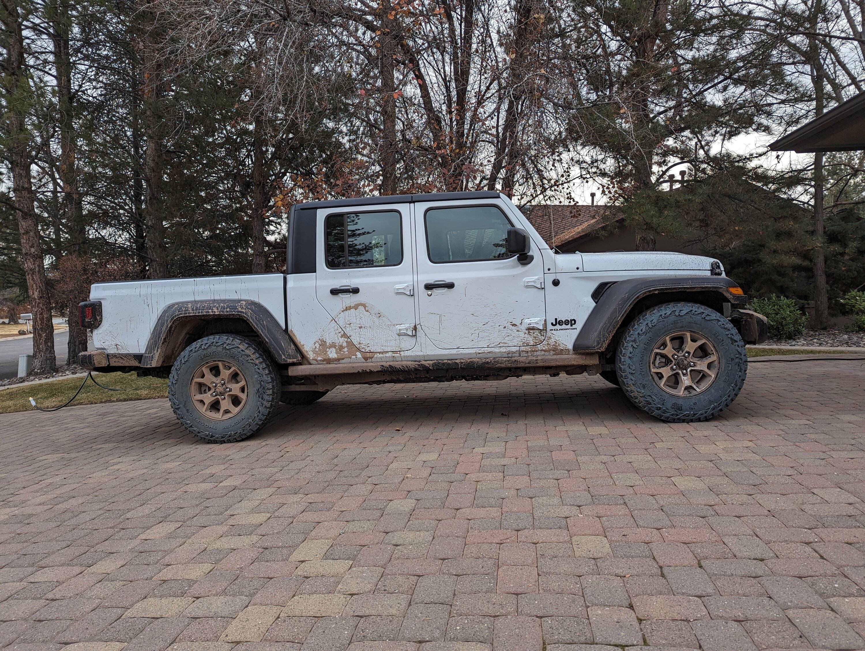

I just put M/T Baja Boss A/T LT255/85R17 (35x10.00R17) on my unlifted Sport Max Tow on take-off JLR rims. The manufacturer's stated diameter and tread width are accurate and they raised the differentials about 1.75" at 45psi over the stock 245/75R17 Duellers at 36psi.
So far I'm very happy with them. They are load range E but even at 45psi the ride is acceptable to me. They might produce a little more road noise than the stock tires but not much. If I wanted a cushy ride I'd drive something else. Tread width is 8.6", not all that much narrower than the 9.2" found on some 35x12.50s and a good deal wider than the stock Dueller's 7".
I haven't seen any rubbing yet. They might rub the outer lip of the front Sport Max Tow fenders if the bump stop compresses an inch or so, then the fender liner if it compresses much further. There's plenty of clearance in other directions.
