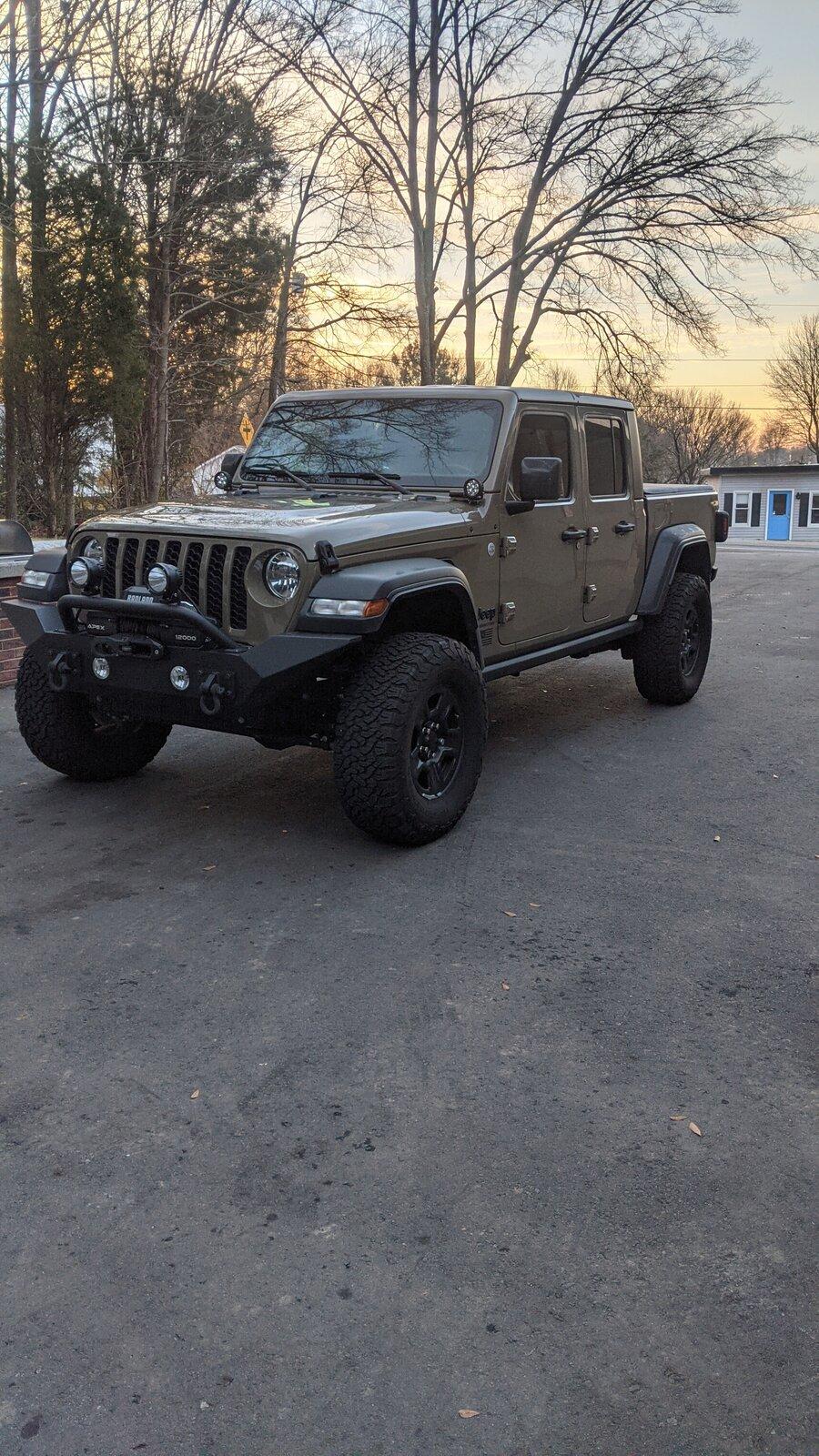

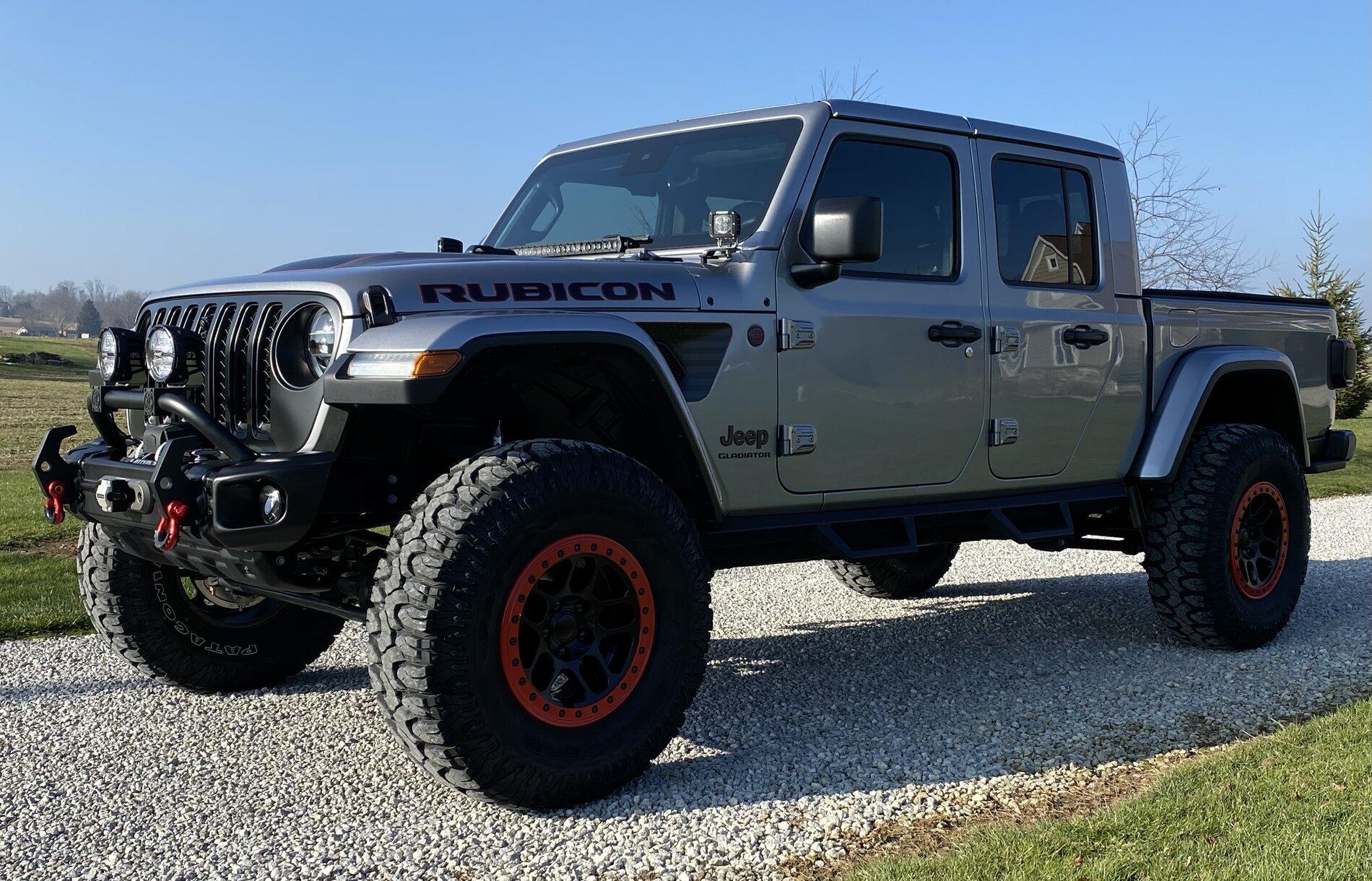

You could definitely not a 38. I went and looked at a set of 39 12.5 17 Kanati mud hogs I was considering that had 1000 miles on them. The guy wanted $800 for them but told me he would come down to $600 when I got there and we were talking. They would of fit on mine with the ReadyLift 2.5" sst lift kit and the Rubicon take-off suspension I got on mine based on me rolling them up and looking at them beside mine. The 90lbs a piece and them looking extremely Rugged was why I passed but they would of looked great on my JT. Mine looks like this currently

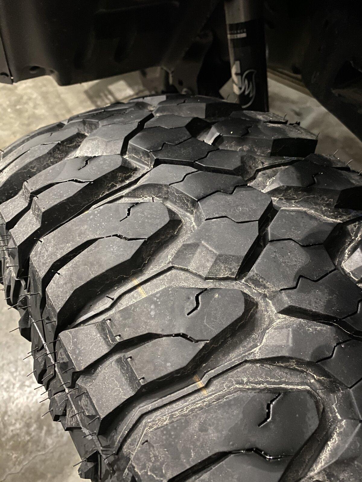

I just went out and looked, they are probably 36.1 to 36.2”. It’s over 36 but not a lot....maybe I set the Tazer 36.1x, I don’t recall. Either way my Speedo is spot on with GPS.... it’s over 36 regardless.... Tread looks good with only 3500 on them... You can see that feint yellow line, that is where you would want the “normal pressure” contact point to run, and with 35-37 lbs of air, it stays there pretty well. I’ve let them drop to 31 psi due to temp changes and you can start to hear the outer lugs when making turns on on ramps.
Yeah those tires look great. You got me all over the place now. Aggressive and nice ride on the road and 37, my wife's going to be like WTH!!! Lol!

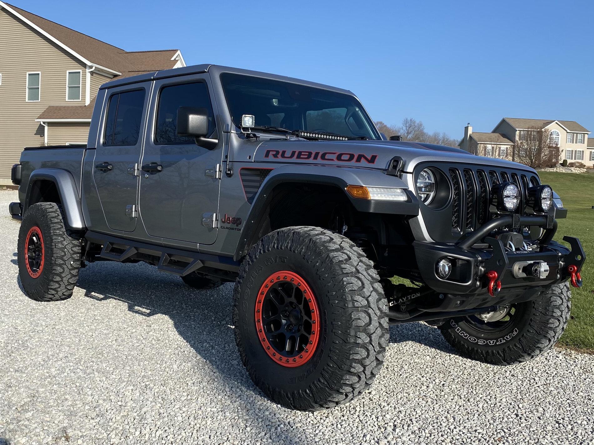

How wide are the tires... they look narrow in a couple pics... which is better for what I like to do...

They are supposed to be 37x12.5 but never actually measured them. When I get moving today I’ll Rey too get a good measurement with them on the Jeep. My guess is some of the other tires may squat a little due to design and running a little less air, which makes them appear wider. These are more of a crowned design too as mentioned before, so it runs on the center 3/4 or 2/3 of the tire for DD driving so they will appear narrower.

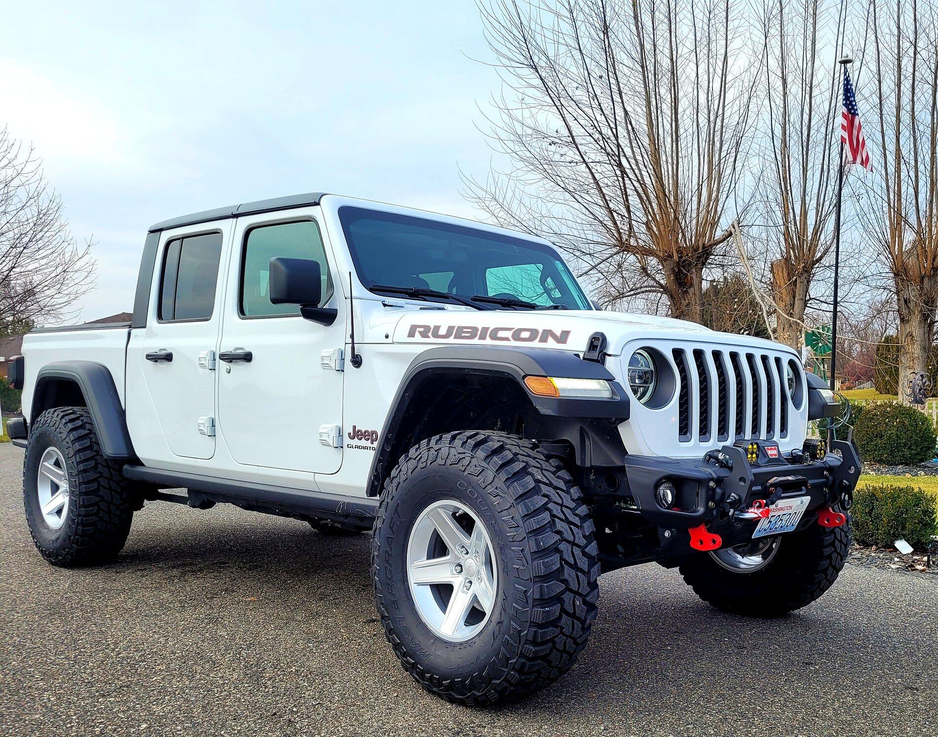

I had the 35" Patagonias on the Gladiator until just recently. To be honest, I bought them due to price for my previous JK and didn't really know a lot about them. I was surprised on how quiet they were and their performance off road. I ran them for well over a year on the JK before I put them on the new JTR. Ran them for another 4700 miles on the JTR before selling them to a buddy. I was very happy with the tread life. Well over 85% left. For some reason, they were much louder on the JT than the JK. My buddy also commented that "these tires are loud!" Didn't really bother me. They were still quieter than a lot of tires I've run on my Jeeps: MTR's, Toyo MT, ProComp Xtreme MT.
When switching to 37's, weight was a big factor for me also. I really wanted Nitto Ridge Grapplers, but just couldn't get over their weight. Spendy too. I was all set to get the 37" Patagonias when my buddy told me about the Mastercraft Courser MXT. Same low price as the Pats, but weighed 69 lbs each. They are made by Cooper Tire here in the USA. I kind of wish they made their CXT hybrid in a 37", but they don't. I decided to give them a try. So far I like them on road and in the snow. They are very quiet, but noise doesn't really bother me.
For you sticking with an A/T tire, my opinion is the Jeep Gladiator needs a somewhat aggressive looking tire. I am sure the Coopers are a good tire, but they look like they should be on a Buick! The BFG is a great looking tire. But, here in the PNW, the BFG AT didn't work out very good for me off road on my TJ years ago. The tread clogged up with everything I ran over. Great tires otherwise.
Good luck on choosing! So fun!
