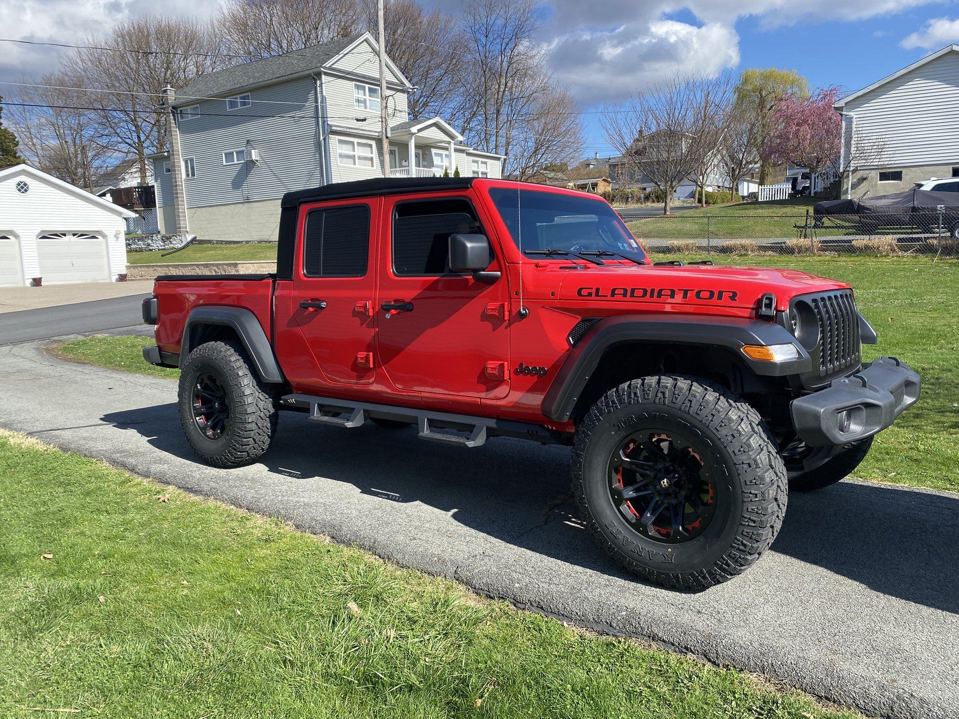

I went with 37x12.5x18 Kanati Trail Hogs. They weigh roughly 70 lbs vs 63 lbs on the 35s Courser MXT they replaced. Didn’t lose any bit of pep from the 35s, and actually ride smoother than the coursers. I do have a Tazer programmed to the 37s and also have a pedal commander. I’m running the trail hogs around 33 psi. Knowing what I know now, would have gone 37s from day 1. Oh and I have Sport S with 3.73s.
