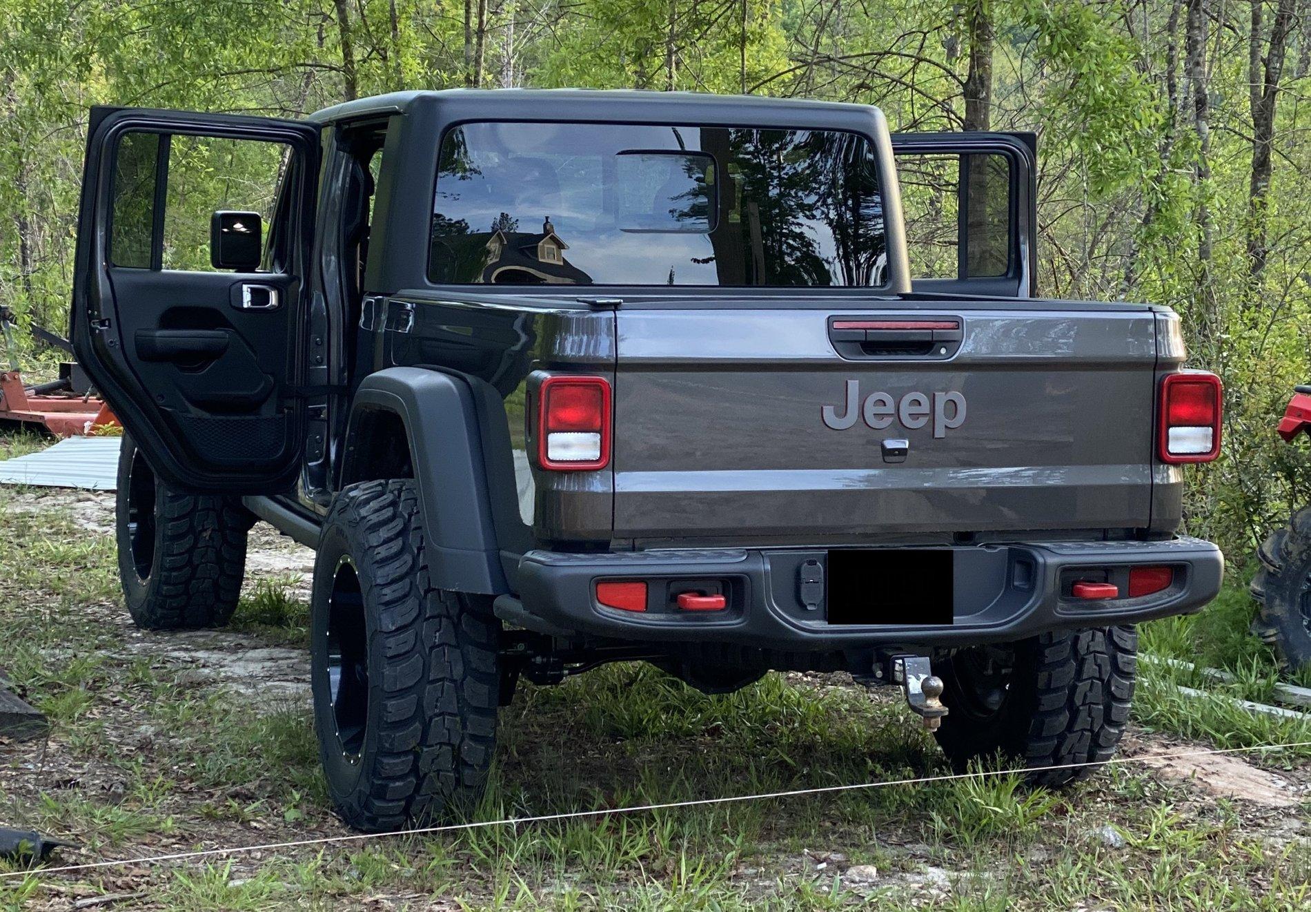

Finally got off work early enough today to get my 37x13.50’s and 20x10’s mounted and balanced. :like:
Jeep Gladiator Tire Weight & Performance 0BFD28A9-E2E2-4BDE-B881-D361FEA38305
Jeep Gladiator Tire Weight & Performance C0A898B1-1C6F-46F8-A469-5026AD4EEFA5
Jeep Gladiator Tire Weight & Performance IMG_1090
