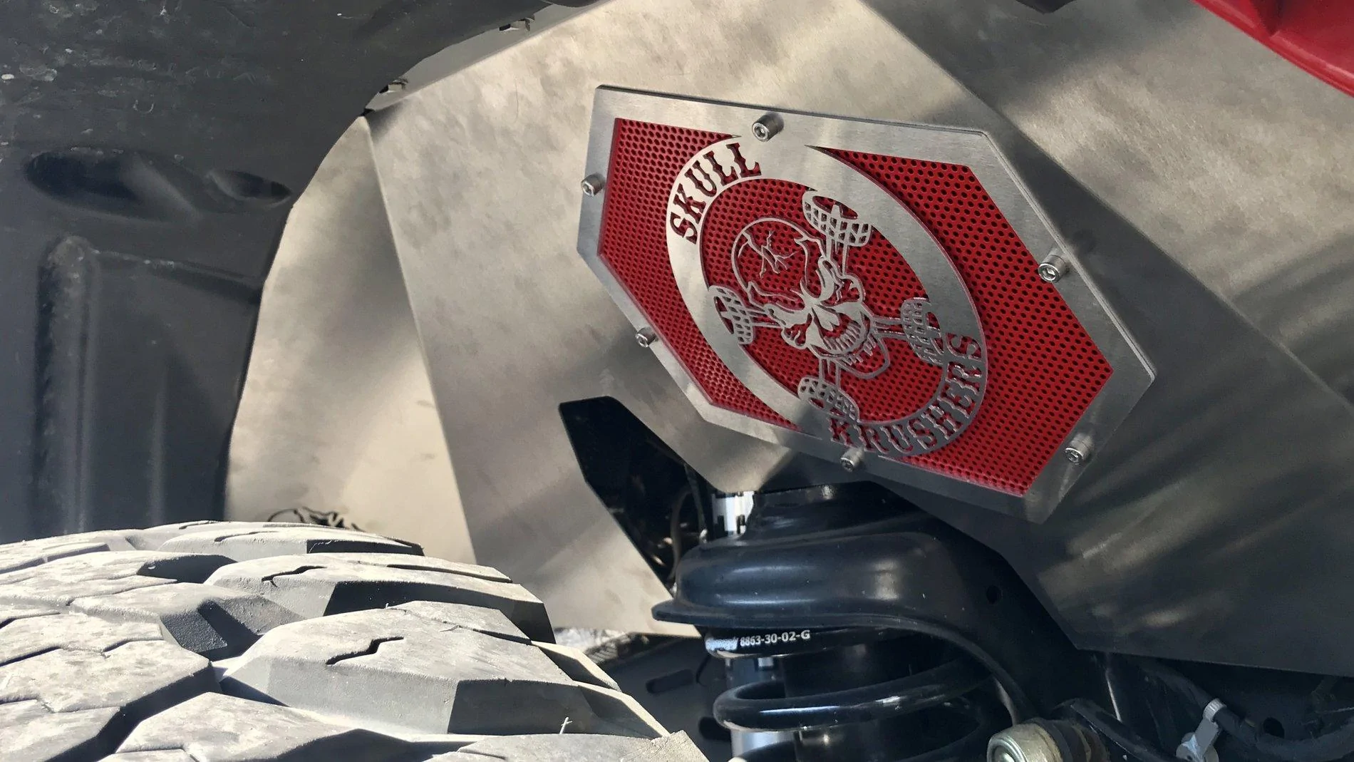

I was sent some prototype JT inner fenders from Skull Krusher's. This video covers the install process as well as modifying the factory plastic liners to cover the gaps that the new ones don't cover.

Looks great! I really like how you cut the oem fender liners, good work
Thank you, I was surprised with how well cutting the factory liner worked actually. Definitely worth the extra time.
Hey what brand is that nutsert? Do you have a link? Nice install video btw. Although, I would have liked it if the aluminum insert covered the whole area of the previous fender liner .. unless that is by design to allow for shorter fenders? But, if wiring is exposed I would think that is a risk... You obviously did a great job by leaving part of the plastic orig fender liner but Idk if I am capable of doing that LOL
I do not have a link to the Nutsert tool. My father bought it a long time ago. I will definitely ask him what brand it is.
Thank you for the kind words. So these inner fenders are designed mainly for people replacing the factory plastic fenders with metal tube fenders or something like you would find from Metal Cloak. I haven’t seen a metal replacement that replaces every part of the factory liner, at least not for the front.
You could totally do this install yourself! Just take your time, my video should help you through the whole thing. You saw exactly where I cut the factory plastic you could trace it out like I did and do the same thing.

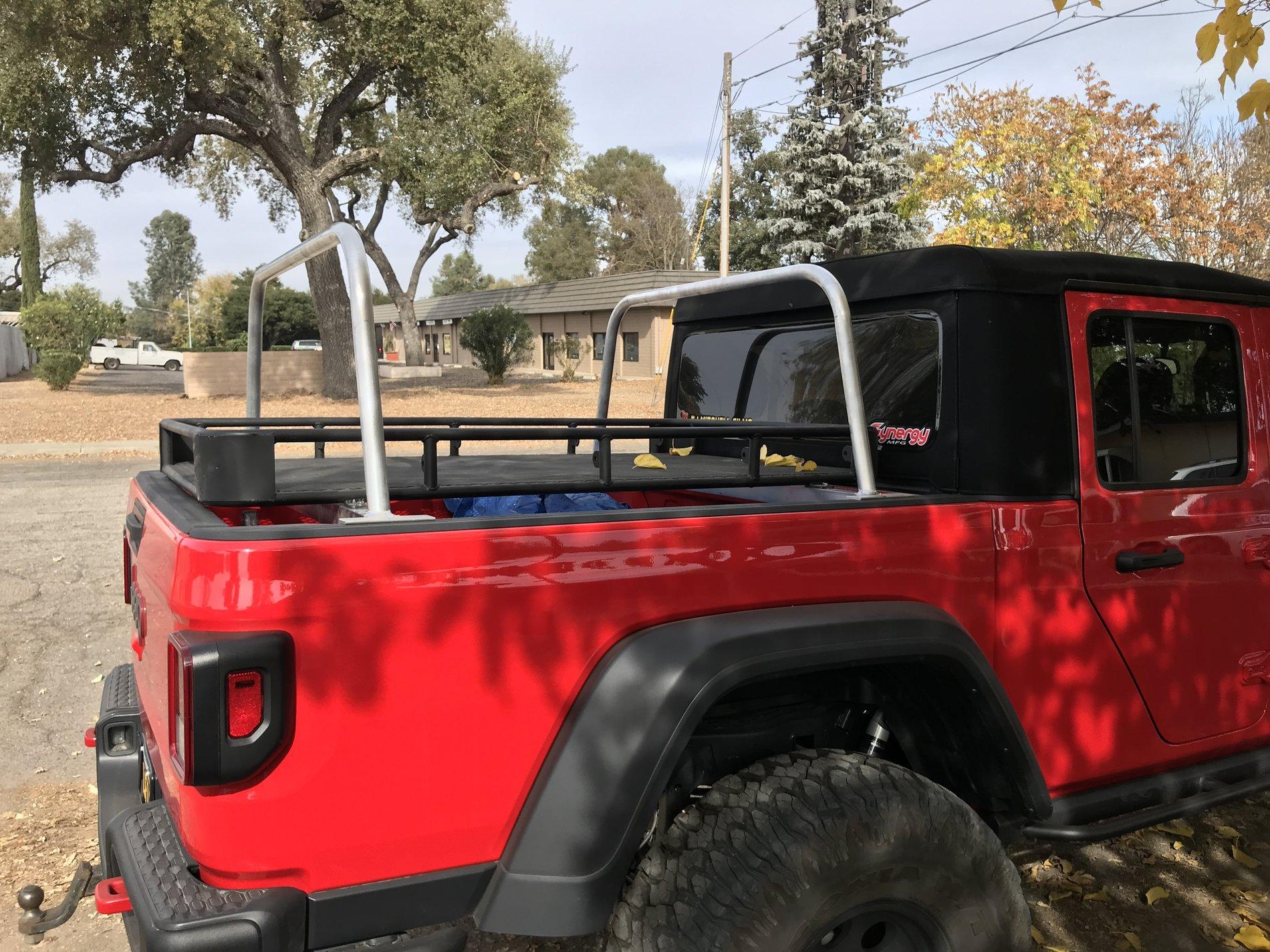

I have been working on my own bed rack out of 2” .120 square tube, 1.5” .120 round tube, and some 1x2” .120. All aluminum so super light.
I will try to get some pictures of the progress tomorrow and as always video to follow.

<looksatcalendar>
I will be connecting the round tube with some 1”x2” to give rigidity and side mounting options. Sort of a 3 tier system with the roof top tent going up top, the rack in the middle, and of course the bed underneath.
