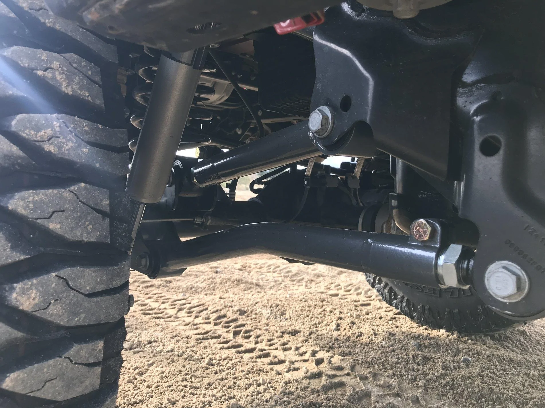

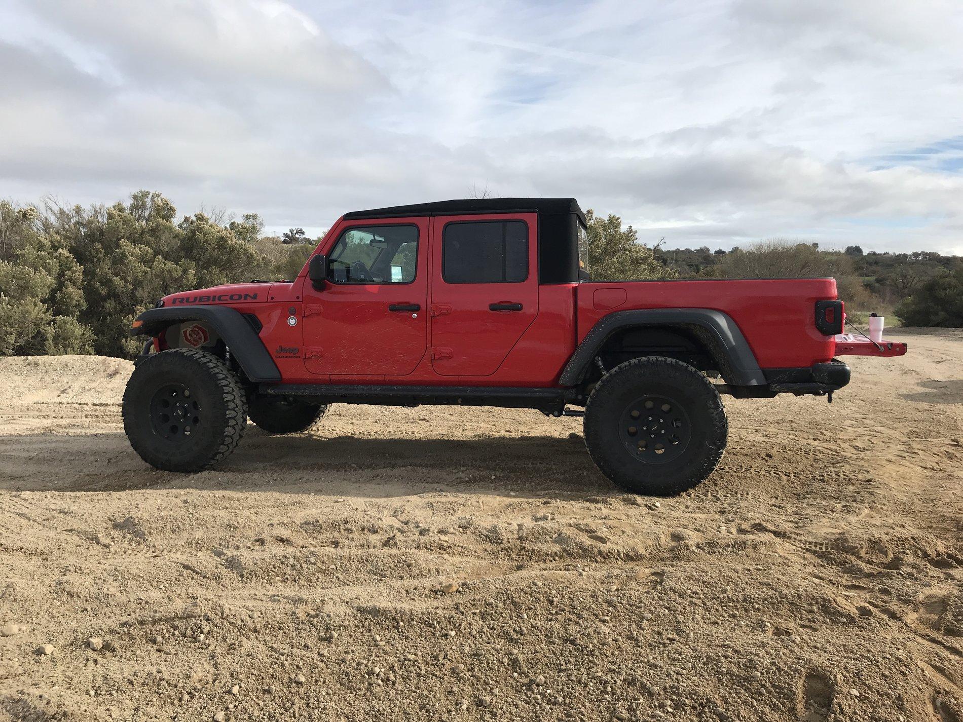

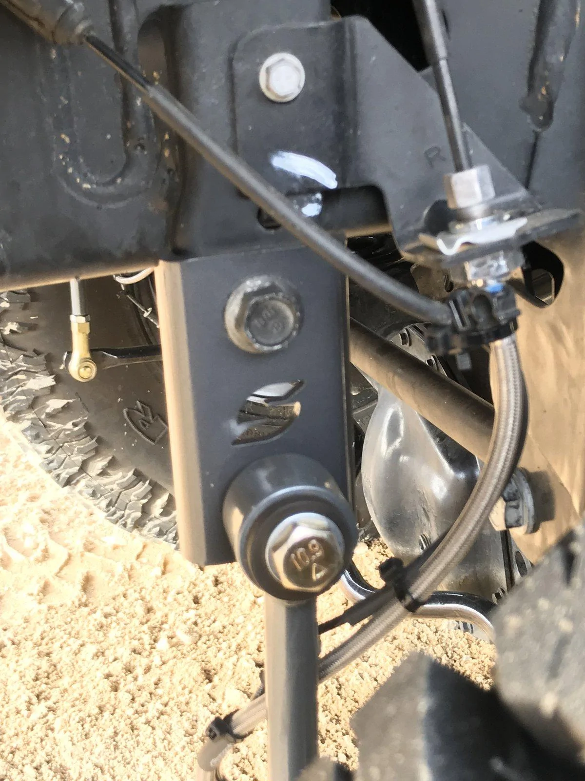

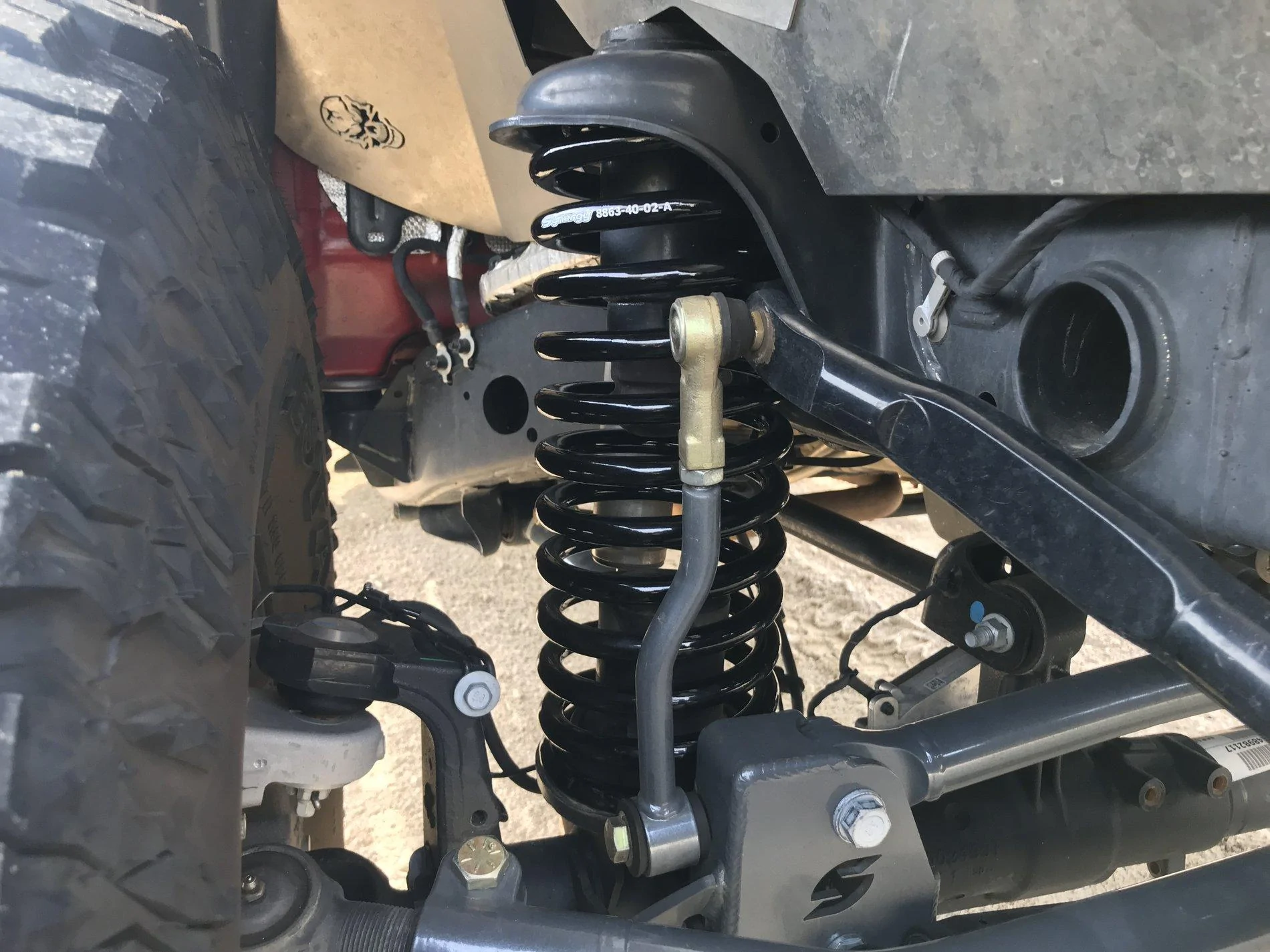

Up front new 4” Synergy springs. In the rear upper and lower control arms, as well as a sway bar link drop bracket.
The truck sits almost level now with the 4” springs in the front.
Are the rear lower control arms installed correctly? Should the adjustable end go to the axle?
They are installed correctly. They were made by Synergy MFG and installed by them at their shop. Their front control arms are the same way.
Also you do not want the adjuster down by the axle, it could get damaged from rocks or possibly even start to turn (it might take an awfully hard hit for this to happen).

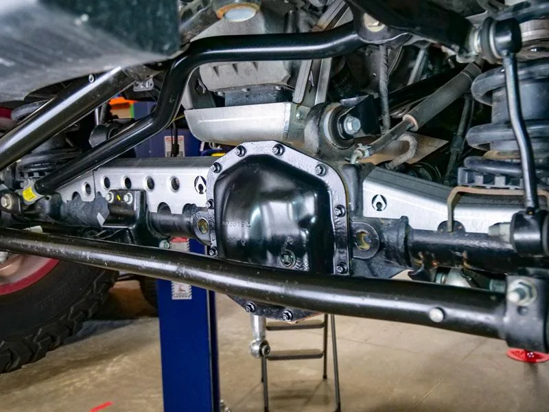

I can't wait to hear about your results from this upgrade. Also removing the OEM axle shafts for a non-FAD one piece shaft?
I won’t be upgrading axle shafts for a while unfortunately unless I come across a very good deal.
Also, I notice the FAD skid,but if it deletes, what is the skids point?
Ya I think if you do a one piece shaft the skid would sort of be irrelevant. Unless the housing is weak and you want to protect it from being hit. I’m uncertain exactly

Me thinks long term - a DYNATRAC Pro-Rock 44 is the best option. However, the Artec housing truss solves several short term needs and is cost effective.
Yeah that’s probably true. If I’m doing an axle swap I’m going to do one tons and go to 40” tires. That would be way down the road though.
