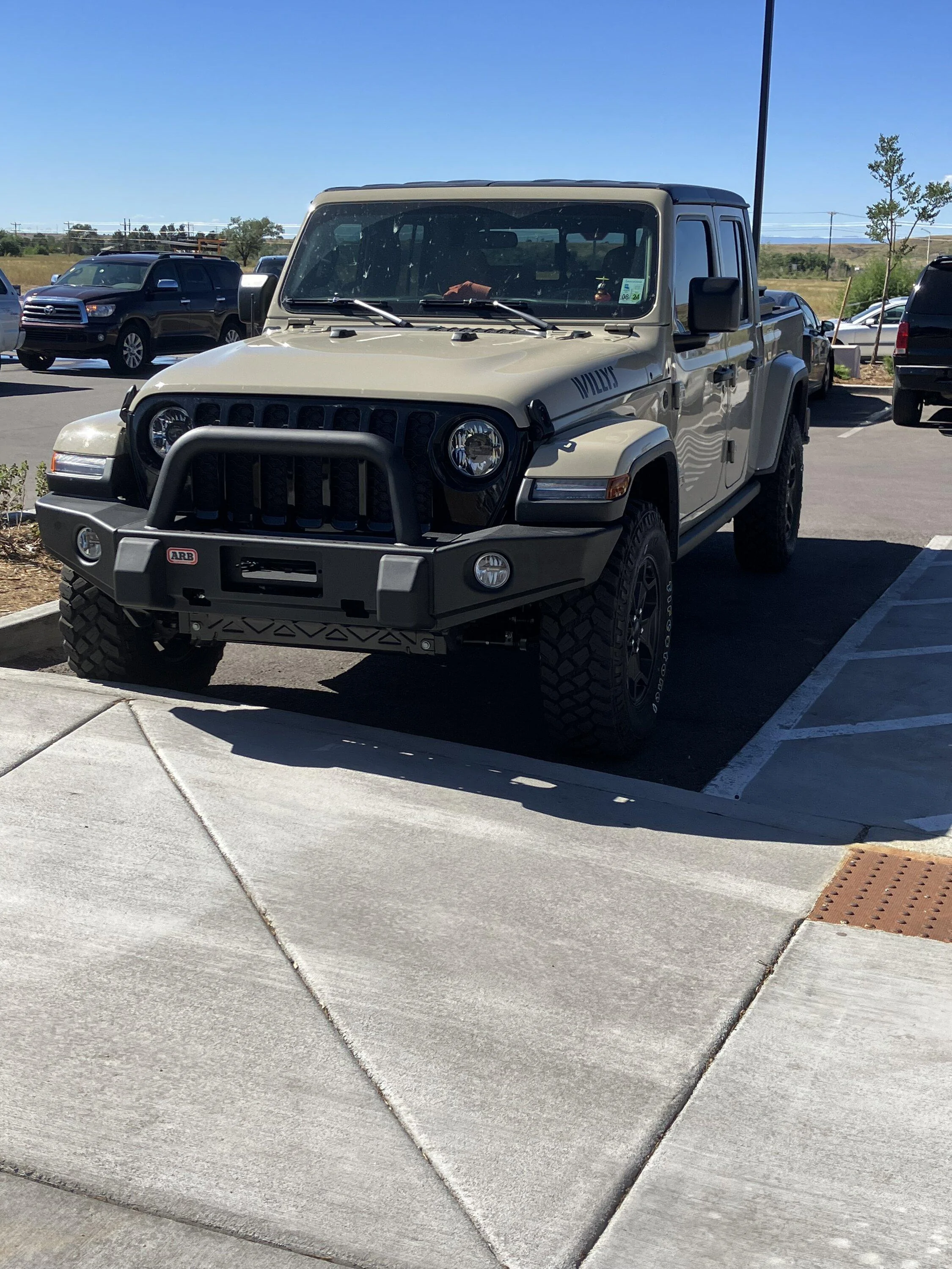

Here's a little update w/ photo. I'll echo what I have read about the piss poor instructions included with ARB bumper. It took me around 5-6 hours total to remove the factory bumper and install this one. I've got a ton of leftover bolts/self tapping screws that I have no clue what to do with. That said, there are a bunch of add-on bits that did not come with this bumper, so maybe they go to them in part?
After mounting it up, this thing is SOLD. 8x M12 bolts to the frame horns along with 2x M12 bolts plus spacers to the sides of the winch plate mount connected to the frame. It was a bear to get in position but I was able to do it all myself without too much difficulty using my floor jack as a second set of hands.
I does NOT come with the cover plate for the winch mounting area. I have no plans to add a winch at this time, but if i cannot source the cover that may change since the fog light wiring is exposed in the "hole" and the big empty space just bothers me.
There was about 1/2 inch of suspension sag after adding it, and you can definitely feel the added weight up front with regards to handling and suspension compression with bumps/dips. That said I would 100% do it again. I think this bumper looks best with the factory flares rather than aftermarket though, so take that into consideration if you are looking at this bumper.

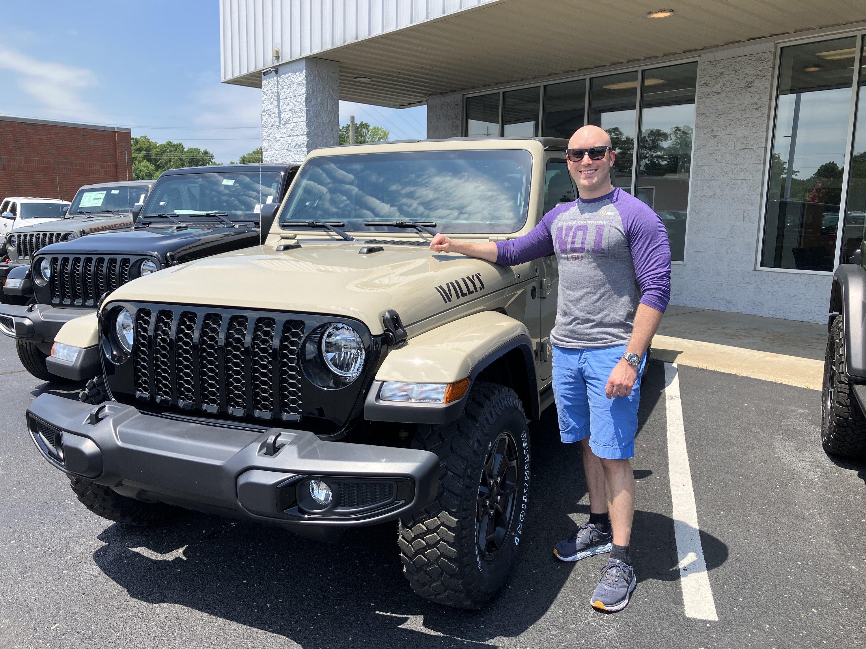

little before and after photo action...
