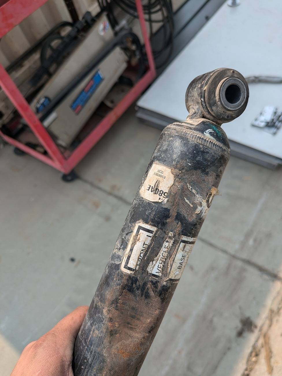

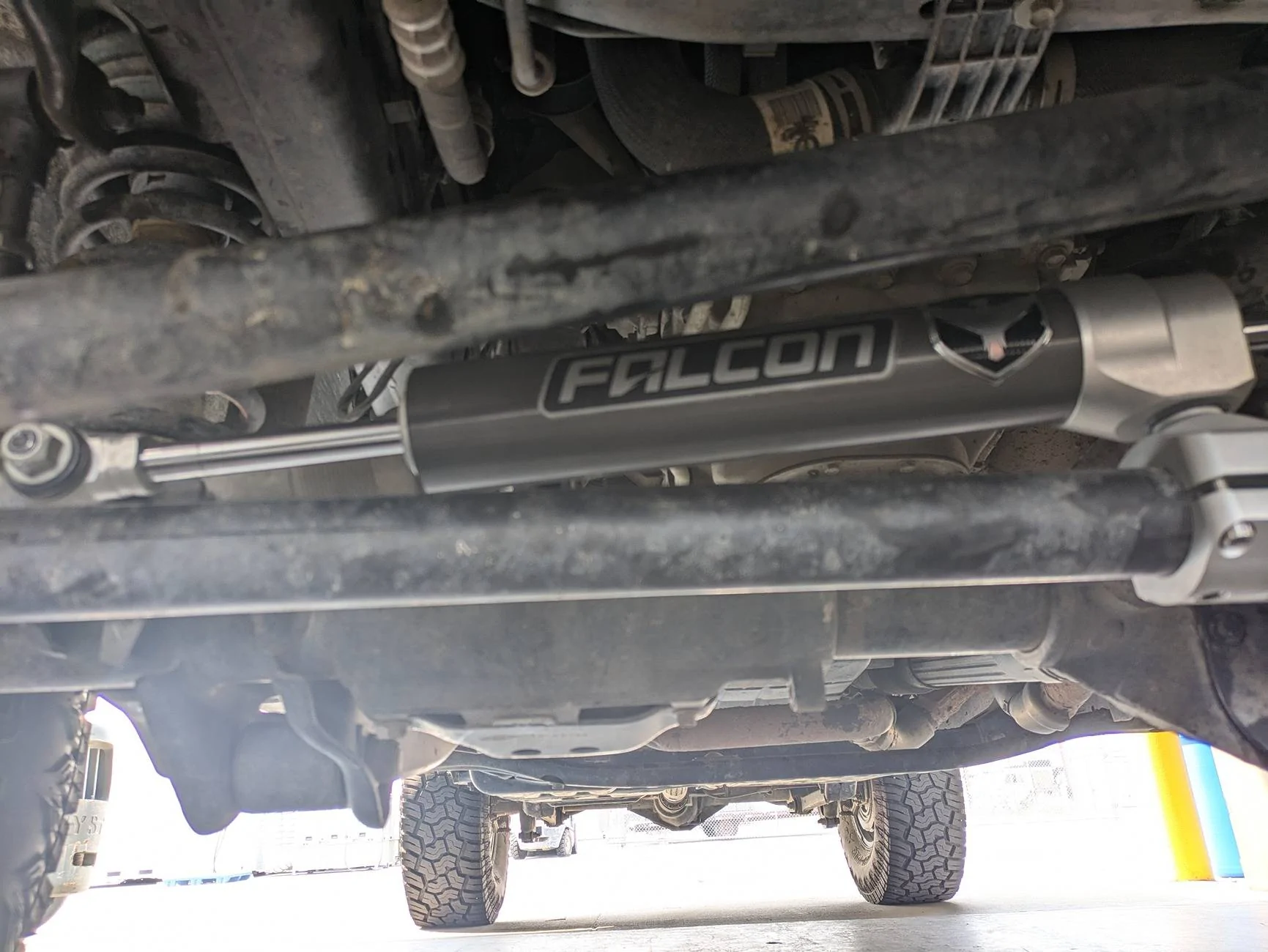

New to the jeep world. When mounting a new steering stabilizer is it better to stock mount it or mount it on the tie rod? TIA for the feedback
Having destroyed a stabilizer on the trail, I'd say relocating it to the top of the tie rod is worth it if you're going to put money into a nice one.

Any stabilizer relocation brackets which work with a stock suspension? Most seem to say they want a lift first.
