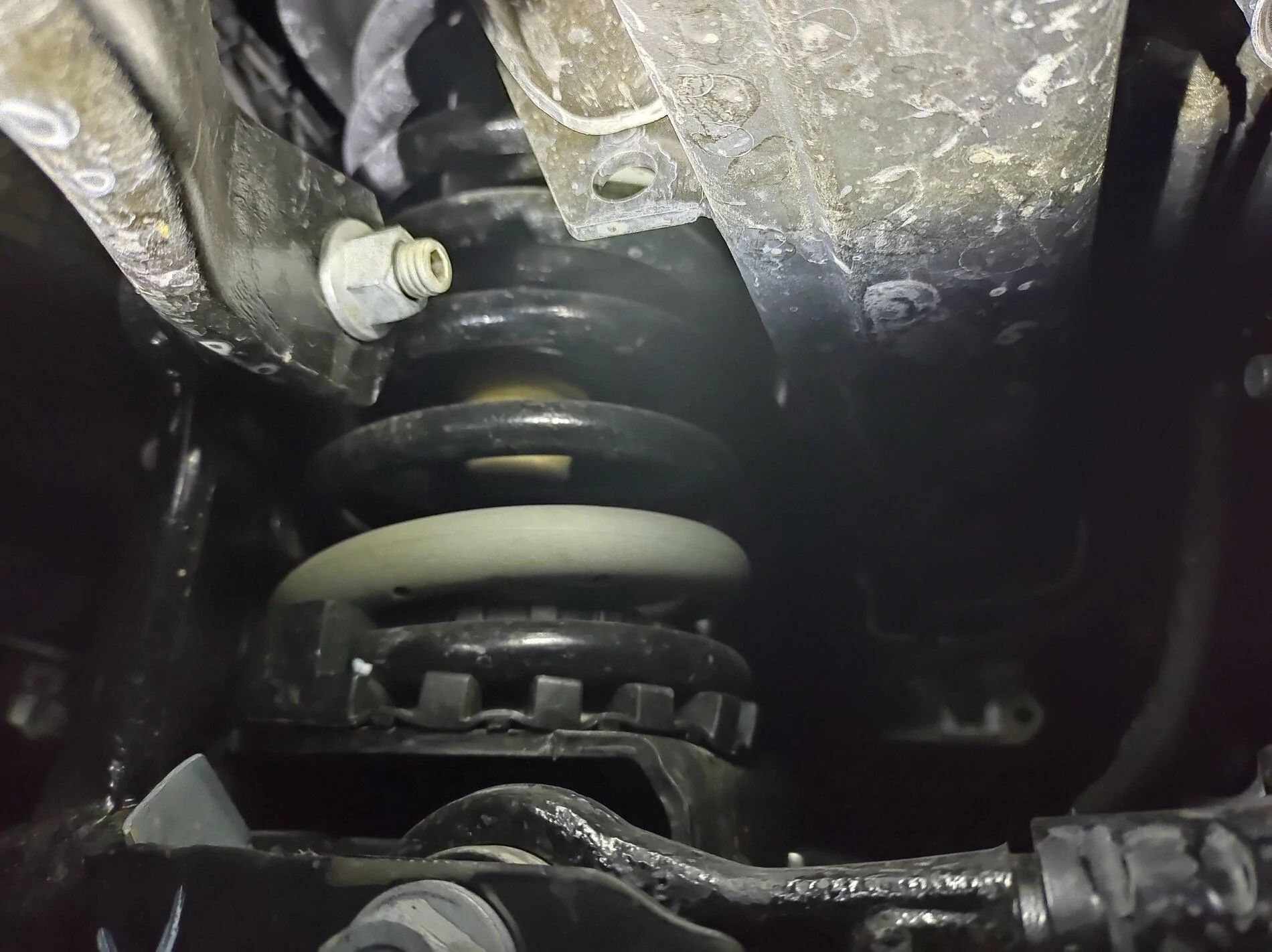

I drove up no appointment. They got me in took a look tried to get a thread chaser on it. Couldn't get it rethreaded. Put a nut on as far as they could ordered the part said it should be a couple days. I think that is the difference between a just soso service advisor and a great one.

Went on a little jaunt up in the mountains Sunday. Heard a clunking somewhere between where I was and where I was going. Didn't make the sound driving down the road. Got home from work just now figured I'd look around. I think I found my issue. Missing a nut on I believe it's the sway bar linkage. Drivers side bottom picture. Passenger side top picture.
It's going to happen again even if you put a new nut, it's just over stretching the link and the nut stripping is kind of a fuse just a simple explanation. Just my opinion hope it helps. Next step get a Currie Rock Jock or Teraflex Trail Rate bar.
The nut is just a bandaid. Getting a new end link for it this week. Dealer installed. Hopefully Friday
