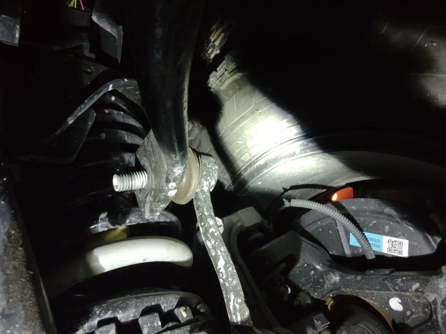

Add the caliper housing bolts to that. Mine fell off in the middle of the desert with zero cell coverage and and I literally had no choice but to keep going, it ended up gouging the hell out of the inside of my rim.
Not the first I’ve heard of this. After my incident, I crawled underneath and double checked all the exposed bolts I could get to underneath then marked them with a paint pen.

I'd go in to the dealer to make sure it was documented - if enough people see and report this through dealers, then people who aren't mechanically inclined may find a TSB at some point.
For me that's a 2 minute fix and I may even have the nut on hand - but it's the principal of the thing. And if no one bothers to report it - Jeep has no clue there's an issue and it gets ignored.
At least DOCUMENT IT and make sure the dealer knows about it.
40,501
54,021
Don't know about your dealer but here they would make me wait a week to get in then charge me for nut and labor.
I would replace it myself and not worry about it. Many of us change those links anyway, i have a drawer full of those nuts from various jeeps I've owned.
Not here - I'd drive up to their door at 6:45 am and be the first in line - and tell them to fix it while I went into their showroom and had coffee and donuts on their dime.
Yes, I could fix it, and yes I likely even have the parts (I've got thousands of nuts and bolts from 50 years of shop work) but I want Jeep to know about it, and the dealers to know about it. It does make a difference.
And I'm the sort I'll be right there in front of the door - they WILL Take care of it.

Well it's gonna take a new end link. Checking on parts availability. Couple days they say on the part. Should be fixed by Friday.
