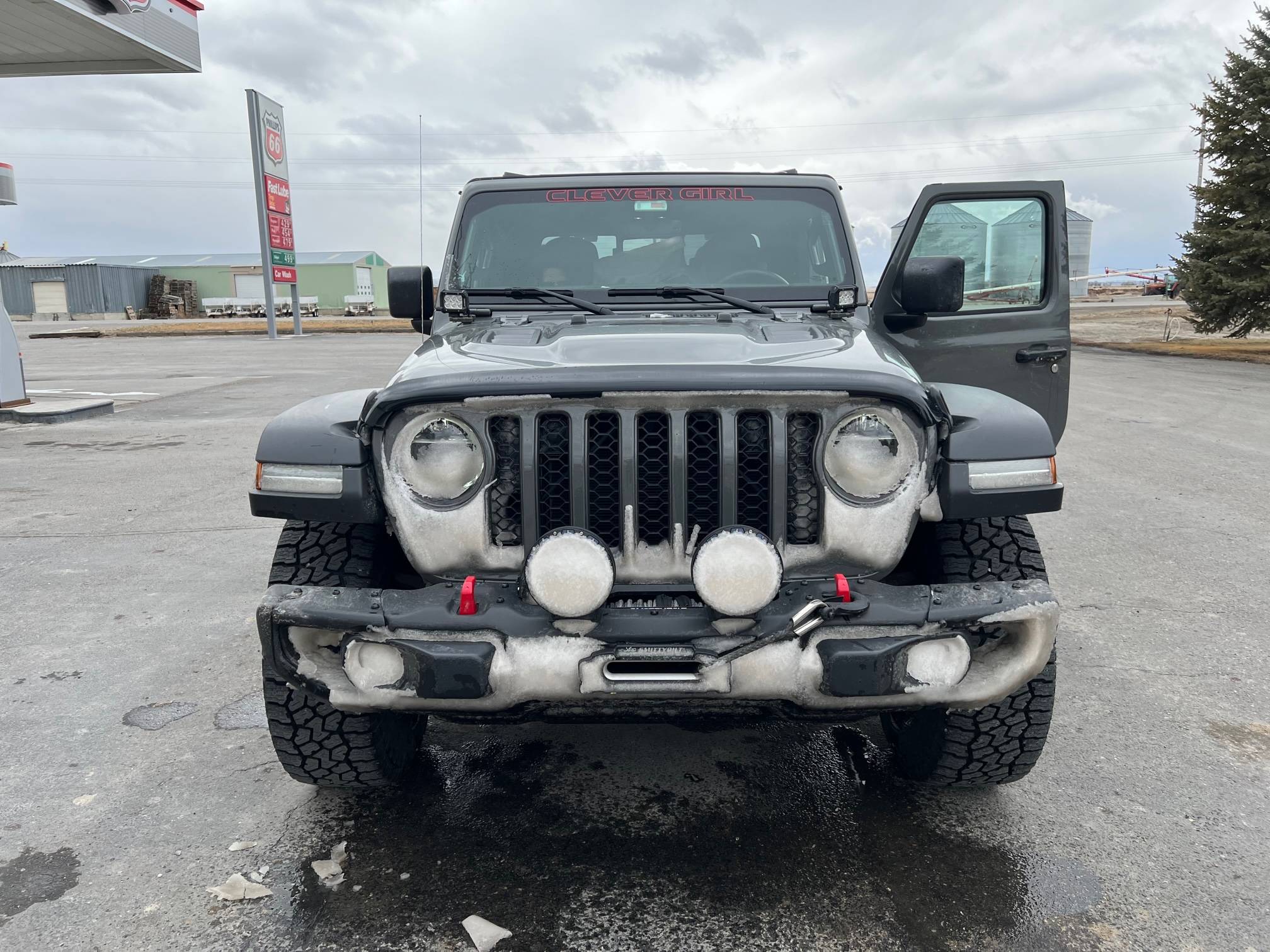

The cold weather package is necessary. And being in UT, choose the not "leather" option, since Jeep doesn't have cooled seats. If you're out in the summer with top off/doors off, that interior is gonna get hot.
Upgrade to the aftermarket heated headlights.
This is after an hour of snow-free travel from Jackson through part of ID:
Jeep Gladiator Is it worth getting the options from the factory, or adding myself afterwards? IMG_0163
