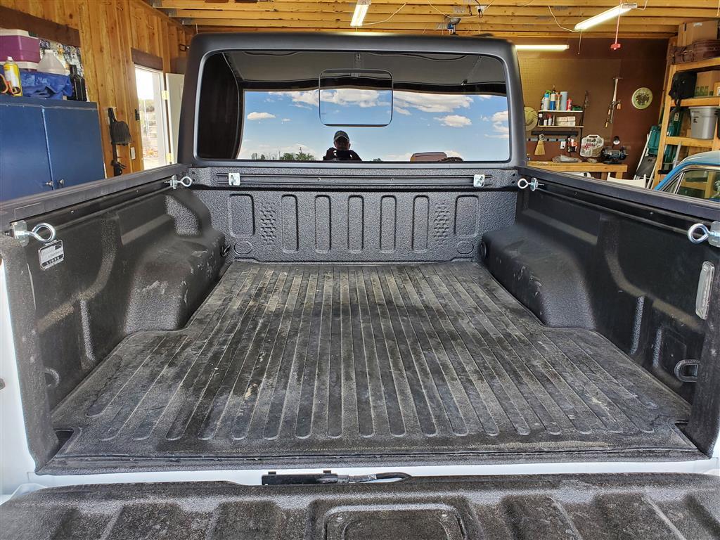

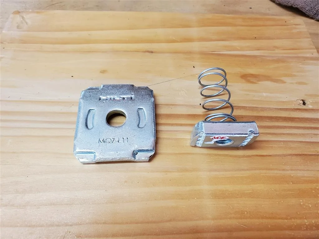

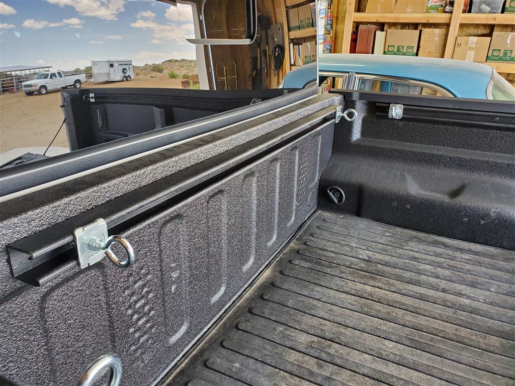

This is what I ended up with. I bought some solid Unistrut, cut it to length and drilled the holes where they needed to be. Some wrinkle paint and there you go. The anchors are nothing more than hardware store eyebolts, Unistrut nuts and washers. Works great and half the price of the factory system.

If I were to do it again this would be the gameplan because I need the rail to protrude beyond the bedside for my cap brackets. I thought the rail system would be like the Tacoma where you can insert cleats anywhere with a 90 degree turn but it's not and it's a huge turnoff for me at the price.
Yea, the beauty of this set up is all you have to do is loosen the jam nuts and you can move those anchors wherever you need them. Also with those nut plates you can bolt literally anything to it. I'm getting ready to put a NATO gas can carrier on it.
