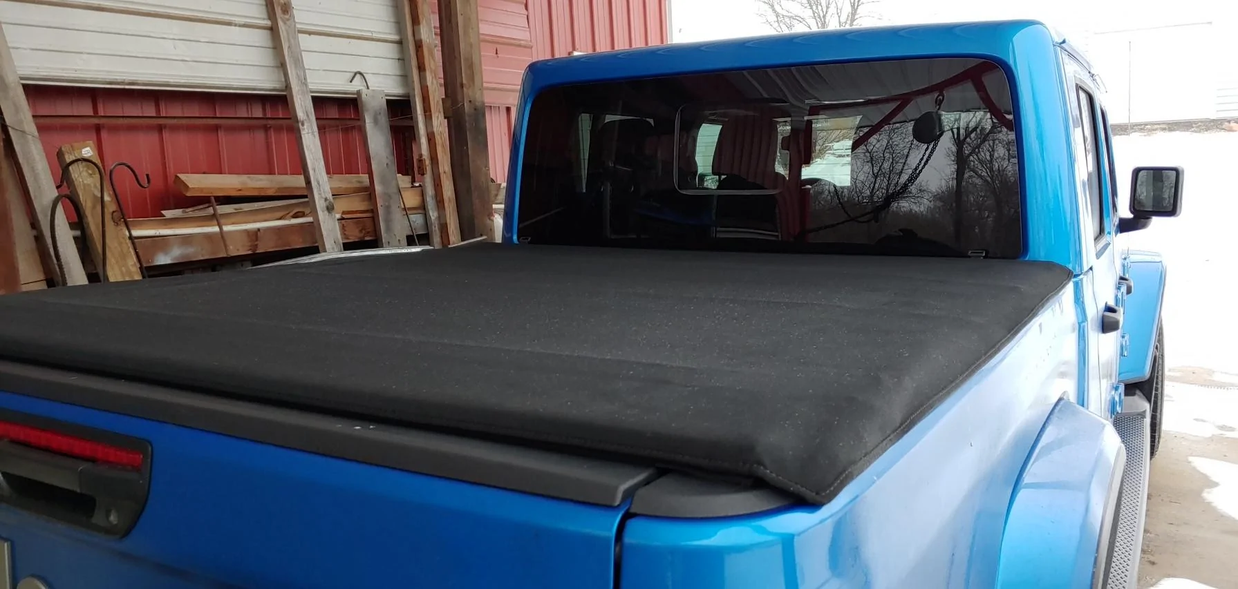

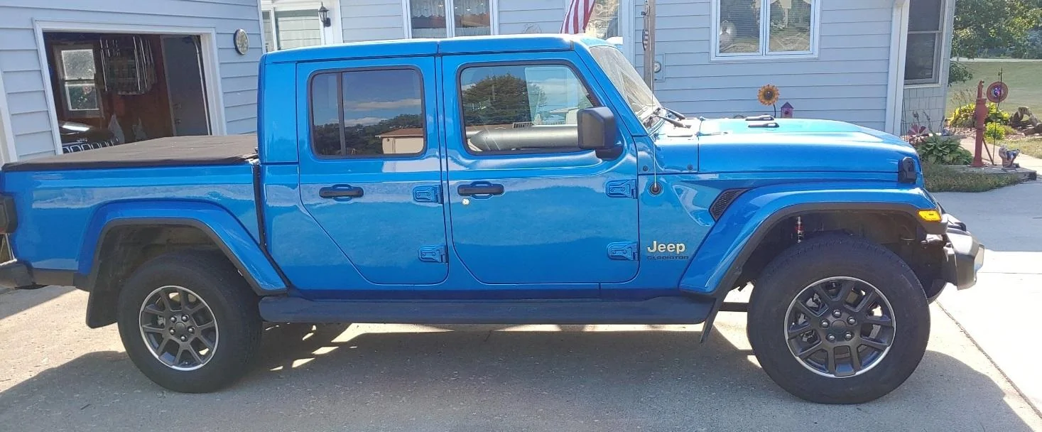

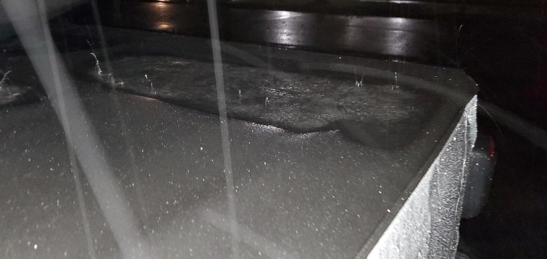

Mine not only lifts, but the side edge "straightens out" where it is suppose to round over a little. Anyone else getting this? The first picture is how it looks when I straighten it out. The second is what it looks like after I drive. It lets water in like you wouldn't believe after this occurs if I don't get out and try and get it back to it's original position. Both pictures are taken while the vehicle is in park (I'm sure someone was going to ask ). Anyone else experiencing this?

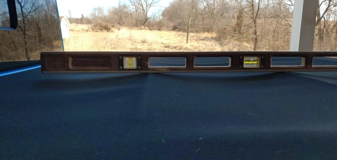

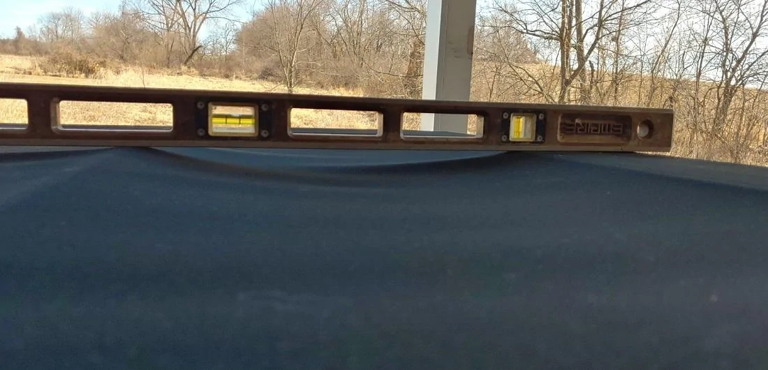

When I first got the truck and got home I noticed one side stuck out while the other rounded down better, not great, but better. I posted many photos with my 8' level on the back showing how badly it sagged. It pooled water like a pic in this thread above here. Mine had the same symptoms - loose, sides not going down like they should, flapped in high winds (not so much on a calm day driving at 70, but at 70mph with wind even my wife noticed it)

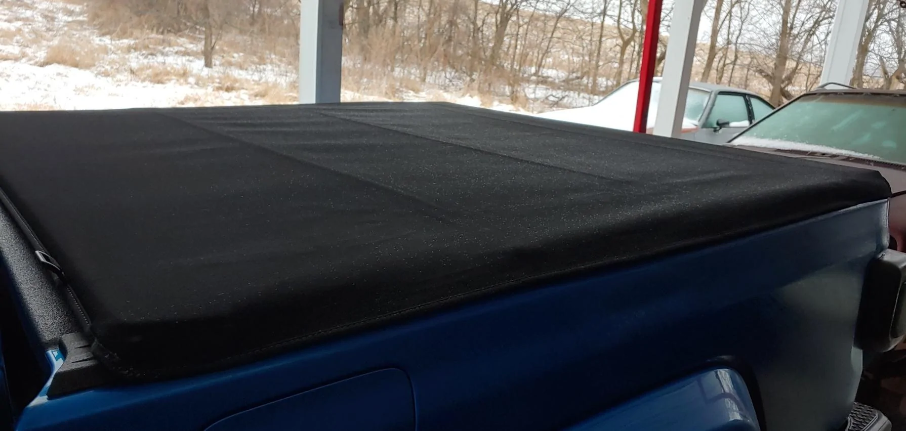

Might be hard to tell from this pic but this is the cover as it stands now, months later, 6,500 miles later -

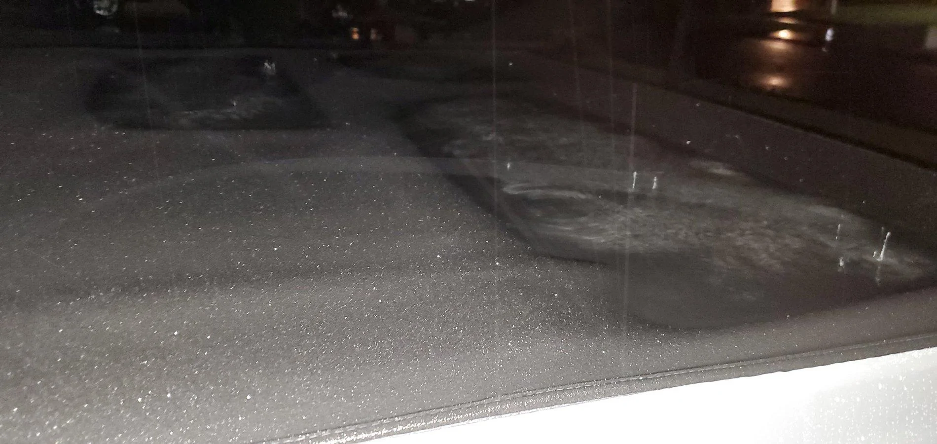

Ok. Thank you. I'll be calling for an appointment next week. You can see in these pictures that it looks really bad when it rains.

Here's a before -
Jeep Gladiator tonneau Cover started lifting at sides when on highway tonneau-1
Jeep Gladiator tonneau Cover started lifting at sides when on highway tonneau-2
And now - no sag, rain does not collect and sit on it -
Jeep Gladiator tonneau Cover started lifting at sides when on highway new-cover-
Jeep Gladiator tonneau Cover started lifting at sides when on highway new-cover-1

One side sat down at an angle like it should, the other side had an area where it sort of stuck out straight instead of down. When I mentioned that at the dealers where I bought it, I got the "that's normal, they are all that way" line. The more I dug, the more I realized, no, they are not all that way.
Now it's fine.
We certainly can see your concern - and we would be happy to offer assistance alongside your dealer.

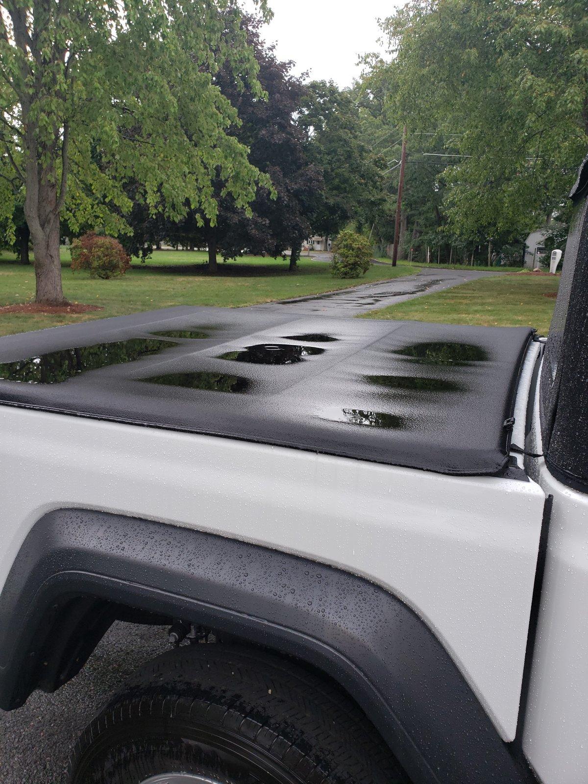

My cover (less than 4000miles) collects all kinds of water and it also lifts up in the middle/sides at highway speeds. Figured it was just a cheap cover. Guess I better call the dealer/ @JeepCares
