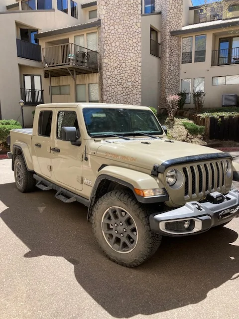

I bought my 2020 Overland with 114,000 miles in October, now have just over 120,000. Problems? None.
I did pull the aux battery, now lives in a friends Harley. I did install a TazerMini and no longer have Start/Stop issues but without the aux battery, I get the warning. Also have a display of 14.4 volts on a day to day basis but no starting issues. Paint is like new, interior is like new, runs like new. Has slightly larger BFG 02 AT tires but get about 19 mpg most of the time, higher on the highway.
