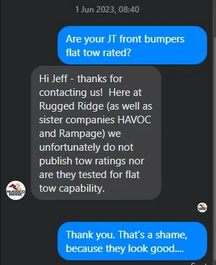

Be very careful and tread lightly. I contacted Rugged Ridge. I liked one of their bumpers. They confirmed that none of their bumpers are tow rated. Your mileage may vary, but being ANALytical I wanted to ensure that whatever I bought was tested and rated.
I also contacted them, asking the same question, and got the same answer. But, if you look at their bumper the tow bar adapters are bolted through the bumper to the frame so the bumper itself is not taking any stress - it's the bolts themselves that are carrying the weight. We've towed several times so far with no problems.

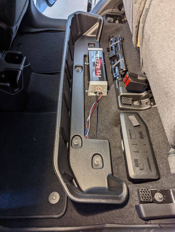

Looks like under the rear seat. I'm going to have to look...I have the Alpine package and I think there's a subwoofer in there somewhere.

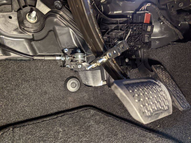

If you are referring to the brake actuator cable, there was plenty of length to reach the rear seat, and perhaps even the rear cab wall. The cables and wires in the Brakebuddy kit where sufficient. You will need to run the 3 or 4 wire harness and a sleeved cable from the firewall to wherever the actuator controller is mounted, typically under the carpet or along and under the floor-to-door trim.

Most installation videos I looked at placed the controller box under the driver seat. The fit was tight, and could conflict with some accessories. Yes, I believe you could fit it under the passenger seat as well. The box is not large, but you do want to allow for a proper radius for the actuator cable for smooth operation. I chose the back seat because it was very easily accessible, allowed me to see the diagnostic LED, and would not interfere with the seat (it would have been a tight fit) or rear seat passenger foot space or the aftermarket floor trays.

…if you look at their bumper the tow bar adapters are bolted through the bumper to the frame so the bumper itself is not taking any stress - it's the bolts themselves that are carrying the weight. We've towed several times so far with no problems.
RR arcos bumper to blue ox have over 10k towing coast to coast twice, Colorado, Utah etc. no problem that’s testing it works great.
Since Rugged Ridge has specifically stated their bumpers are not tow-rated, should something untoward happen (God forbid,) you’ll be fully responsible for damages.

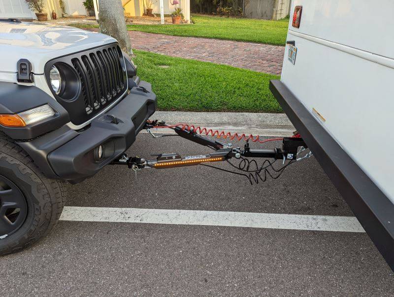

Since I've been using Blue Ox products with good luck since 2008, I went with one of their towbars and baseplate. I also have a Brakebuddy Vantage Select. finally I went with CoolTech's wiring harness.
We pulled it last month for about 1500 miles from Florida to the mountains of North Carolina and back with no issues. All good.

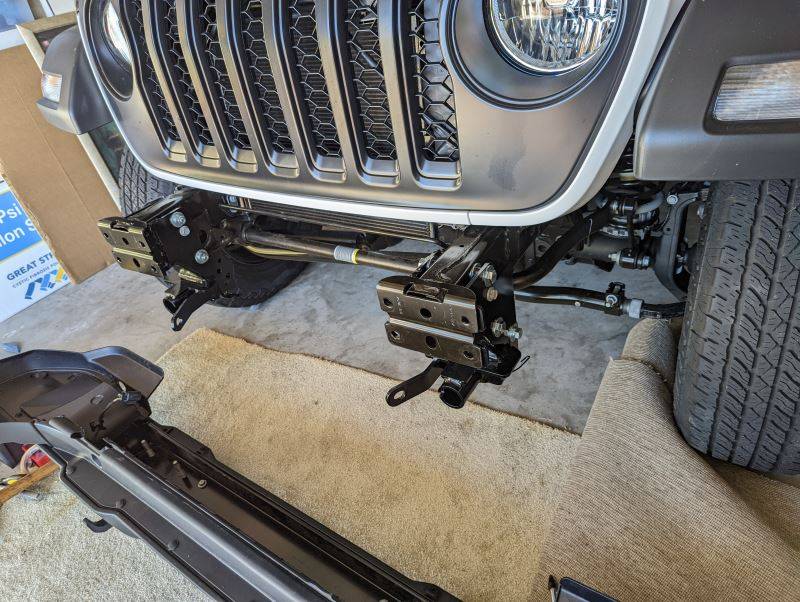

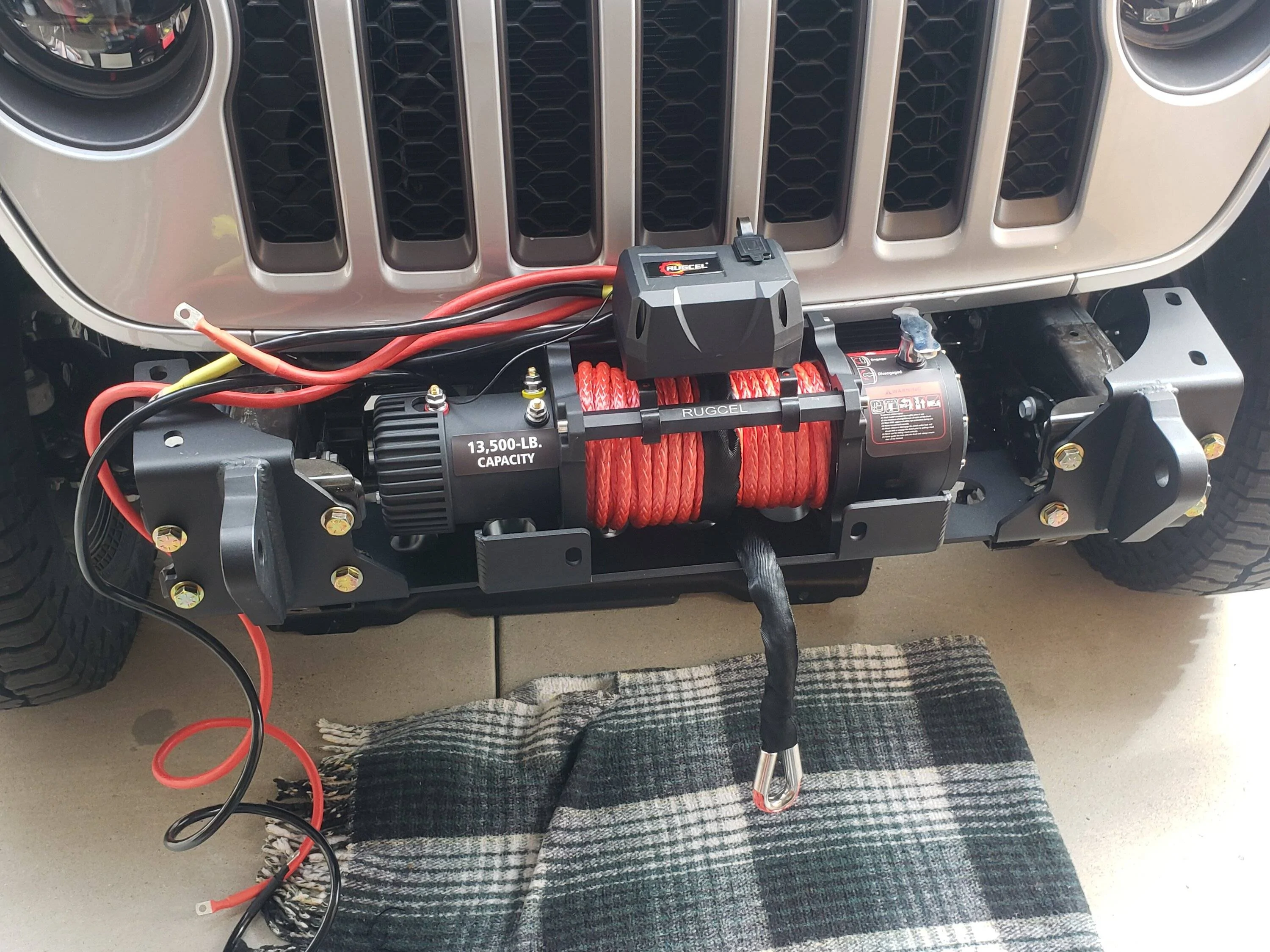

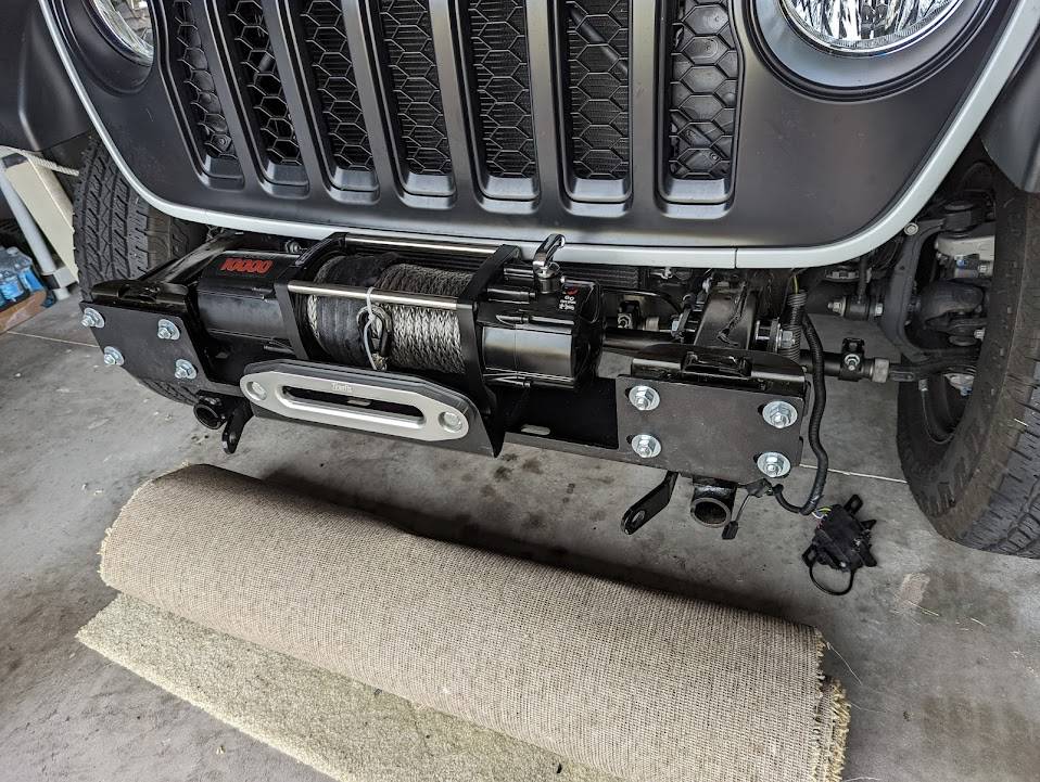

Finally received it and installed. Definitely not just a few hours. Especially since I really didn't know how to remove the factory bumper. A couple threads here and a Youtube video helped.
6-8 weeks on site...took just over 10 weeks. Mark that up to all of the current supply issues since 2020. However, they also had a glitch on the website. 2 different install directions and I downloaded the wrong one. I provided feedback to the company. Also, the foglight retainers are missing. I wish I'd taken more pics during install, but it was 90* and I wasn't just casually hanging out in my driveway and sweating. Pics...that's what forums are for. First was the winch plate which I didn't take a pic of....then it tells you to install the winch first. Not a good move for this one, as the internal bolts are tough to get to...I had to remove the winch, after install to tighten the bolts. I went with a cheaper winch, as the last 2 offroad vehicles (Pathfinder and buggy) I've had, I've only used the winch once. If I use this and break it, I'll either buy the same or a better one.
Jeep Gladiator Towed (Toad) Gladiator 20230903_164553

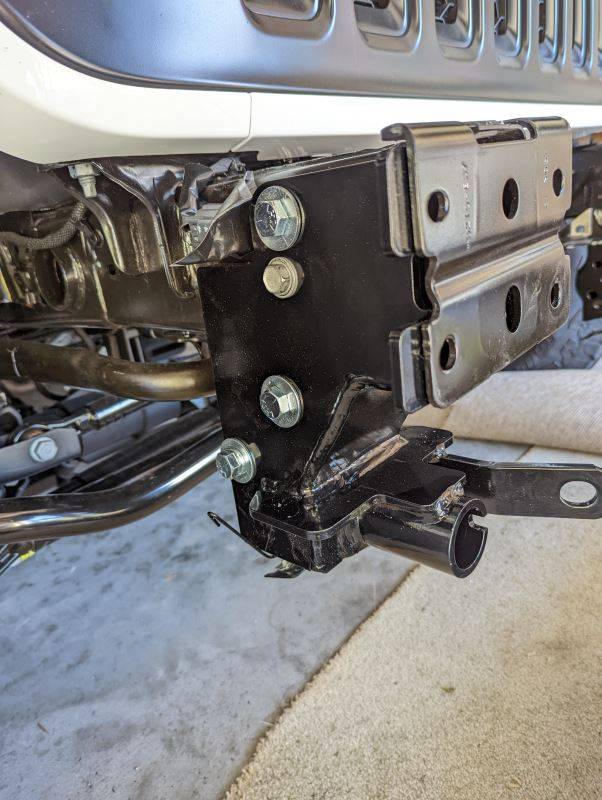

You can see in the next pic, there were multiple tries at getting the bolts in. They didn't quite line up correctly. Installing alone, I had to put the bolt retainers on and align, then tap and tap, then remove and restart a few times. You can see the scratches on the tow points. After routing the cables up under the grill to the battery, it was good to go...but then I noticed that you can't see the cable...as it was not through the fairlead hole (again, it was hot out).
Jeep Gladiator Towed (Toad) Gladiator 20230904_213627
So removed again and installed correctly.

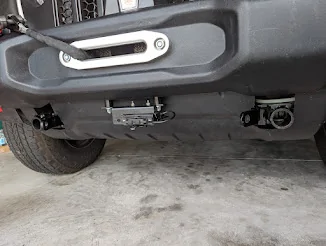

Also, put the caps on and provided my feedback to Venture. Odd that they said to install the foglights first. If I'd done that, there is no way that I could have tightened the bolts inside that access hole.
Jeep Gladiator Towed (Toad) Gladiator 20230903_172445

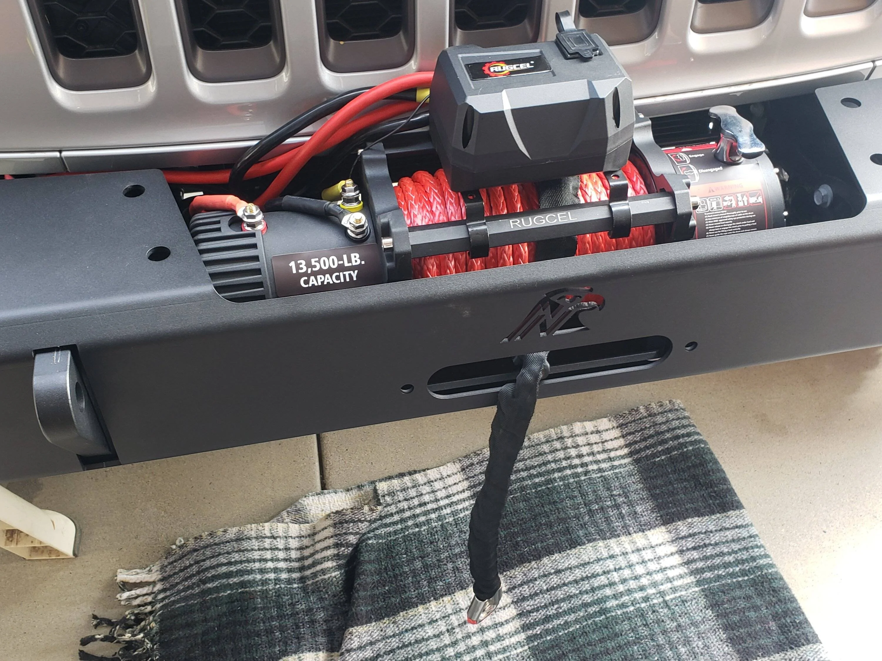

The next steps were to install the fairlead guide and cap the exposed connections. I trimmed the covers a bit to get them in place. This weekend, I plan to install the LED foglights.
Jeep Gladiator Towed (Toad) Gladiator 20230909_110241
Yeah...I'm not too stoked on the holes in the top that I'm not using....
