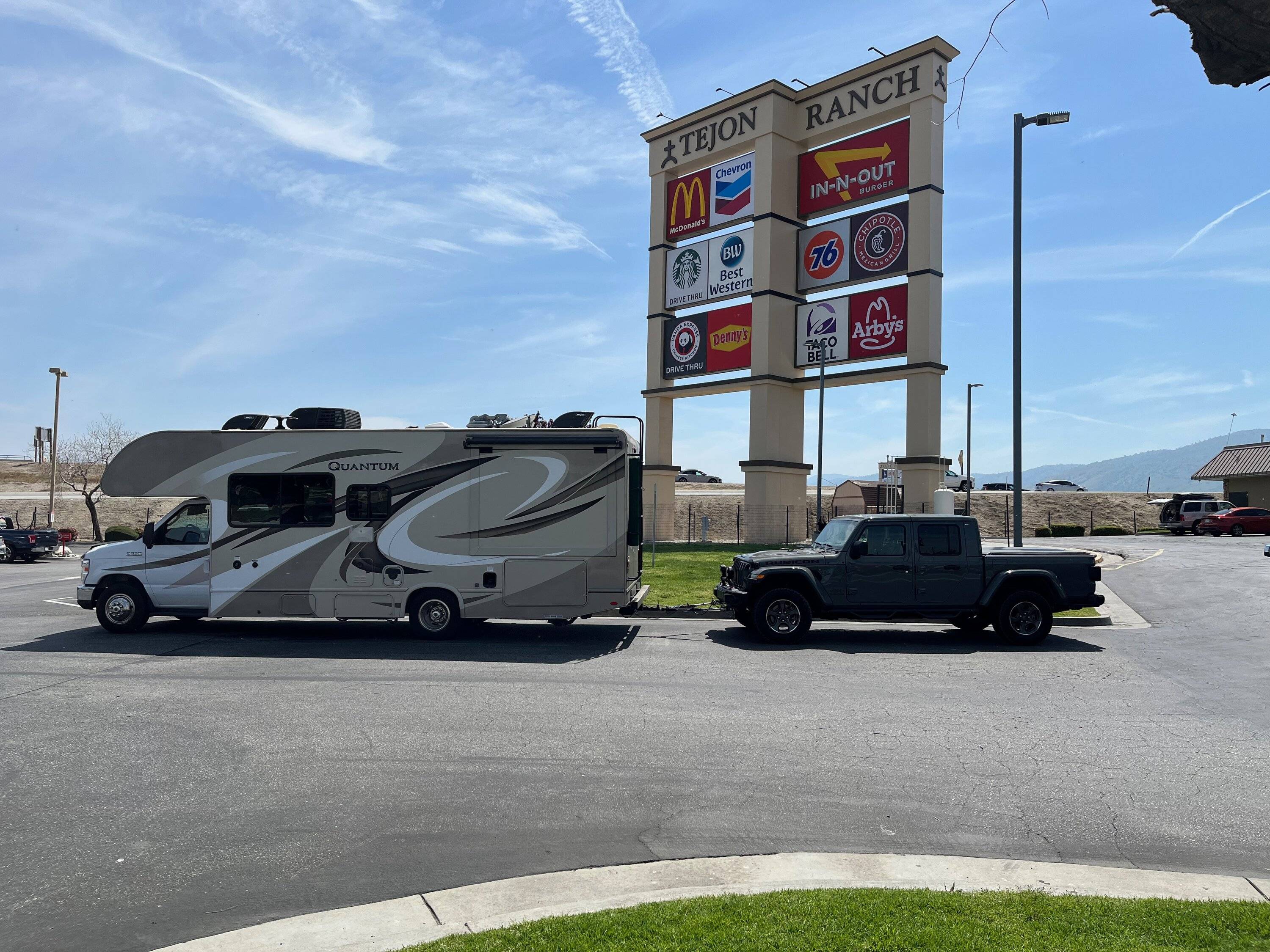

Towed my 2020 JTR a bit over 1000 miles in the last week. Not a single problem with either the Jeep, the RV nor the tow. Man, the interstates are pot holed to hell!
Even pulled it over the "Grapevine" here in SoCal, a known tough pull and still manage to stay between 55 - 65 mph without any overheating. The (crappy) factory gauge normally reads about a needle-width under mid point and during this pull it only ever got to the mid point and no higher.
PS: Oh, I forgot. There was ONE issue. The lower bolt on both Maximus Tow Loops vibrated loose twice. I had two major stops on the trip and at the 2nd I dropped into an Autozone and got some thread locker, re-tightented them and they did not come loose again. Those damn pot holes! For whatever reason the top bolts never got loose.

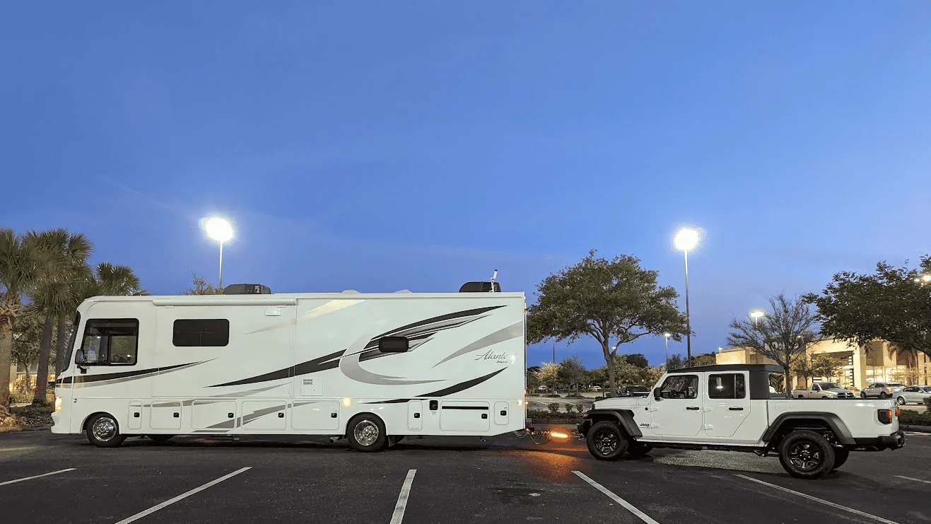

I set the tranny to 'Tow/Haul mode' which changes the shift profile. Does fine on cruise control on grades up to 4-5%. It will downshift and start 'screaming' when it has to hold over 3800 RPMs, but no overheating issues at all, even in the summer months. Uphill grades over 5% have difficulty acerating or keeping speeds over 50-60. 6% grade will slow down, and 7% or more is 'unpleasant', slowing down to as low as 35-40, or kicking off the cruise control. So, it can do 7-8% grades for short runs, but I will plan my trip to keep it at or under 6% when possible.

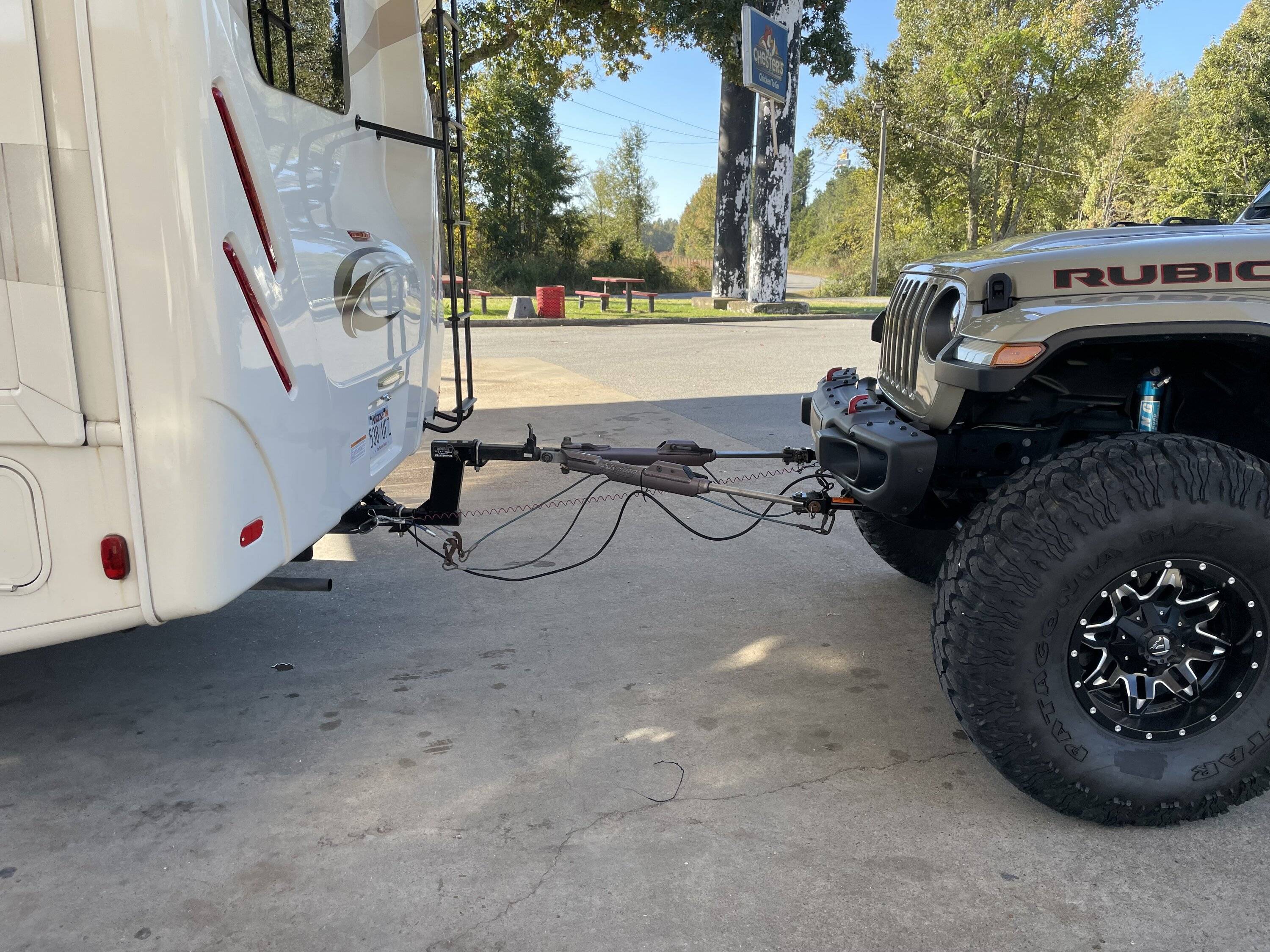

All-in-all guys I do NOT recommend using the Maximus-3 Tow Loops. I think a conventional base plate bolted to the frame is both more reliable and much easier to use. Removing the through-pins after towing continues to require me to use a hammer and punch. Unless both the RV and the Gladiator are on perfectly flat, level surfaces AND there is no load WHATSOEVER on the pin it will NOT come out without being driven out.
I use a rubber mallet to tap out the pins from my Maximus-3 tow loops, but I don't have to drive them out.
I'm using a Falcon All-Terrain tow bar, perhaps that makes the difference.

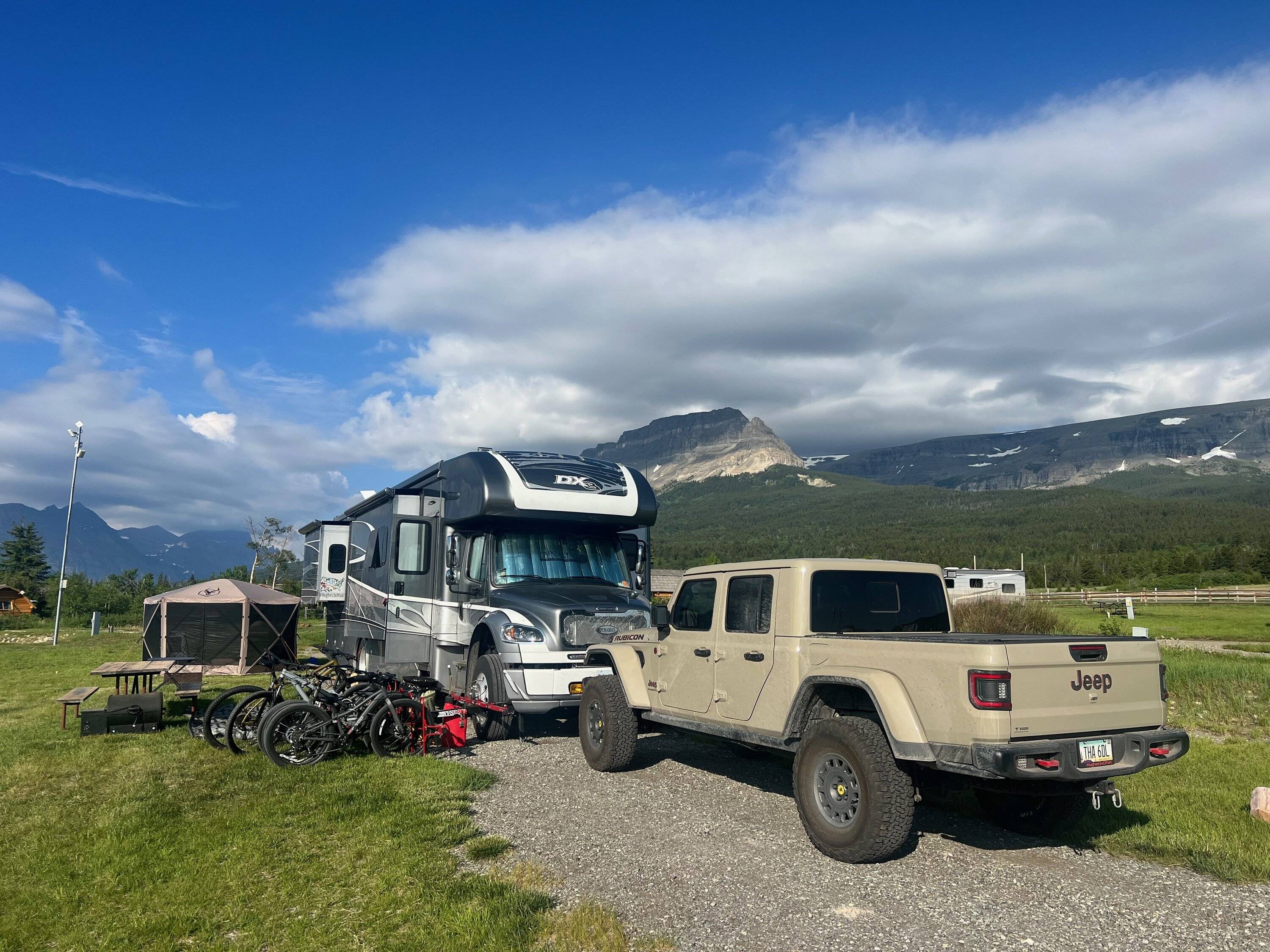

Im at Glacier National now. 1 month into a year long trip. I cant even feel my Gladiator behind my Super C
