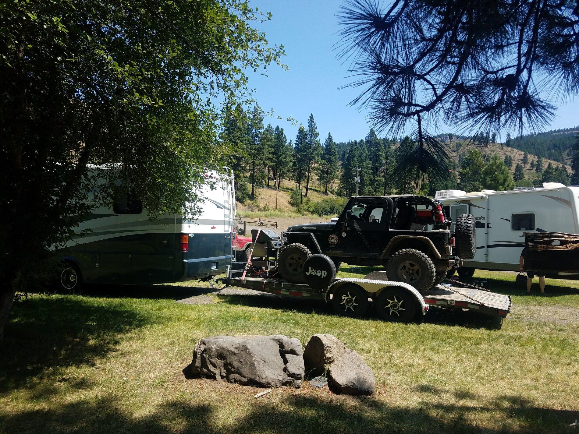

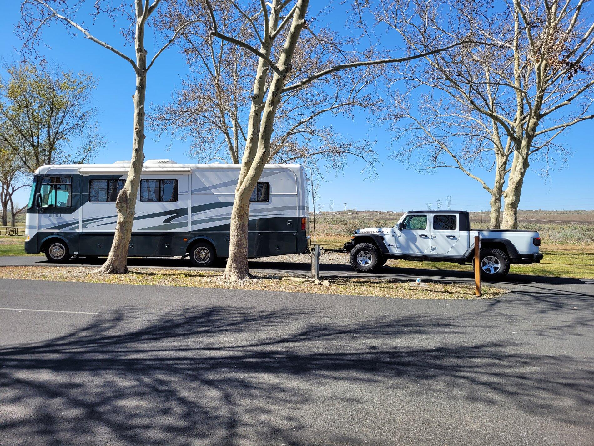

Our little class A Ford V10 powered motorhome pulls our JTR. A little slow up really steep grades, but otherwise does fine. On moderate grades, I can keep it at 55-60 mph.
We used to trailer our built TJ on a steel PJ car hauler and it did fine also. We also towed the same combo behind our previous 26' F450 Class C, and I honestly can't tell the difference.
Supplemental brakes in the Jeep is a must IMO.

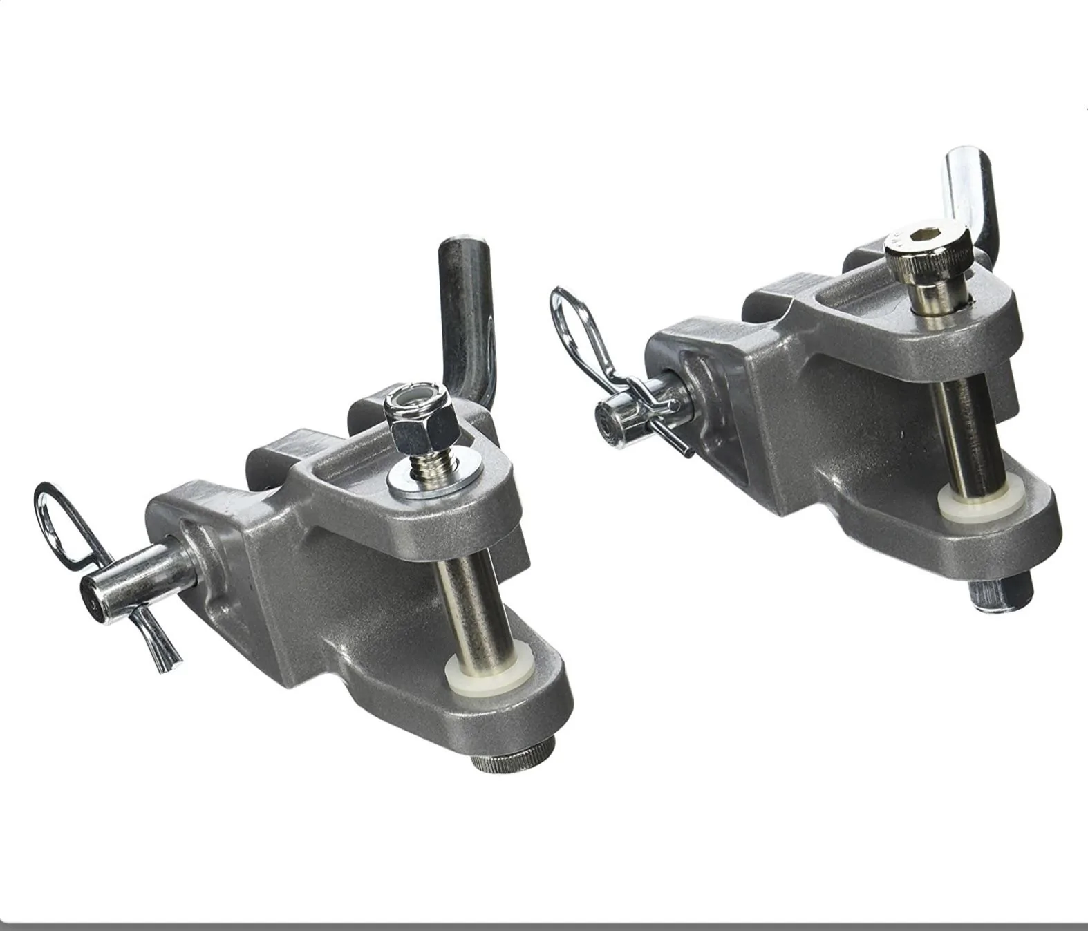

The Roadmaster 035 adapters are what you need. While you won’t save much money, the tow loops are much less obvious than a traditional base plate, which is why I went that route.

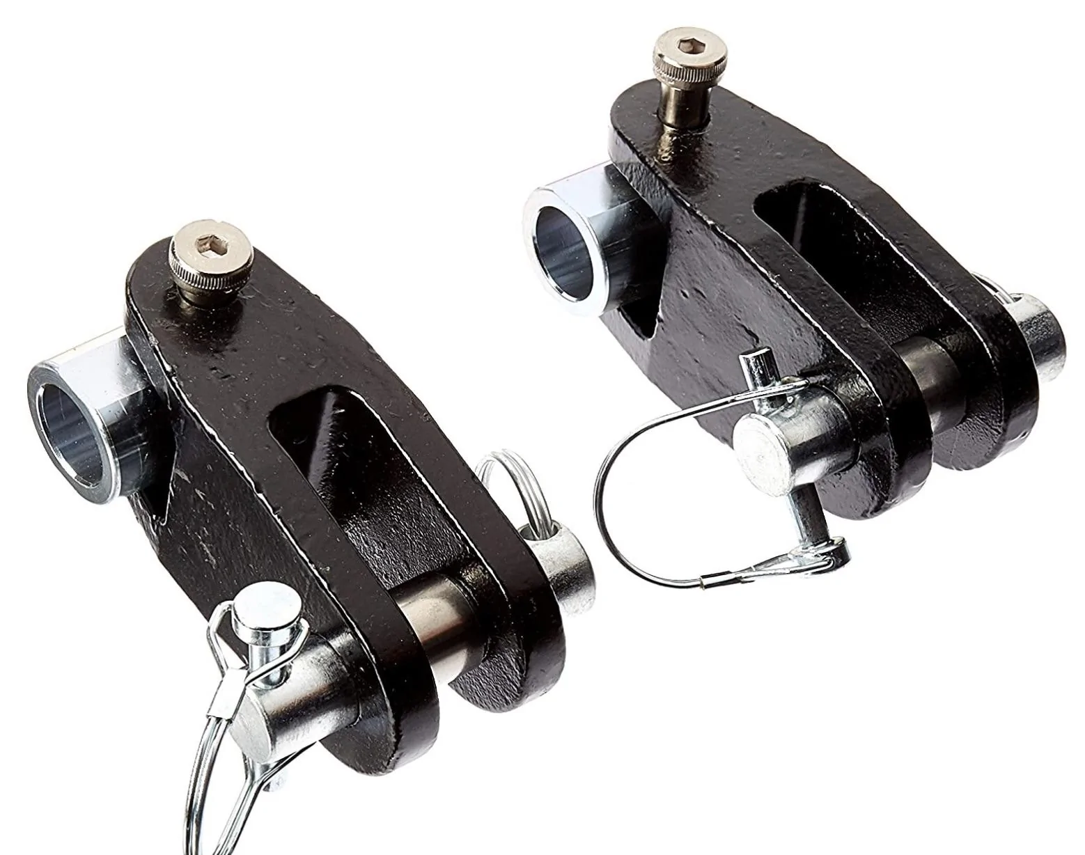

Well, it looks like I screwed up again! I ordered/received the 031 adapters when I meant to order the 035 adapters. DUH, I can be such a dumbschit sometimes.
Good thing I'm NOT towing the Gladiator anyway. The electrical interface I need to mount on the Jeep has to be ordered and takes a week. I if I had the correct adapters I COULD tow it but the brake actuator would work. The fiat weighs between 2300 and 2500 lbs. The Gladiator weighs 4600 - 5000 lbs. Neither is legal to tow in CA w/o a brake system but obviously the Jeep would be a way bigger concern. The gray ones are the 031's and the black ones are the 035's I should have gotten.
Time to return and re-order.

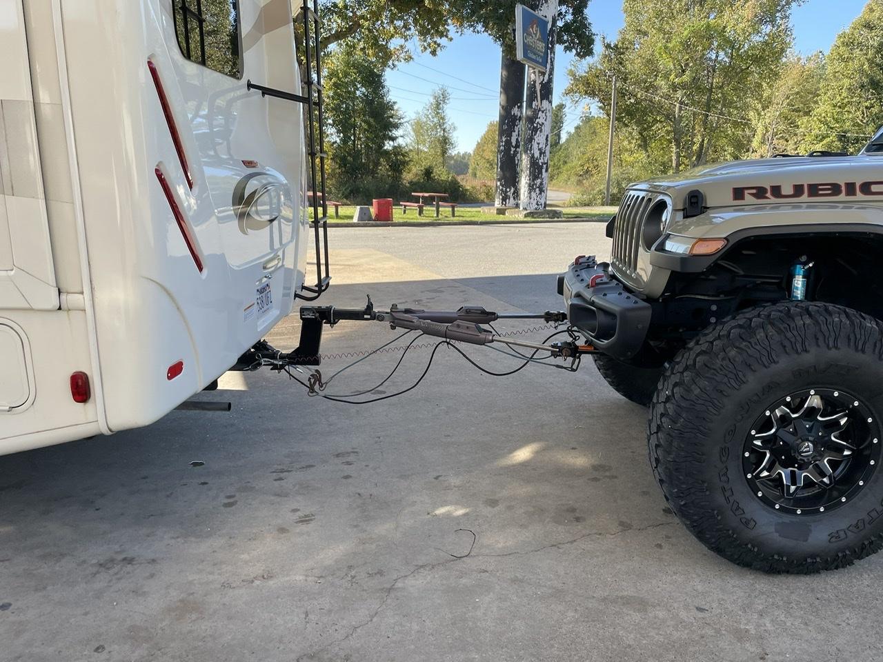

Very similar setup for me. I’m using the Raodmaster direct connect baseplate, an older sterling all terrain bar, and blue ox portable brake. No issues with the f-53 chassis as long as wind isn’t above 15mph. Anything above that just have to slow down. I did have to add a 10ā€ riser due to lift on jt.
I am at max weight on gcvwr when loaded for travel.

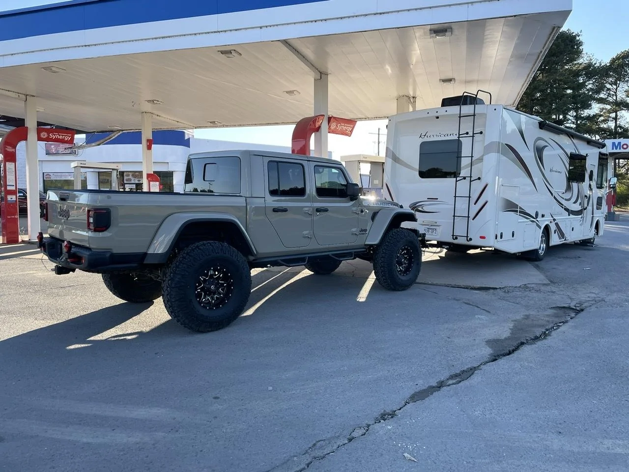

I tow my Gladiator with my 26’ F350 class C with the 460. I get a bit of a sway, how is yours doing? I used the blue ox tow bar and base plate.
Dan in Pasadena
May 22, 2021
509
923
Glendora, CA
Yours has the 460? Mine has the Triton V10, I thought all the E350/E450 RV chassis did.
Anyway, I'm using the Roadmaster Falcon II tow bar but it doesn't hook up the way it does to our Fiat 500 - the earlier toad. We still have it and we installed a baseplate on it. Haven't towed it since we got the Gladiator. On the Gladiator it's attached to Maximus tow loops instead of a baseplate. They offer an optional cross bar thingie so I got it too. The one thing I use to help with the tow is rear air bags on the RV. Not for weight but for stopping side to side body movement over driveways and speed bumps. But on ordinary highway driving, no sway. I don't find the weight the Gladiator an issue at all so far. In May we are heading to Yellowstone among other places. A 6-7 week trip. That will test it.
