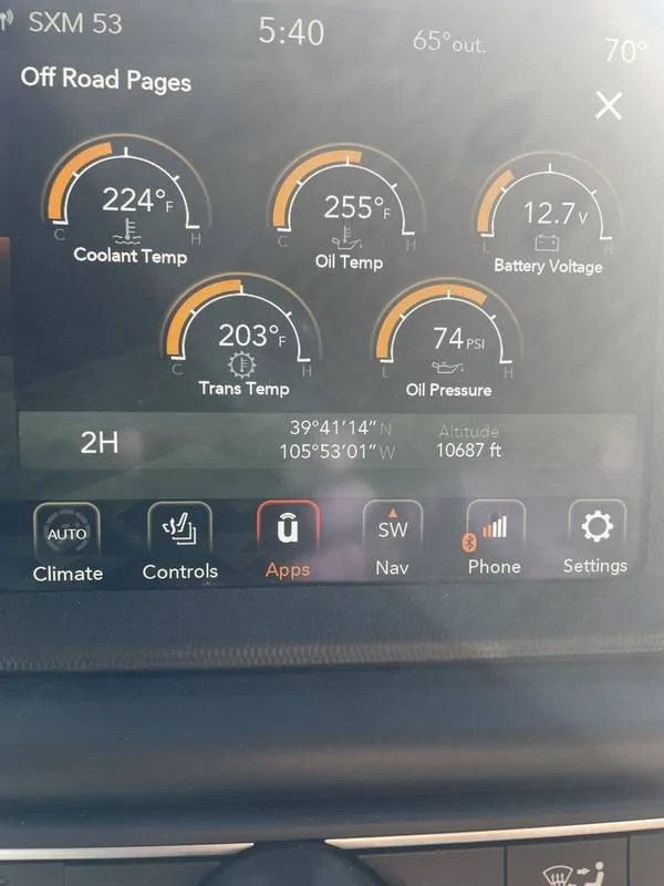

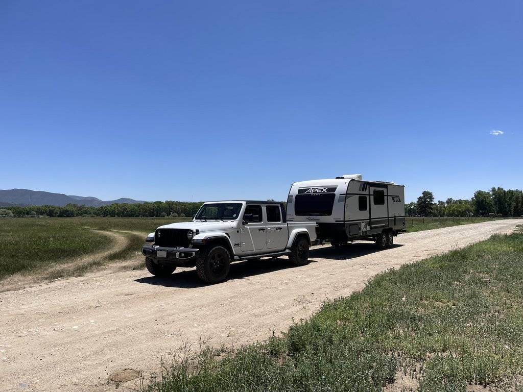

Finally had a chance to put the truck through its paces. Spent a weekend in a loaded truck towing a 5k camper up and down various passes in Colorado, including I70 through Eisenhower tunnel, Leadville, Kenosha Pass, and Guanella pass, with the highest elevations over 11k feet.
My truck is a Sport S Max Tow with 33s and stock otherwise.
Coming from the F150 with the 3.5 Ecoboost I had very low expectations for the tiny 3.6 Pentastar, anticipating to spend most of the drive with the truckers in the slow lane. The Gladiator was on the slower end of traffic but managed well for most of the trip.
Manual shift mode was a must for the entire trip unless I wanted to stay in 3rd gear with a screaming engine the entire time.
Truck power was at its limits on two occasions when cresting the passes at 11k feet. Had to downshift to 2nd gear and 45mph to make it over the hill on the final stretch. Not enough air up there.
Other than that, the truck was able to keep up with traffic going 55-65mph. I was in 3rd or 4th gear on steep inclines and 5th and 6th gear on straights.
Temperatures peaked at 224 for coolant 255 for oil, and 203 for transmission.
I was surprised to get over 10mpg average, about the same as my F150 towing the same camper.
I'm using an Equalizer 10k WDH and the truck was stable and in control with moderate winds and passing semi trucks.
I was disappointed in the Redarc brake controller and need to take a closer look to dial it in.
Overall, the Gladiator absolutely needs more power if towing was my primary use case.
Jeep Gladiator Towing at altitude not as bad as I expected buena
Jeep Gladiator Towing at altitude not as bad as I expected gauges
