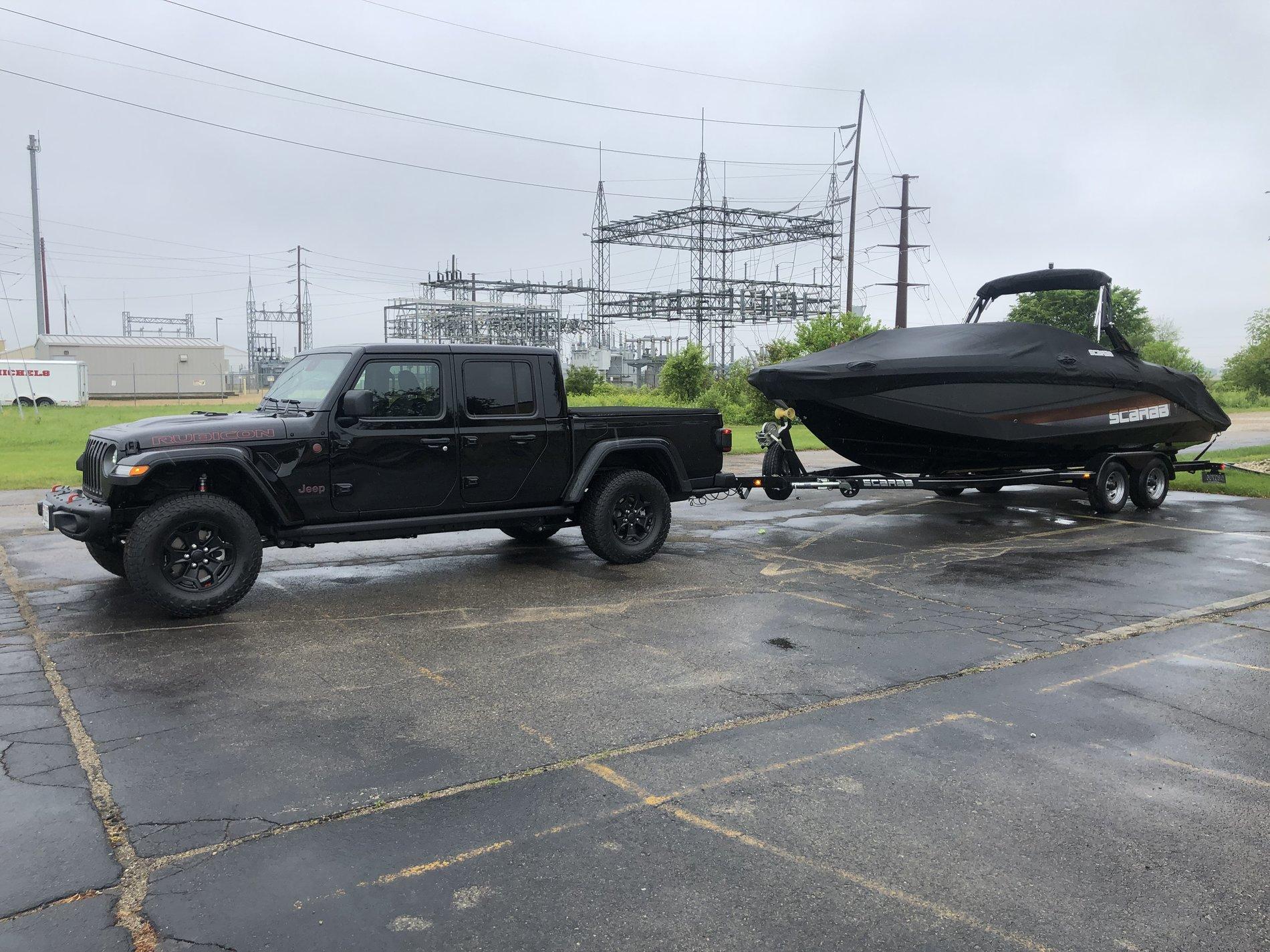

Towed my 4500-5000lb boat and trailer just fine. Didn’t seem to overwhelm the truck at all. Speeds were from normal city driving up to 65mph. I think the test for me will be when I’m towing my 21’ v-nose snowmobile trailer and get hit with cross winds. I have a sway control hitch but will still be interesting coming from a full size truck.
Edit: Don’t think I would push it any higher for long distances.
