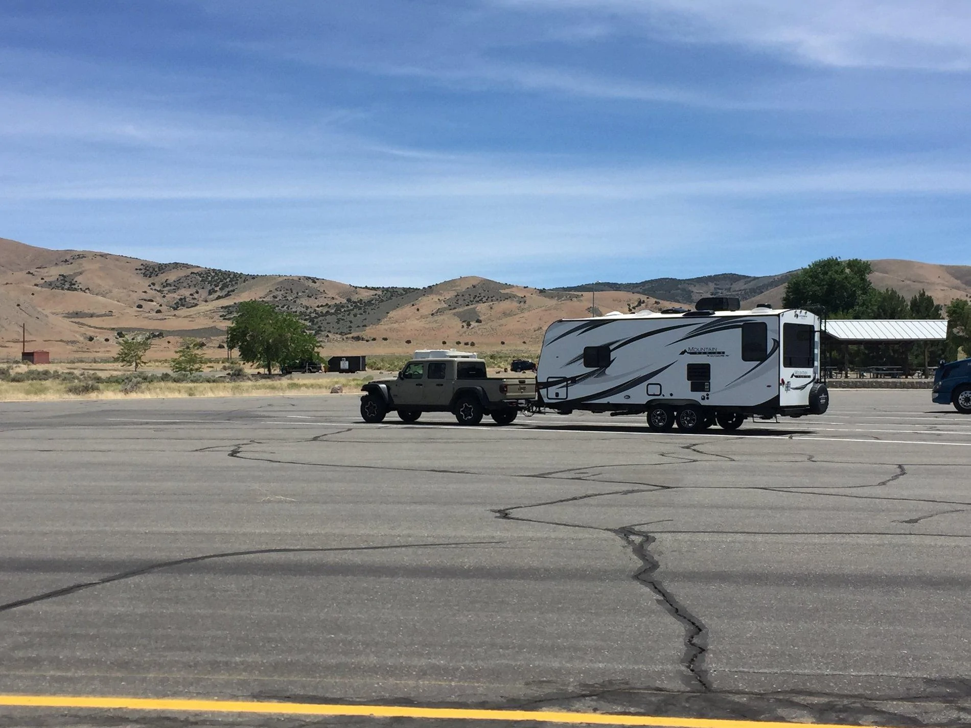

I have a Rubicon with the tow package and have added airlift airbags. Using a Husky weight distribution hitch I recently towed my 21RD Outdoors RV trailer from the San Francisco Bay Area to Boise, Idaho and back, 1600 miles and averaged 10.2 mpg for the entire trip. GVW was 12220 Lbs. with all hands aboard and rolling down the road and I used a Curt Echo brake controller, which worked great, and the stock mirrors were adequate and I will not be changing them. We bucked a 30 mph headwind for about 180miles and it really sucked the mileage down, more so than the steep grades. Overall I am really happy with how everything worked and will be running this combo around the west!

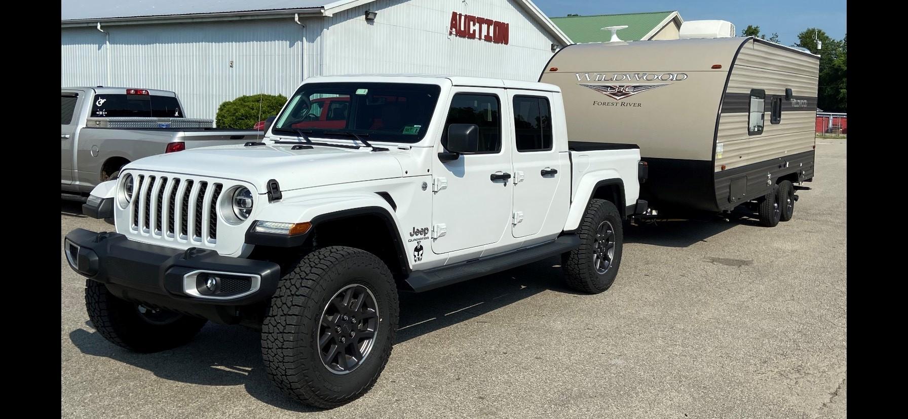

I tow this 3100 lbs as it sits with overland 3.73 and 33s tow package. No issues.
