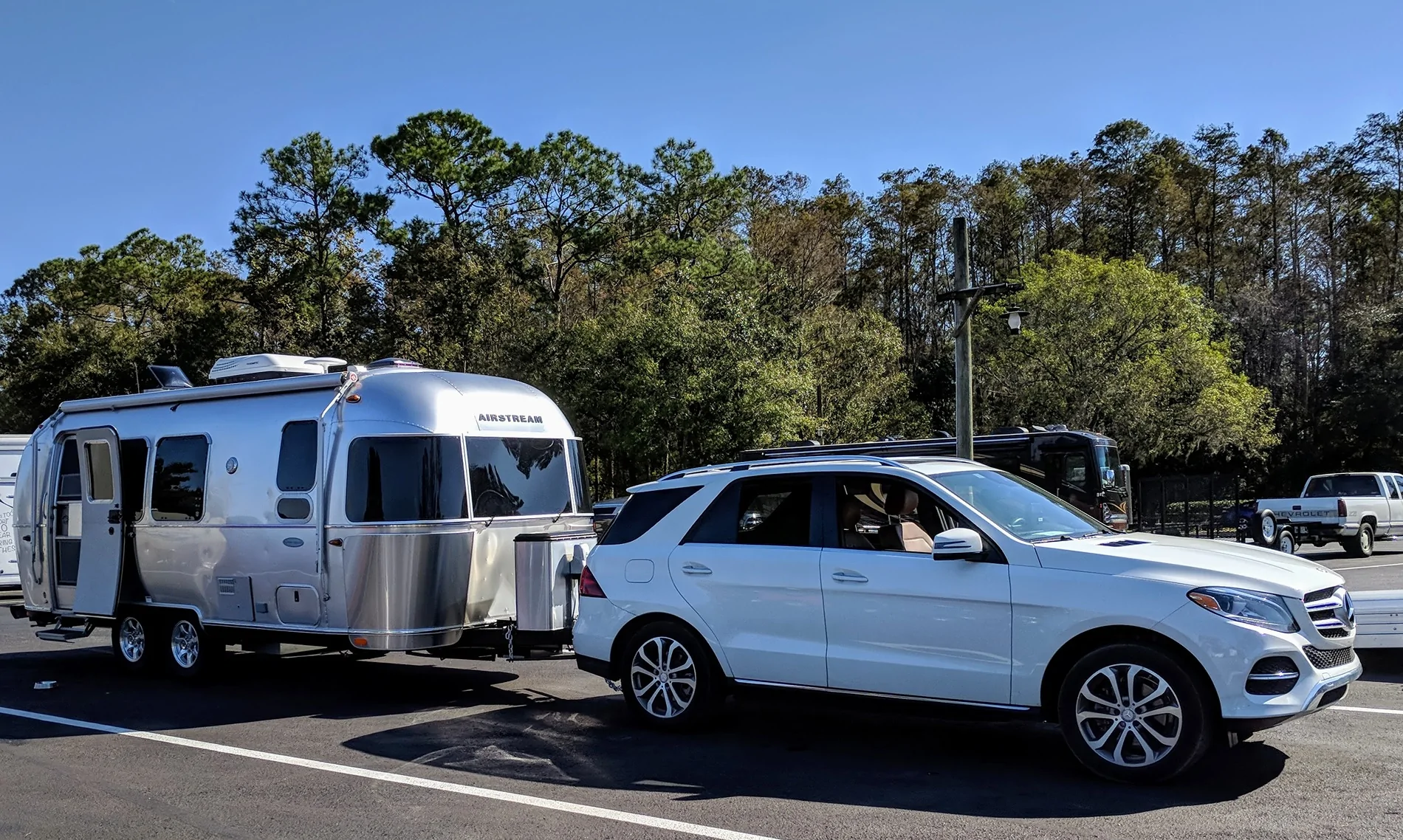

I towed our 23FB with my wife's Mercedes 2016 and 2020 GL350 gas SUV's. The 2016 was a V6 and the 2020 was a Turbo 4. Thousands of miles in the southeast and a few over the Appalachian Mountains. The 23FB with 2 axles is a really nice towing camper. I would say Airstreams in general are much easier to tow because of the aerodynamics and lower center of gravity.
Before we had the 23FB, we towed a single axle 22FB. Even though the 22FB was lighter the 2 axle was so much easier to tow (and backup). I used weight distribution on both trailers.
We eventually moved up to a 25FB, and I hauled that with a F250.
I know you asked for Gladiator specifically, but I would say the Gladiator with its longer wheelbase would be an even better towing rig than the MB SUV's I used.

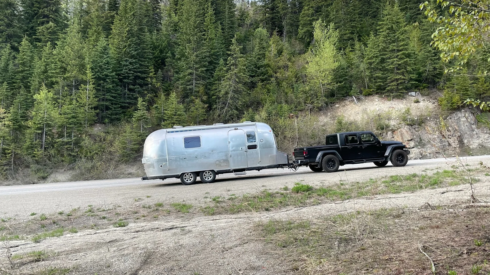

I towed a 23ft 1973 Safari with a 2022 eco-diesel Willys 1280km (800miles) over the Crowsnest Pass (4,455ft) in the Canadian Rockies. The trailer weighed in at 1790kg (3950lbs) at the time according to a roadside scale. I did struggle up the west side at one point but I might attribute that to my inexperience in pulling with my jeep ( first time pulling that trailer) and possible 'un-verified' set up on the weight distribution hitch.
