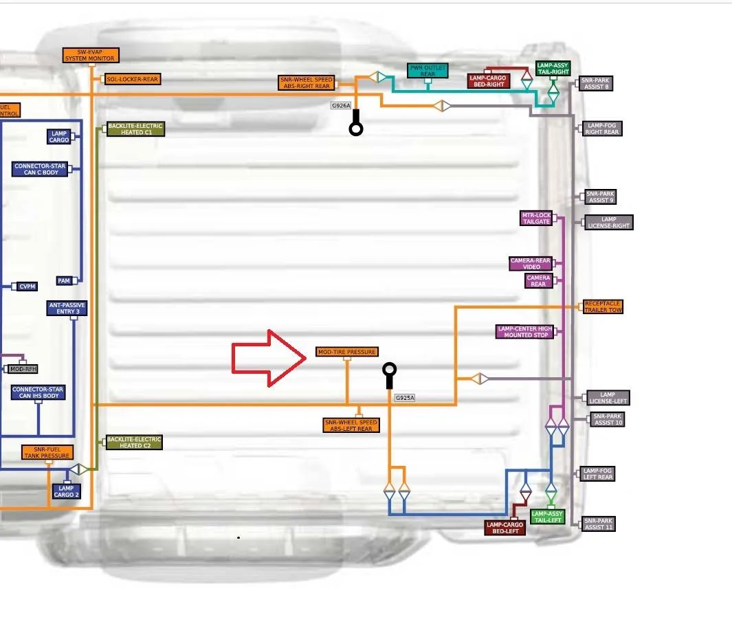

I have a stock 2021 (bought 10/20) Gladiator Sport with original wheels, tires and TPMS. I have an error reading any tires. I have tried to reset by unplugging the battery. No luck. Where is the receiver? Wondering if that's the issue. Any other ideas? I'm over miles on the warranty.

Are you throwing any codes? Did you check the TPMS fuse F94 (10A red)? Do you have a place like Discount Tire close by to hook up their reader/programmer? It may tell you if the sensors are done or if it just lost the code for the jeep to pick up.
Tire Pressure Module is located under the bed about mid section on a frame cross member attached to a L bracket. I have seen it before when I fluid filmed my truck. Need to be looking towards the rear to see it clearly.
When they went to the new TPMS system around mid 2021 that just uses the Radio Frequency Hub now, they just put a dummy box in its place for the CAN BUS pass through so it still looks like module is up there but it is inert except for the pass through.
