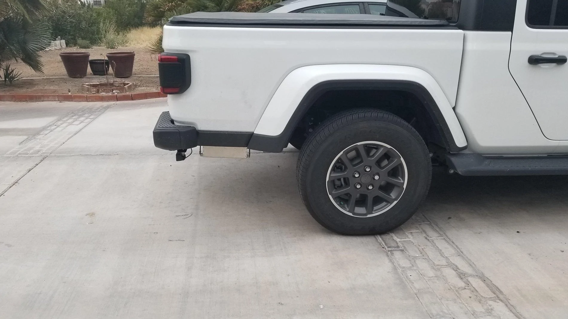

I wish I could take credit for the box. I just researched and mounted it. I did find it on Amazon for $30 less than the manufacturer sells it for on their own web site. https://smile.amazon.com/SOUTHWEST-...8?keywords=battery+box&qid=1575372389&sr=8-58
I'll get some better daylight pictures when I finish the wiring. Hoping to get some time to work on it this week.

Here's a daytime shot from a short distance.
NICE! Yeah, you dun good. Good quality jumper cables, nice battery box. You give me ideas for my own Overland,.
Mr._Bill
Jul 22, 2019
6,668
7,814
North Las Vegas, NV
Thanks. I'll put up more pictures when I get the wiring done and have it all working.
Wonder if the RSE step can still go there, then you wouldn't see the box at all, is there a similar location on the driver side, or is that blocked by exhaust piping?
One last question, did you have to drill into the frame to mount that?
The same space on the driver's side is where the exhaust pipe sits. Depending on how it mounts, there should be space for a step on each side.
I did not have to drill into the frame. There are two threaded spots that accept 10mm bolts. I used the two discarded bolts from the front receiver install to attach the shell to the frame. I put a nutzert in an existing cutout for the third 10mm bolt, and the lowest bolt goes through a hole in the receiver. I did have to drill a couple holes in the mounting shell for the battery box.
Well that is very good news.
