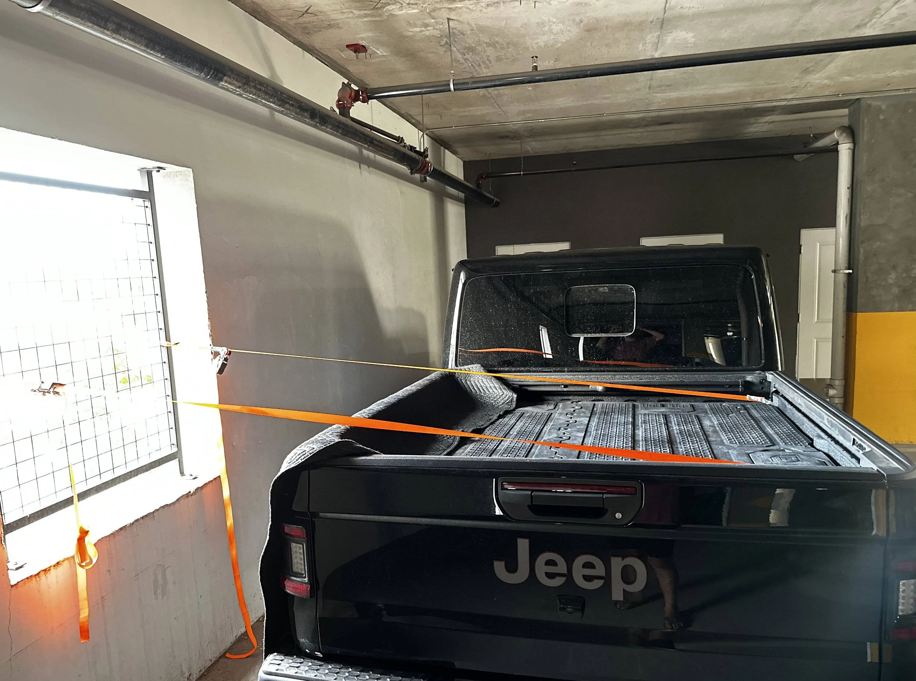

2021 Gladiator here. I took the advice and used ratchet straps connected to both rails. Unfortunately, this only removed one rail. This makes sense in hindsight but I guess I was hoping for both rails to magically pop off and I would be able to call it a day. Instead I had to attach the remaining rail to something sturdy and pop it off. I'm not sure if it's the double-sided tape or the plastic push pins (or a combination of both) but these rails refuse to pop off without a fight. The worst part was having to deal with the heavily loaded straps that felt like defusing a bomb anytime I wanted to release the tension. Oh well, the rails are removed now.
