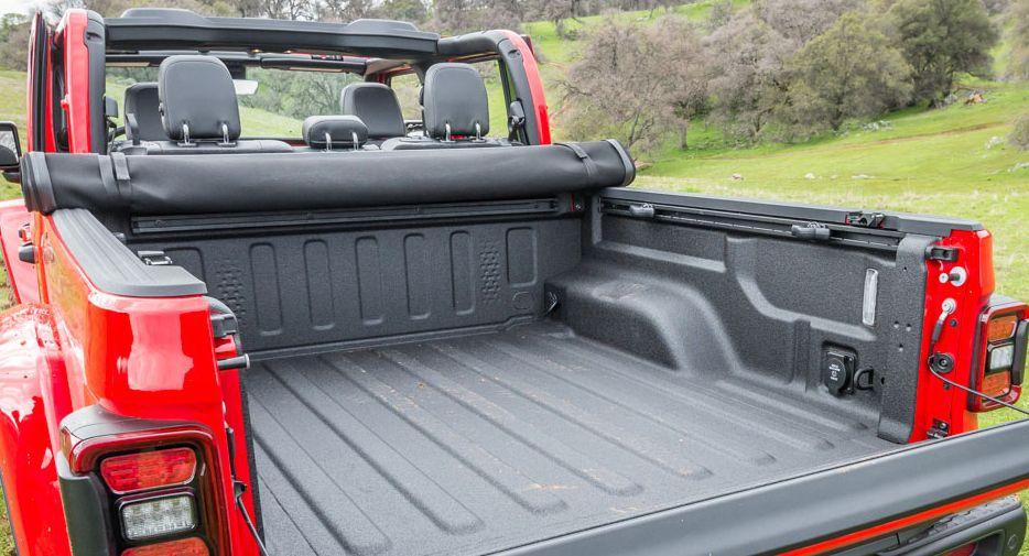

If anyone is looking for a way to fasten anything to the Jeep Trail Rail system, I found that Toyota's bed rail system for the Tacoma and Tundra have the same inside dimensions. My dad has a 2010 Tundra with a factory bed rail system. Since I was looking for a way to fasten a Yakima Blockhead to the Trail Rail system on my JTR and I haven't been able to find anything from Mopar, I thought I'd take some measurements and see if his rails were similar to mine. Lo and behold, they have the exact same dimensions! To confirm my hopes, I ordered some T-bolts off Amazon for $13. I bought cheap ones just to see if they'd fit. They ended up fitting perfectly! Here's a link to them.....
Bolt Dropper Bed Rail Cleat T Slot Nuts for Toyota, (4 Pack), Fits Tacoma & Tundra Bed Deck Rail Accessories & Tie Downs, Fits Screws with 3/8"-16 Thread. https://www.amazon.com/dp/B073ZN63BH/ref=cm_sw_r_cp_apa_i_AcBZDbJN9C0VB
Here are photos of what I used them for.
I also found some cleats for Toyota bed rail systems that look almost identical to the Gladiator Trail Rail cleats.....
Genuine Toyota PT278-35160 Bed Cleat https://www.amazon.com/dp/B014V21Y48/ref=cm_sw_r_cp_apa_i_MzBZDbAQHS9CA
These are almost identical to Jeeps version exc. for the base. Toyota rails don't have detents so these will probably just slide freely back and forth, but they should still hold. I also read in the description that their weight limit is a little less than the Jeep cleats so keep that in mind.

Anyone try to mount a bike this way with the mopar rollup tonneau cover? I just switched to it from a maxmate cover and I don't think there would be any issue with the maxmate as it sits closer to the front of the bed but the mopar is heavier and sits a little more on the front of the truck bed even when rolled up.
I am going to attempt this tomorrow. I'll let you know!
