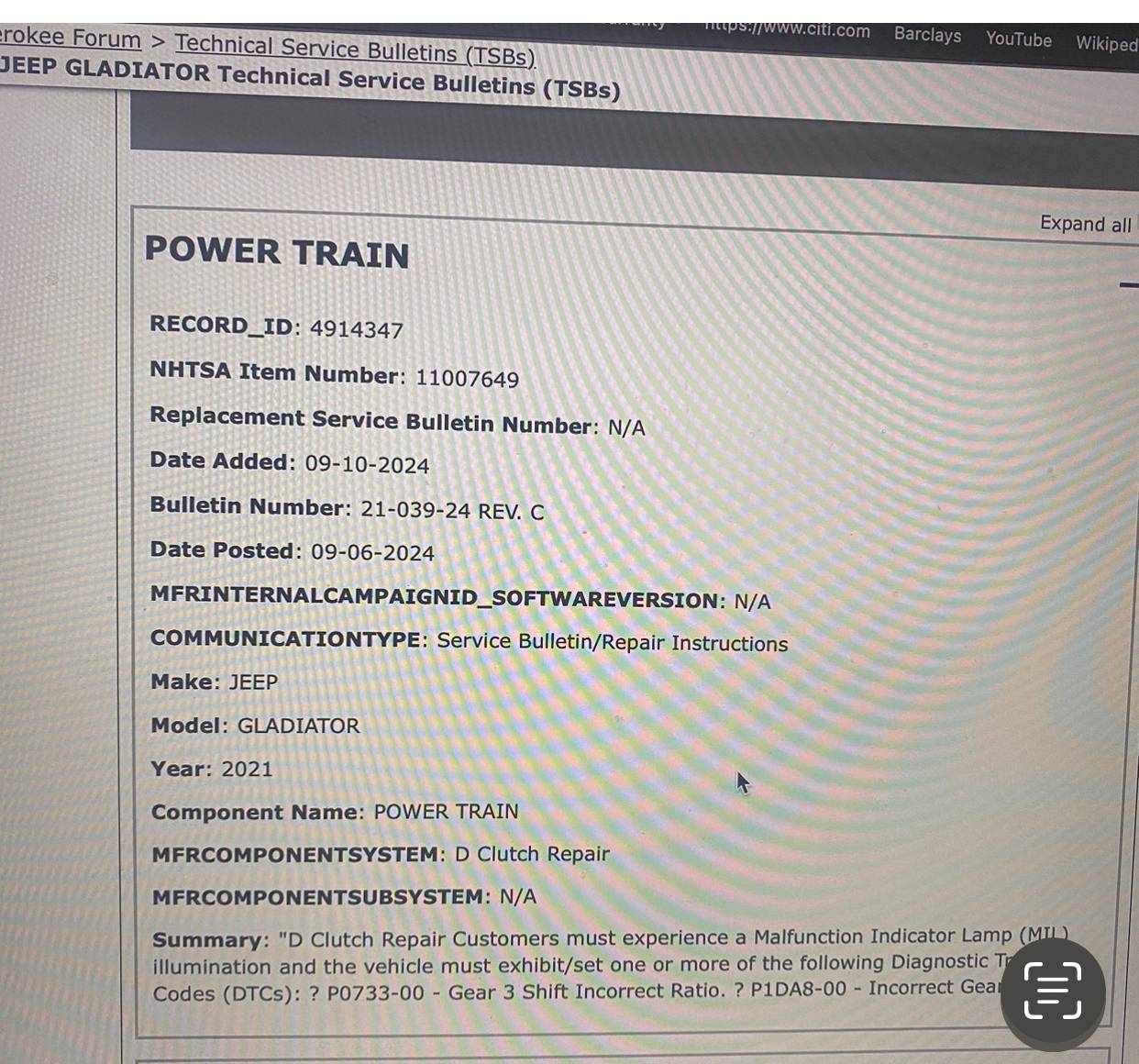

I can't remember who it was on here had one repaired/rebuilt at the dealer . Said it runs great. [
That would be me. Mine was the 2nd one in the US to be rebuilt. This is the TSB that came out late last year. Took about 6 week total. Have about 5500 miles on the rebuild, so far its better then new. Mine went out at 45,000 miles. Service at the dealer was great.
