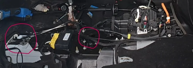

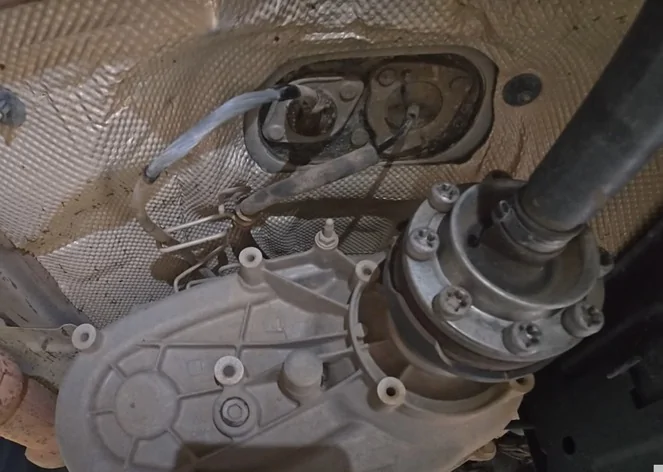

There are two. One is in the middle for the T-case cable and Transmission connector and the other is at the rear for the e-brake cable. And they are bolted in.
I screenshot these pics from a video on my YT channel back when I had to replace the T-case cable.
Thanks thats good to know.
