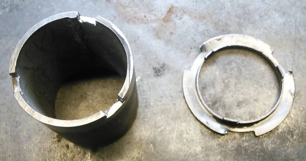

When I don't have the right tool - sometimes I make one -

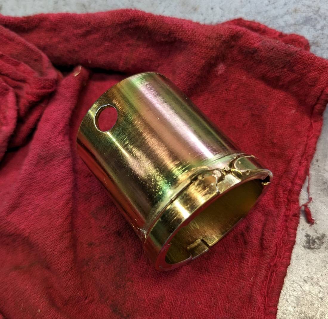

I needed to remove the lock ring holding the sending unit and in-tank fuel pump from my car. It had been in place for years and a hammer and punch just didn't want to turn that ring. So I made a socket to remove it (using a spare sending unit lock ring as a pattern - on the right)
Marked a piece of pipe I cleaned up in my lathe, notched it for the lock ring tabs using a Dremel with cutoff wheel -
Jeep Gladiator Vape pen fell between driver seat and center console IMG_20230524_151304

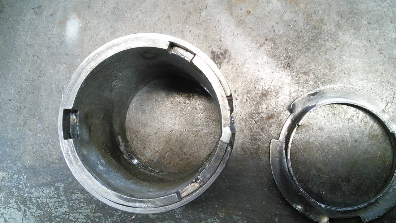

Another section of that same pipe size was cut, and opened up to fit around the "socket" and welded in place to hold the socket onto the lock ring so it couldn't slip off to the side -
Jeep Gladiator Vape pen fell between driver seat and center console IMG_20230524_163209
Then I plated it yellow zinc.
Jeep Gladiator Vape pen fell between driver seat and center console sending-unit-tool

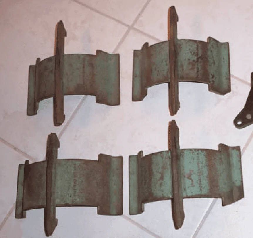

Front spring "compressors" for AMC up through 1969 -
Jeep Gladiator Vape pen fell between driver seat and center console Screenshot 2023-08-26 092939
Spring compressor for AMC front springs 1970-1988 -
Jeep Gladiator Vape pen fell between driver seat and center console spring-com

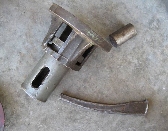

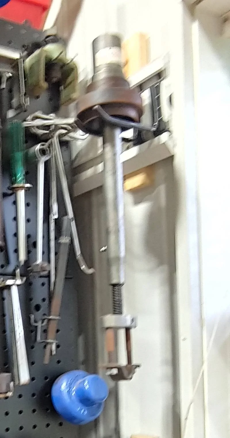

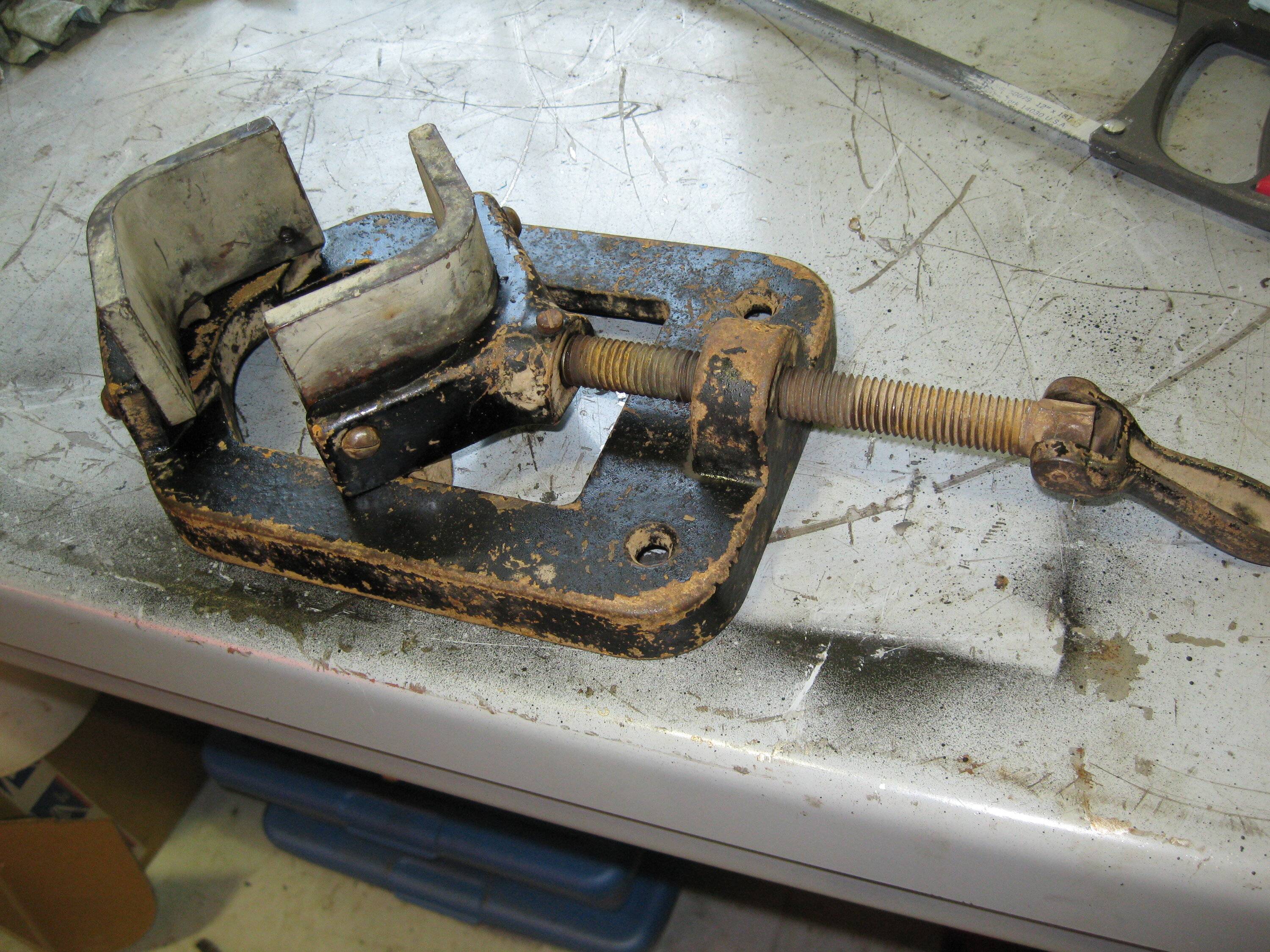

Or, how about - name that tool ->
Jeep Gladiator Vape pen fell between driver seat and center console sx4-exhaust-vise 001
or
Jeep Gladiator Vape pen fell between driver seat and center console javelin-differential-axle-3
or
I’m guessing, but I’d say the top one is a bender of some kind. Bottom one, maybe for honing cylinders?

Bottom picture - for removing the hubs from rear axles to service rear axle bearings and seals on AMCs.
Next one up - the black "vice" is a piston vice - used to hold a piston while either cleaning or machining piston ring grooves, etc.
Dammit. Piston vice was genuinely my first thought. But I second guessed.
