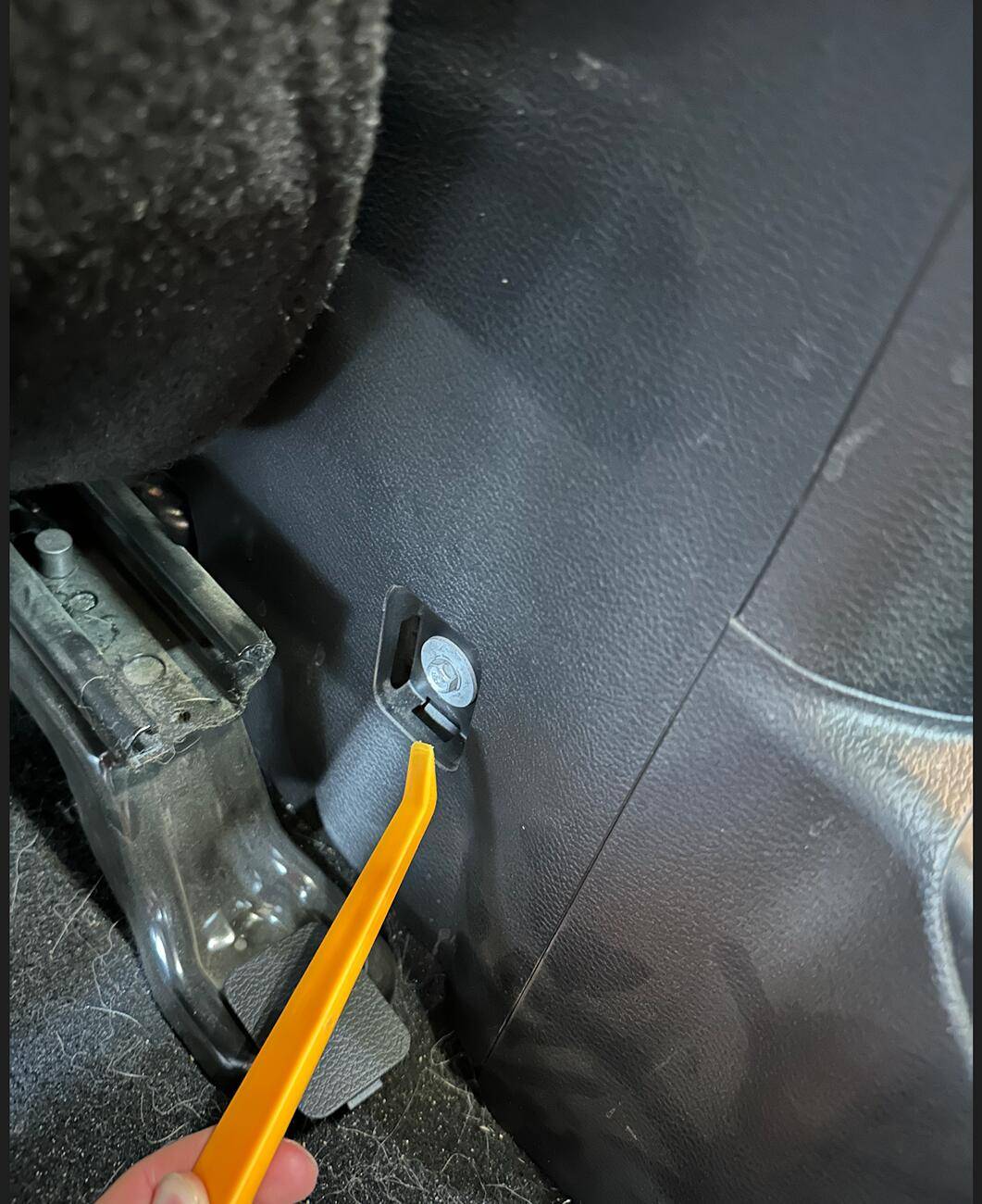

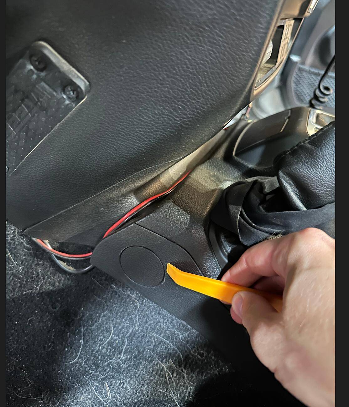

There's been a few posts of lost items in the center. I've lost a CC down the parking break slot more times than I'd like to admit. . It's decently easy to get to.
1. On the front of the console on both sides, there is a covered bolt where it meets the dash. Loosen these about half out.
2. In the rear there are two covered bolts on either side of the cup holders. Remove these.

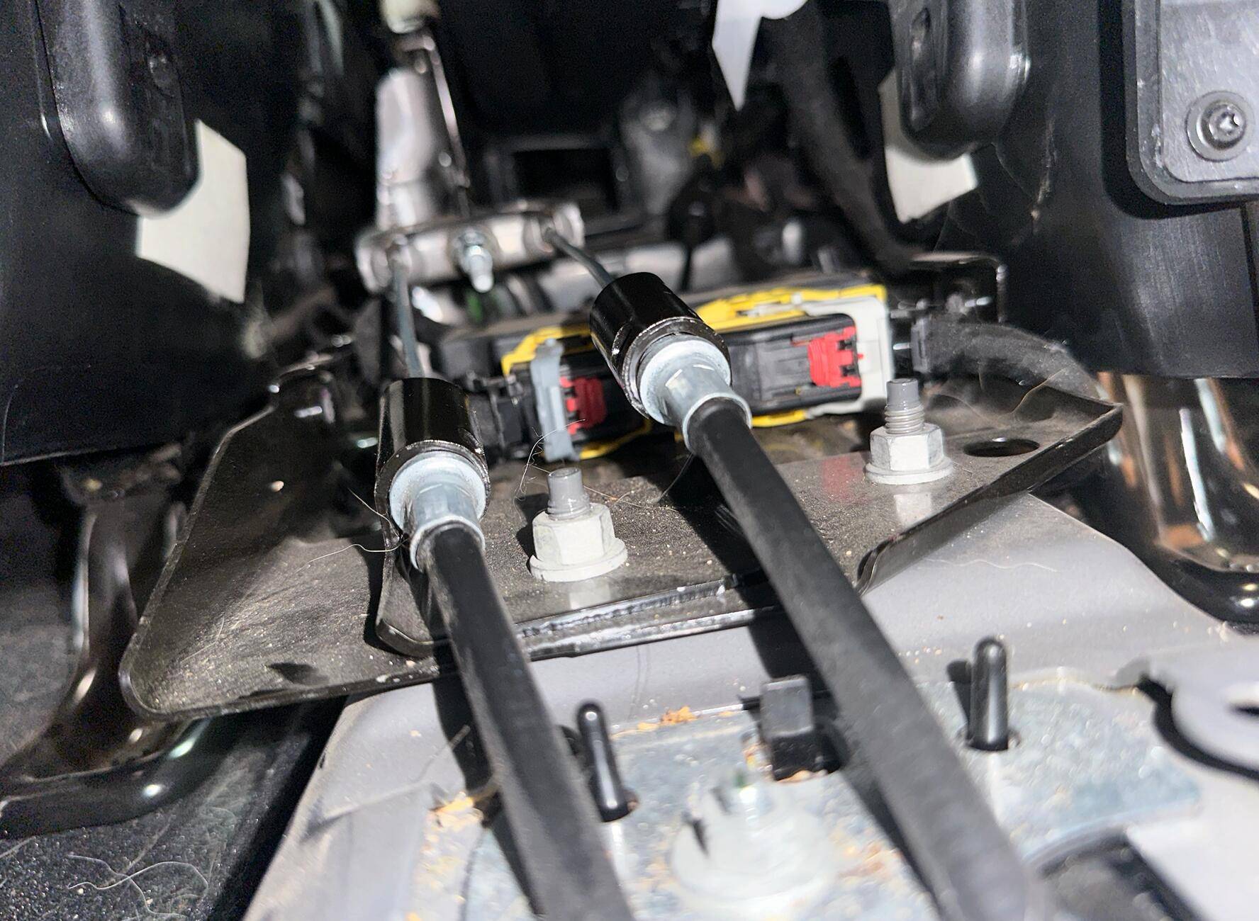

3. This then allows you to GENTLY pivot the back/cupholders up high enough to get (most sized) arms in to reach and feel around. One time I did this I had to use phone video recording with flash on and stuck up in there to get a glimpse of what side it was on.

Yeah definitely a learning experience. I unfastened the back bolts and loosened the front ones like @Undecided recommended. I picked up the back and my son used a magnet reach tool to snag it. It went all the way to the front of the dang console. I had some backer rod so I stuffed it around the opening so it doesn’t happen again… hopefully 🤣
