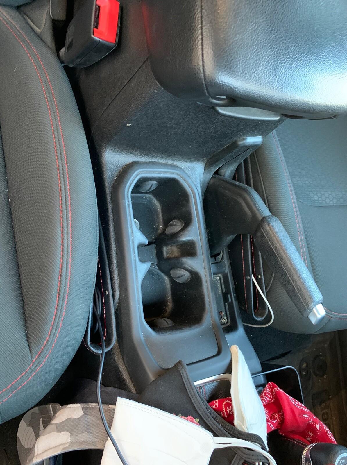

drop down the side abs it will fall into the chasm. Not crazy hard to disassemble, actually pretty easy, but still a pain.

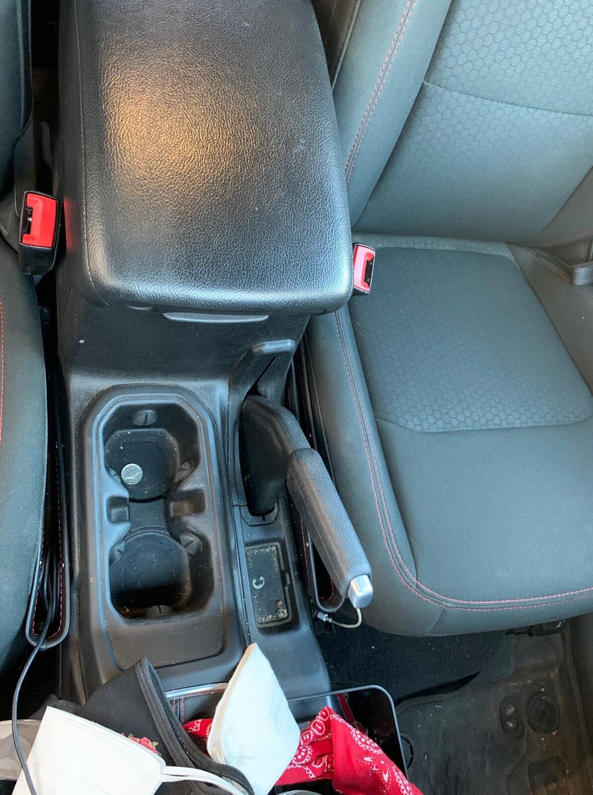

Love my Jeep, but this freaking hole… just spent an hour fishing my buddies key fob out with kabob skewers

count me part of this club now. Key fell down and into the slot.
Got it out by loosening the two front console bolts and removing the two rear console bolts. I was then able to lift the rear cup holders up and pivot the thing high enough to reach under and grab it. I didn’t reach from the sides but straight up the center. Heard some clicks which worried me but everything still works so ??‍♂.

Just had this happen to me today. What a stupid f’ing spot for a hole. Stumbled upon this thread. I have no desire to tear open my console or remove the front seat. At least not right now. My question is, will there be any issues leaving the key fob stuck in purgatory while using the second key? I can still lock the Jeep. I know that if someone were to gain access they could simply drive off but I don’t plan on having the doors off until summer. Are there any other reasons to want to get the fob out of the black hole sooner?
UPDATE
I spent the better part of today lamenting over the fact that my key fob was stuck in purgatory. I finally just decided to lift the center console to retrieve it. It was much easier to do than spending hours online researching, joining a random forum, annoying my wife, and resurrecting a dead thread. So, I apologize. I removed the back 2 bolts and loosened the front 2 and in less than 10 minutes I had my key back. I also had 2 receipts for gas purchases, 3 pennies, and an extractable razor blade that definitely wasn’t mine (I bought Jeep used).

I had that happen on my JKUR. I used a wire coat hanger to fish the fob out then went to Home Depot and bought some 1 " or 1-1/2" pipe insulation and wedged it between the console and two front seats. Problem solved. Did the same on the JTM and on my wife's Compass

I have a Rubbermade pocket thing scrunched I between the seat and the console on both sides. It works well. Good place to store receipts and losing lottery tickets too. 🤪
