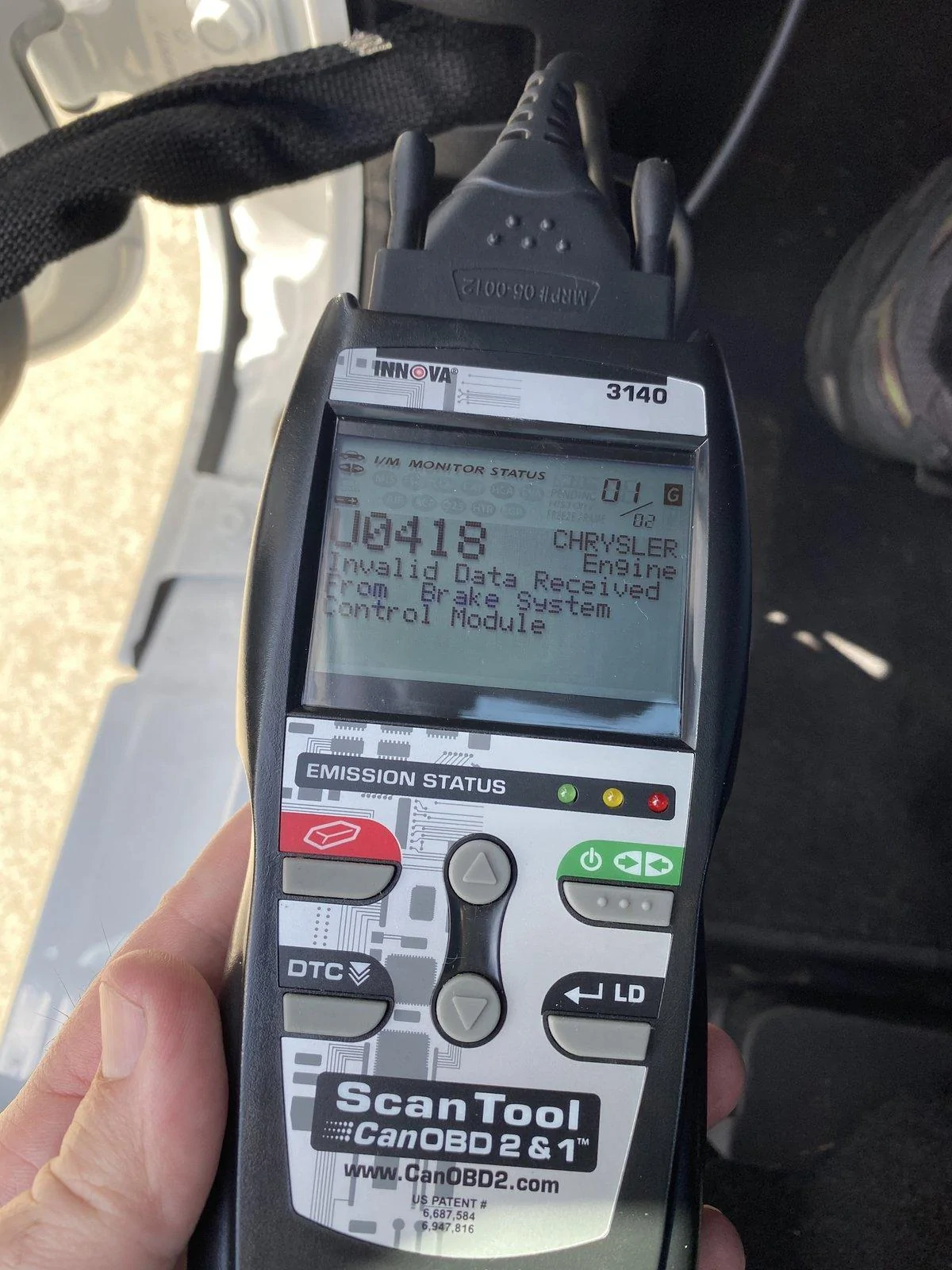

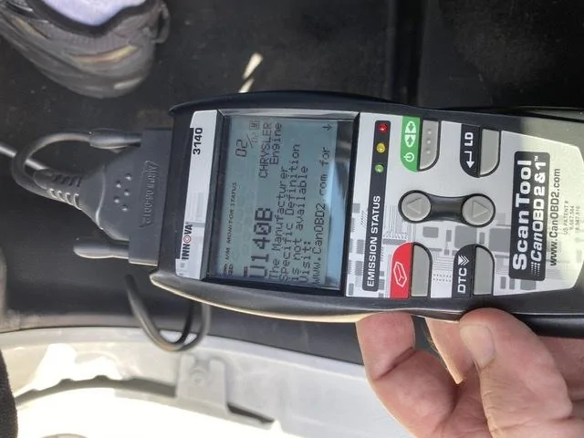

The new codes. Still point to left rear sensor
U140B = “Implausible Left Rear Wheel Speed Signal Received”

Good news, they replaced the left rear axle due to a loose tone ring.
