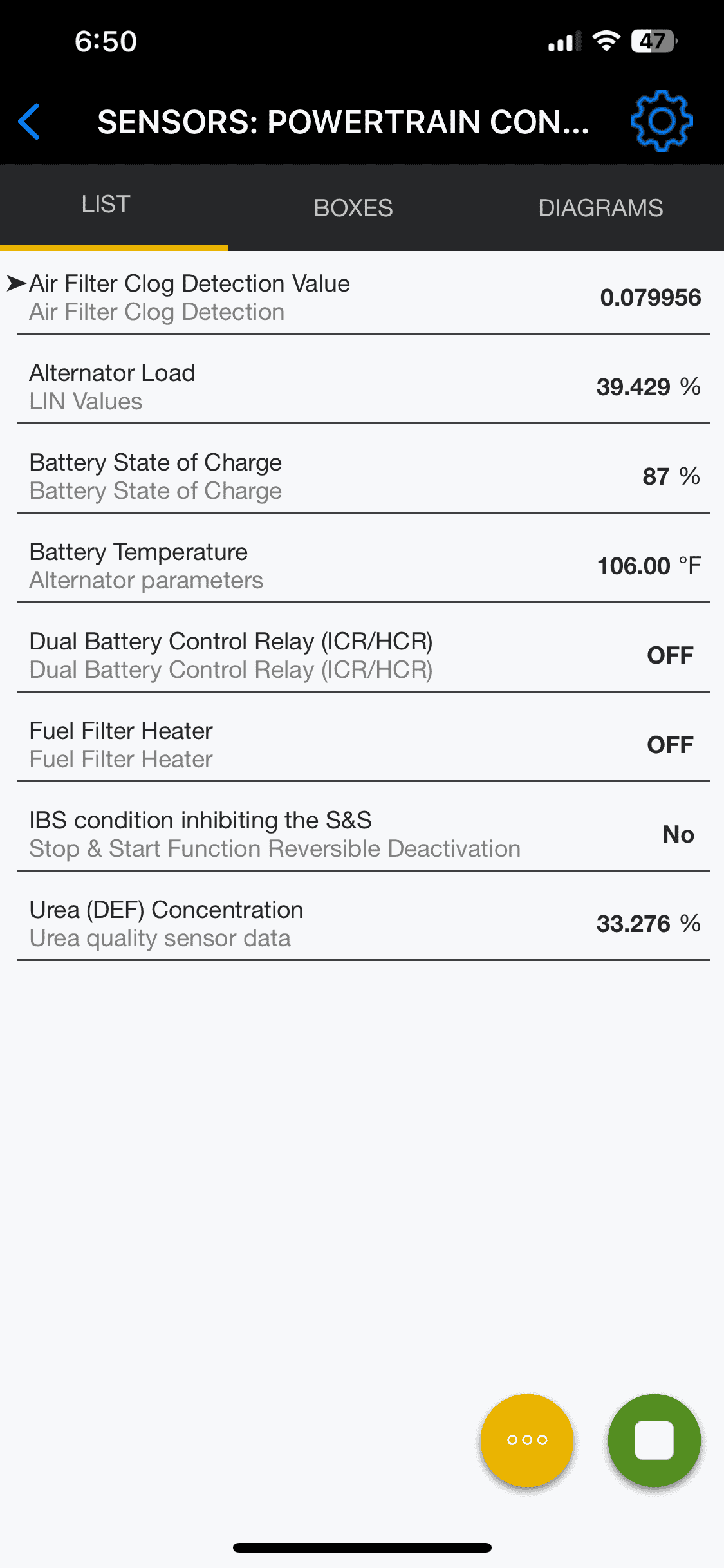

Well I know what I’m playing with later…. Jscan- does it show %?

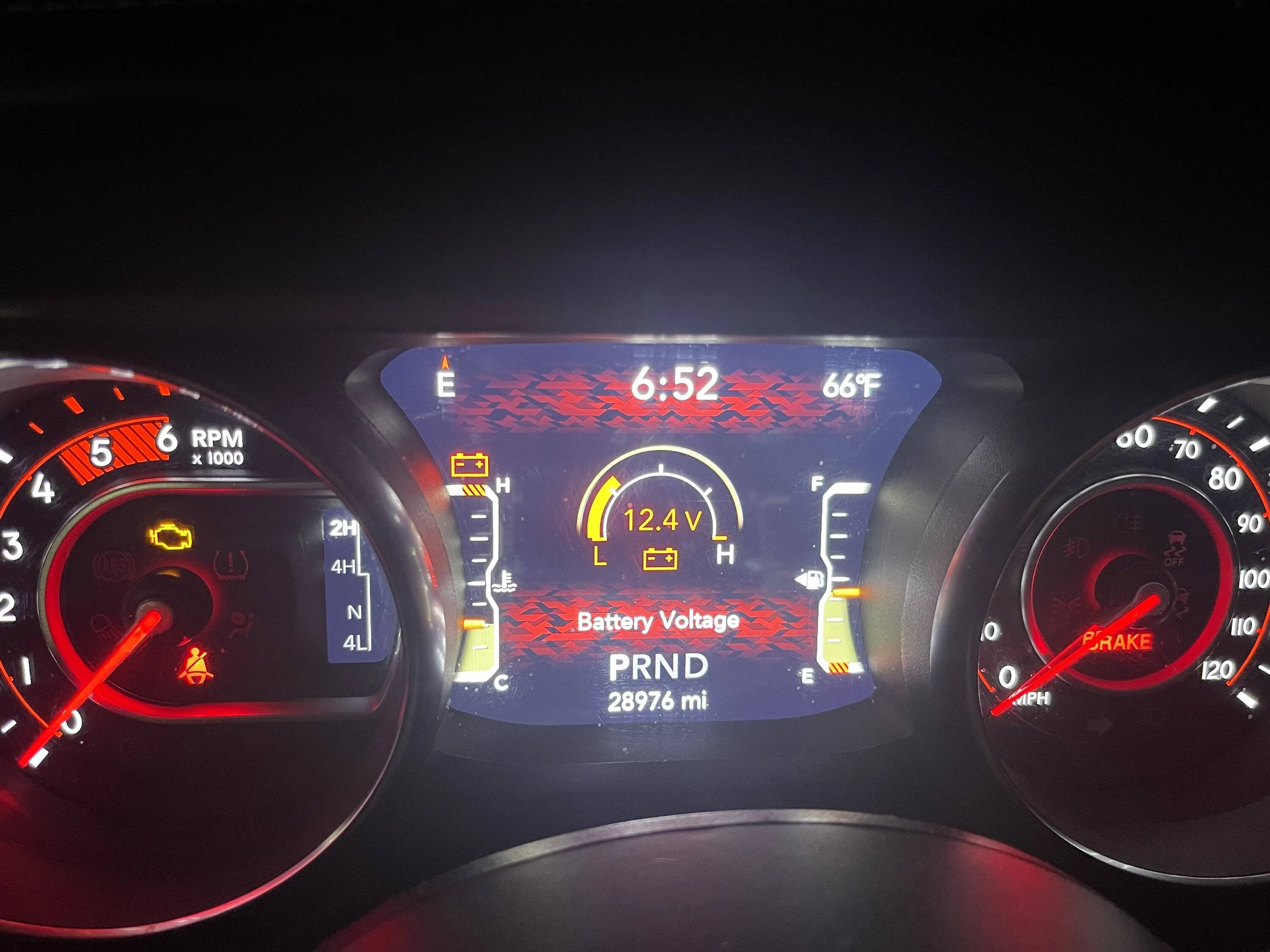

I couldent find anything with IBS %?? My batteries are a month, 2 months old and read 12.4 resting voltage @40-50* 12.2v when it’s in the 20* range.
Not even close to sure where the battery temp sensor is…. But it was a warm 66* outside- I had been ideling for 5-10 minutes while in jscan but prior to this sat for 5-6 hours.
Disregard the few other selections I have shown- figured while I was in there I would check out what does what… ??
