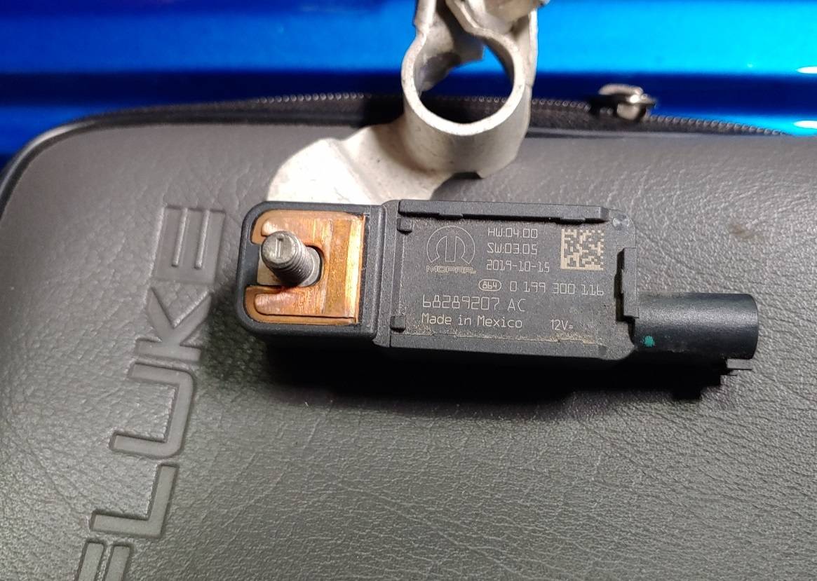

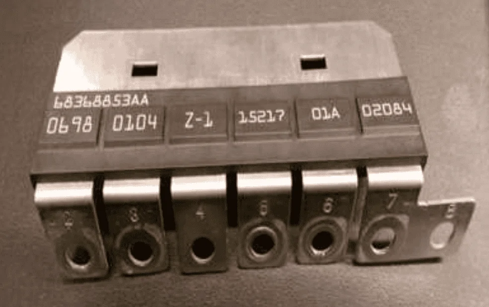

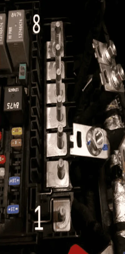

High current fuse array (it's the fuse for EHPS, aux battery charging, electric engine cooling fan, and more)
IBS -
Red arrow is pointing to it -
Well I’ll be, I had no idea that was even there. I’ll check voltage when I get home Sunday. Then get an IBS. Thank you guys for y’all’s help. I’ll let you know what I find out

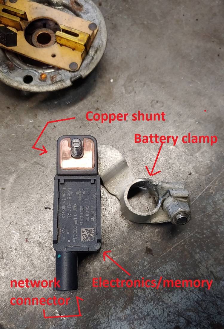

Charge the batteries and while doing so, just disconnect the IBS and lay it to the side for a few minutes. Generally no need to replace it.
Put it all back together once the batteries are charged.

I assume you had the IBS disconnected and set aside while doing the main battery - that will reset it.
With batteries fully charged, and IBS reset, things will relearn and normally are fine.

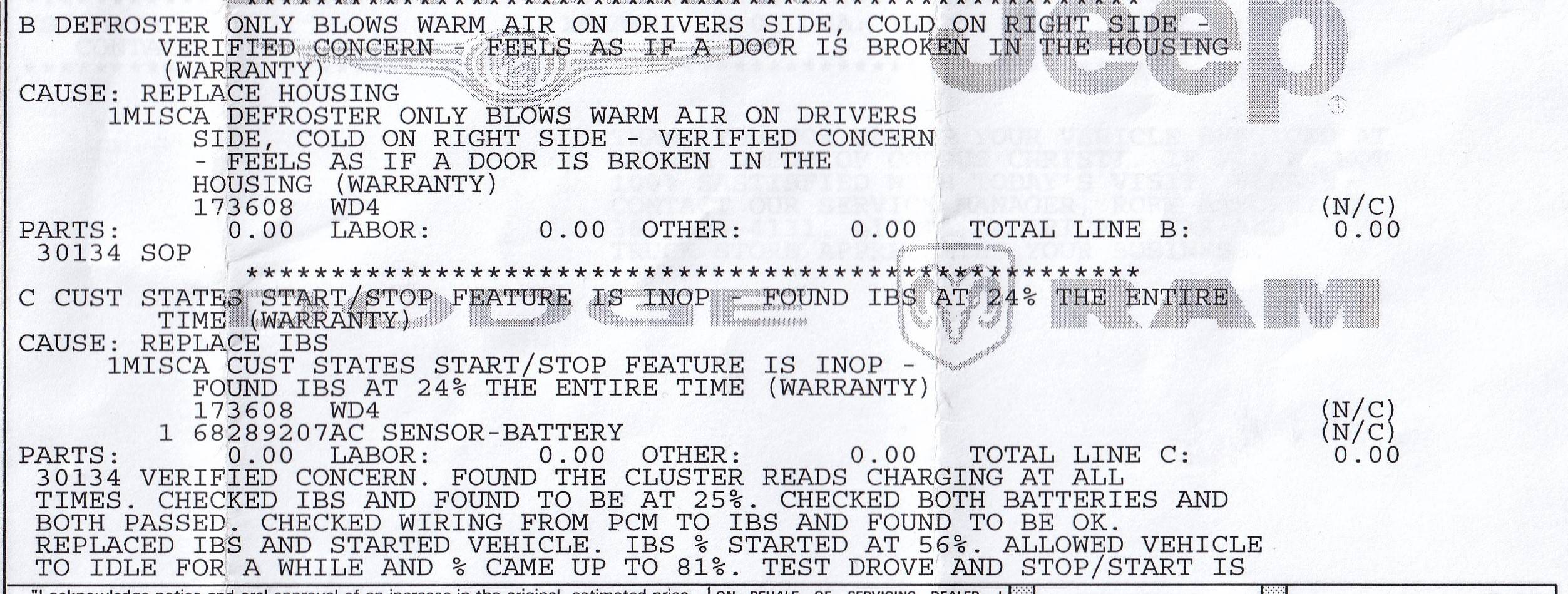

It got cold in S. TX so I turned on the defroster and it only blew hot on the drivers side so I brought it in for a warranty issue. I was told that hot air on one side and not the other was "impossible" but in the end I was told that a door was not opening correctly and they were going to replace the whole unit. Still waiting on parts.
On to the IBS - This really drove their tech nuts because they couldn't figure out why the ESS was never ready. A test of the Aux battery showed it at 25% and was not charging. The answer was to replace the IBS. Paperwork states that they got the aux battery up to 85% with their fix and ESS was working.
My experience: Forgot about ESS because it never worked so I was shocked when the JT trembled at the green light but I realized it never truly shut off. I experimented with the next 3 lights and it never worked. Took a long highway drive yesterday and it remained in a state of "not ready" so I will let them know when the parts for the defroster come in. During this time we got a rare rain shower and I realized the back window leaks. Oy vey!
If I missed explaining something let me know and I once again apologize for the weak initial post. I blame it on frustration.

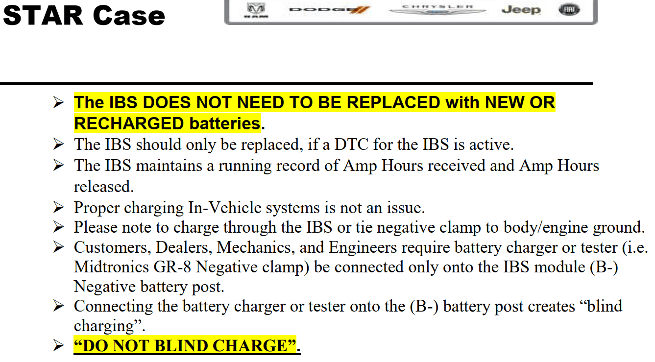

The IBS doesn't really handle the aux battery.......... I get that they were tossing stuff at it to see what sticks, but........ the aux battery is charged directly from the alternator through the high current fuse array, specifically the N3 leg of that fuse array. I could see where if there was resistance across the PCR contacts, it could prevent full charging of the aux battery because the charging current from the alternator goes through fuse N3, through the PCR and then to the aux positive post.
If the aux is low but the IBS says the main/crank battery is hot or fully charged then the aux doesn't get what it needs, so they need to both start out fully charged, and then hopefully over time stay equalized.
As FCA/STAR states, a new IBS should only ever be installed on fully charged batteries. I take that to mean both are fully charged. So ideally, they'd charge each battery fully, then install the IBS. The IBS only tracks amperage going into or coming out of the main battery.
The aux battery negative is connect to the top of the IBS, yes, but electrically, it's connected directly to the chassis/body/engine ground meaning loads can come and go for the aux battery and the IBS would not know it.

Good to know about the defroster! I never confused the issue of the defroster and the ESS. It was a trip to the dealer because of the defroster and I thought I would have them look at the ESS while it was there. Here is the final dealer invoice.
Jeep Gladiator Trouble shooting start stop IMG_20240128_0001
and while there is a second page there is nothing after "Test Drove and Start/Stop is ". Absolutely no mention of it. Second page only calculates tech hours. ¯\_(ツ)_/¯
248
40,500
54,073
I laughed when I noticed the "found the cluster reads charging at all times".
That's really funny - looking at the cluster voltage - instead of analyzing the IBS directly, by reading it through their test equipment.
Even JSCAN can read the current flow through the IBS.

Also, when you ordered and replaced your fuse, you should have noticed that there are two different fuses. Make sure you replaced it with the correct fuse. Not saying it would cause a problem, but it could cause a problem.
