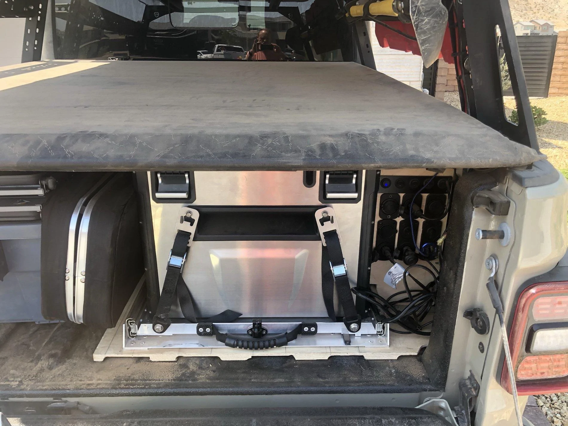

Actually, I'm not. The beauty of using a relay (solenoid) is that it requires VERY low power to operate. The Jeep's Auxiliary switch is only switching the relay on and off. That's nothing. It's the relay itself that's connecting or disconnecting the winch from the battery. The wire Warn gives you to hook your switch to the interrupt kit is only 18ga. It comes with an inline 5 amp fuse. 15 amp is 3x more than it needs, so the inline will blow long before the switch fuse ever will.
Having that relay is what puts my mind at ease.
Here's what's wired to what in my Jeep right now:

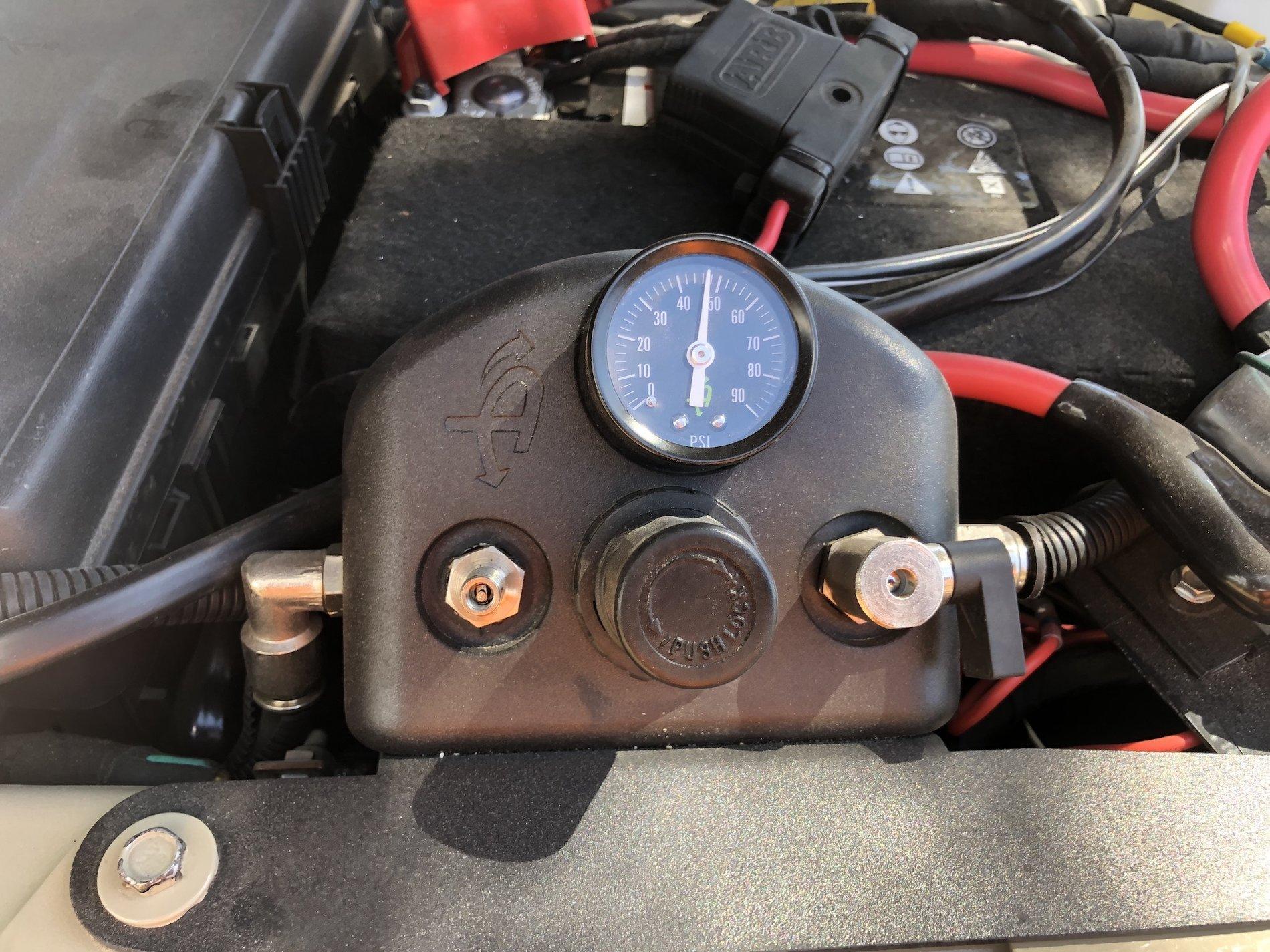

My on-board ARB Twin Air Compressor needs 40-amp. It's small enough wire that I didn't feel the need to install a relay, but it's big enough that I needed 40 amp rather than 15.
And then I also write down in my owner manual anything else I hardwire into the system using the passenger footwell wires (such as my dash cam or radar detector)
Using a pencil to write it all down in my owner's manual is the only way I keep track!

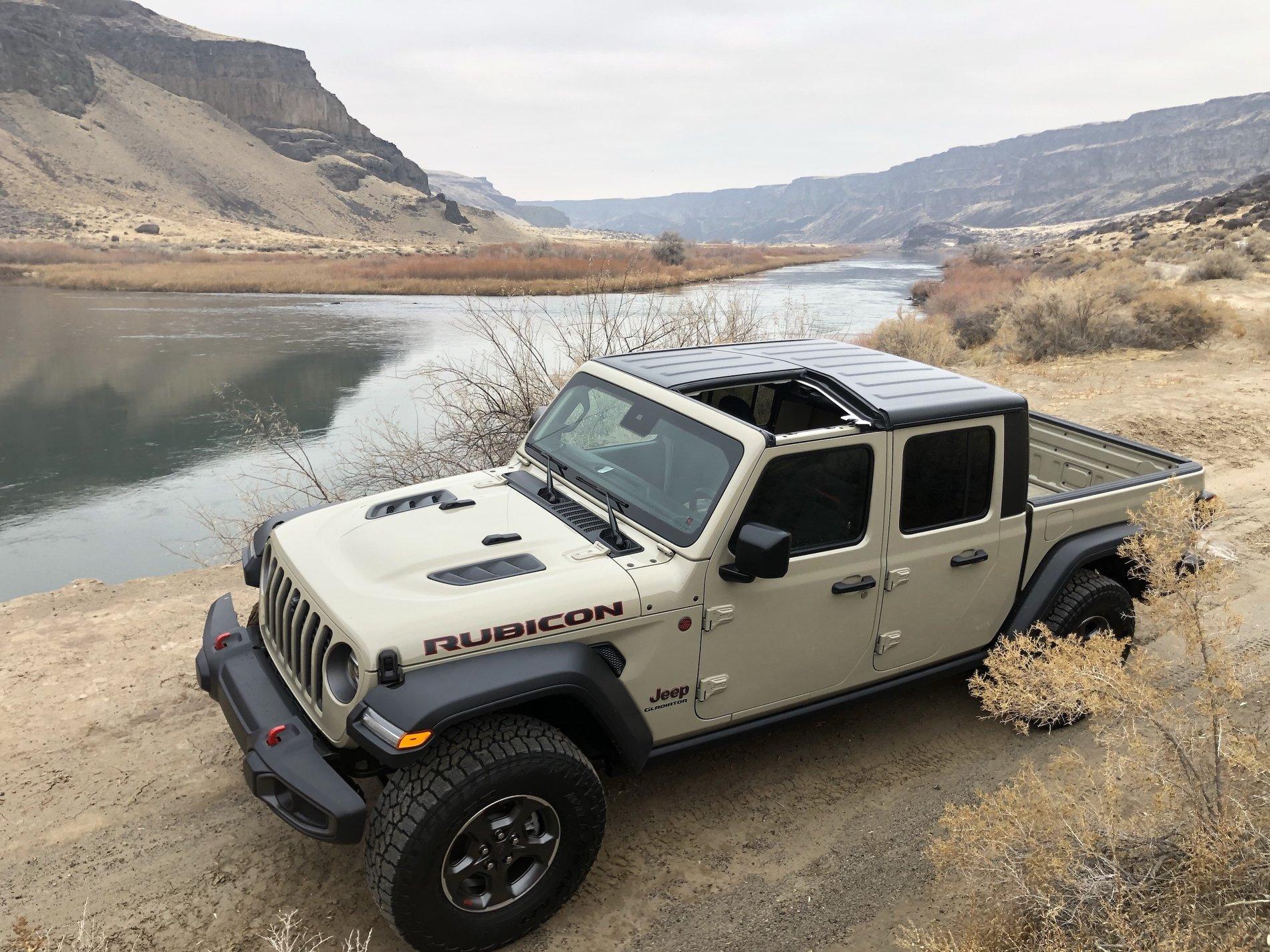

Thanks!! Luckily I had room where you put your compressor, made some brackets...
Jeep Gladiator True Trail Gladiator Build Glad Cam

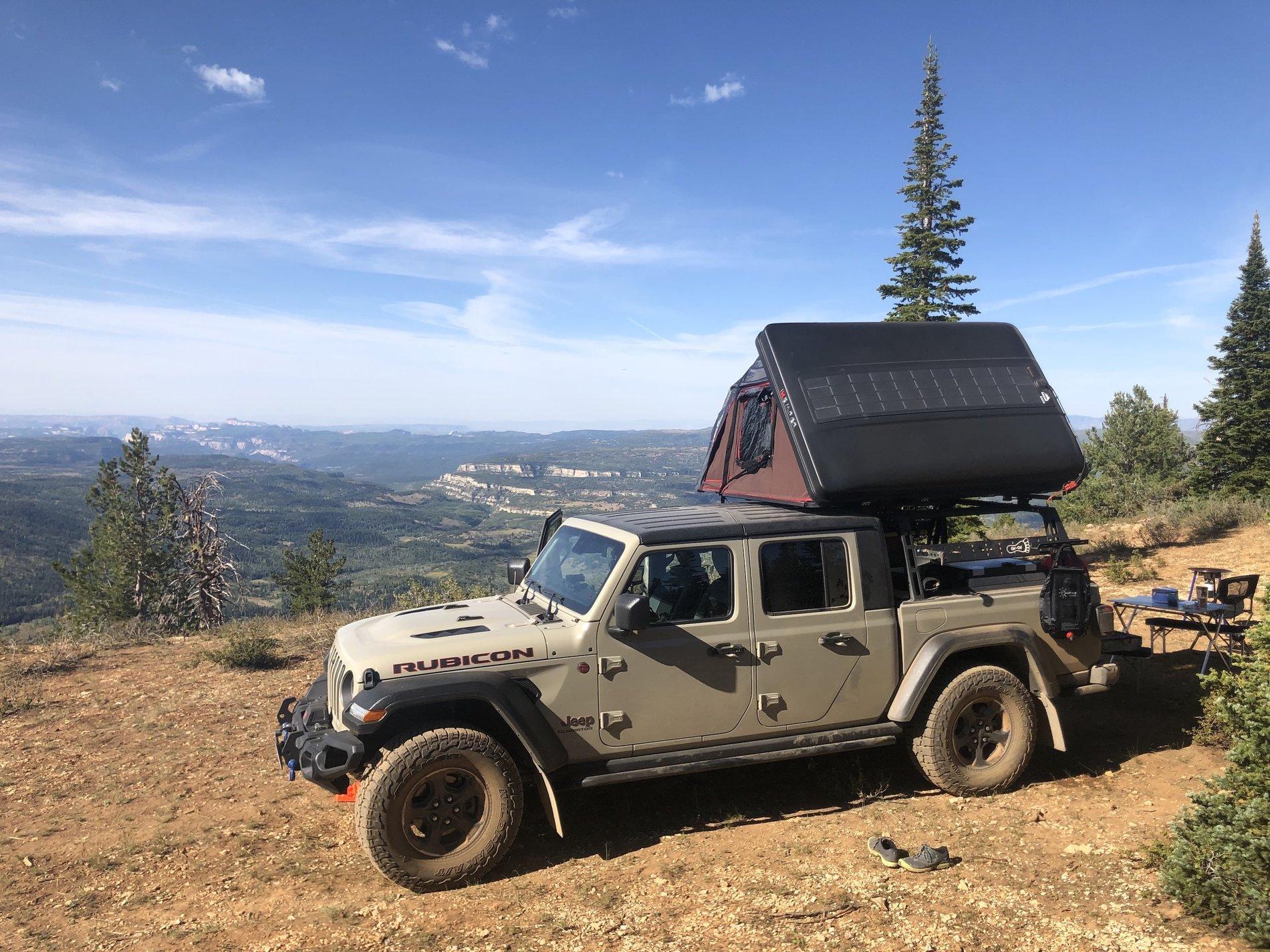

Nice! I’m envious of that covered bed cab. Your setup looks awesome!
It’s funny, I tried to install that same air dam on my hood, but I gave up after it arrived damaged in it’s sealed package twice in a row

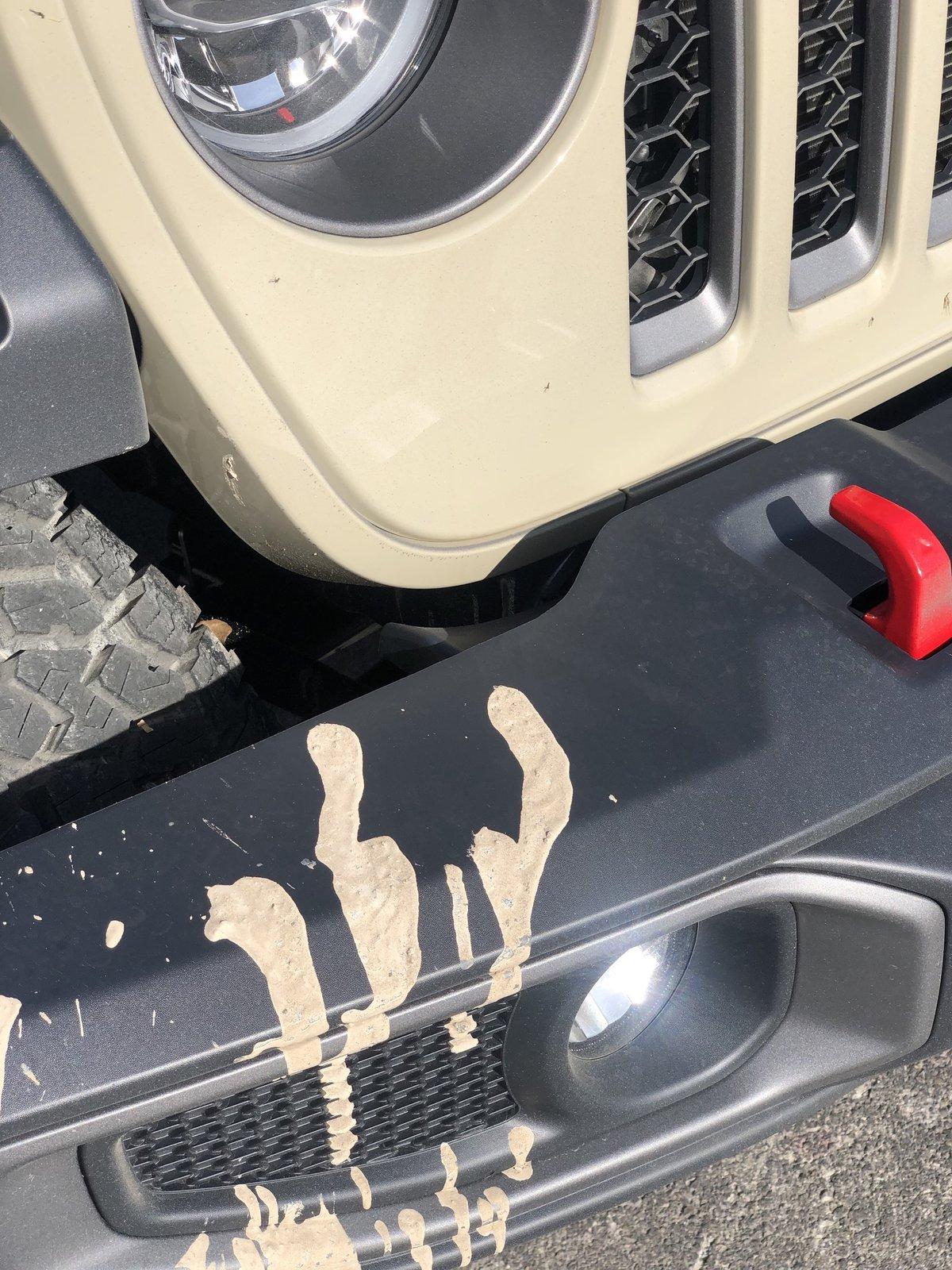

Thanks! Same about yours - and your write up is awesome - appreciate you doing it! The air dam on the hood does help with the bug splatter, third time is the charm!

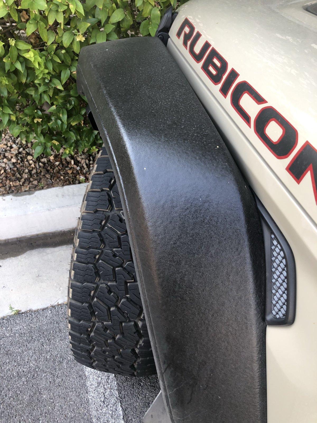

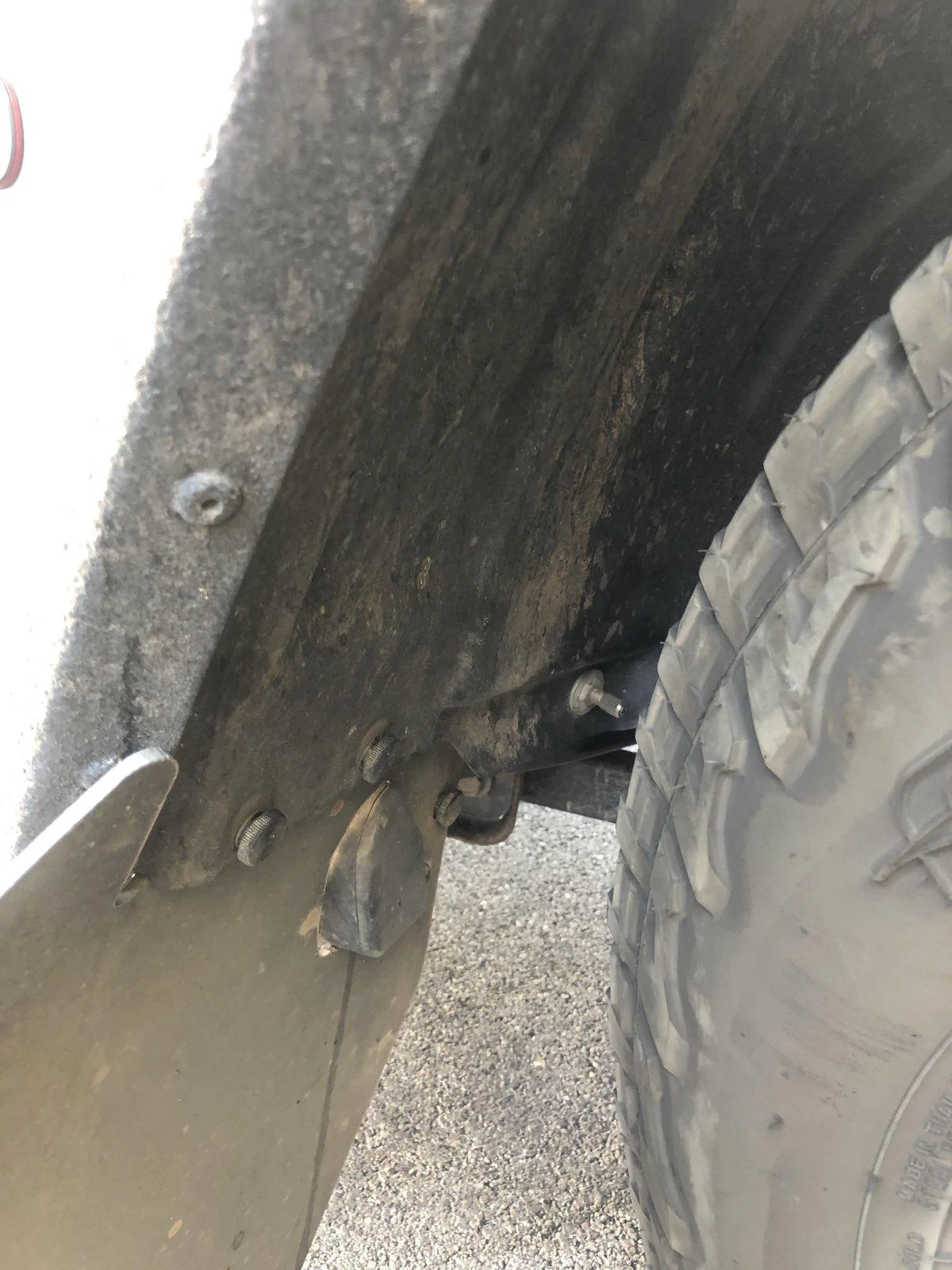

Okay, I just pulled my front passenger mud flap off and took some pictures in the hopes it could help answer your question.
Looking back from the front tire, the mud flap is held on my three bolts, two on the top and one off to the side.
But when you take the mud flap off, only the top two holes have screw thread clips on them.

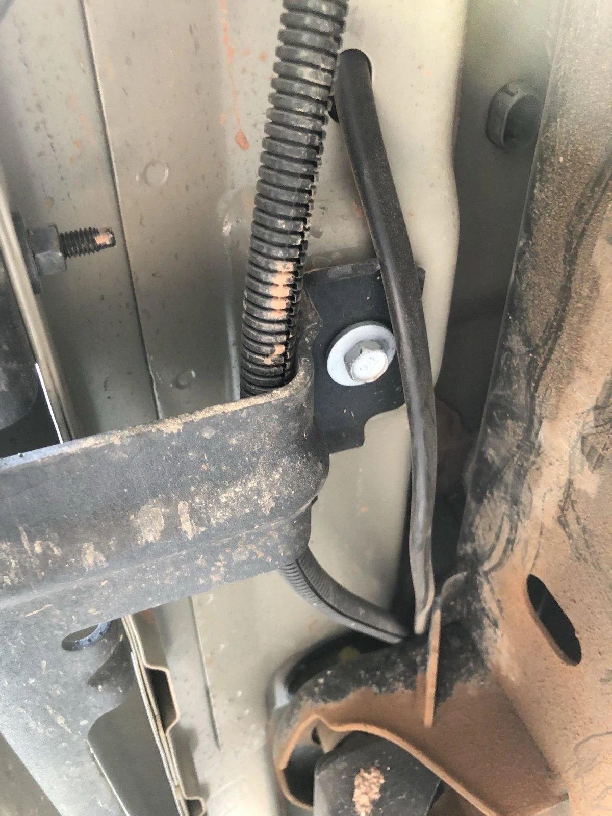

The third, lower screw thread clip fits onto the truck itself
When you look forwards, towards the tire, at where the top two screw go, you sure could be fooled into thinking that the mud flap goes BETWEEN those two layers of plastic. You'd be wrong, unless you're planning to drill out the holes in those two fins of plastic and make them bigger
Instead, install the mud flap behind both layers of plastic. Here's the same view, looking forwards towards the wheel, with the mud flap installed
Then screw in the lower, rear thumbscrew
All the while, making sure that the top wing of the mud flap is on the other side, inside the wheel well, separate from the rest of the mudflaps.
If any of that helps, awesome. Otherwise, sorry, it's what I got, and as you can see, it's all based off a Rubicon fender flare. Best of luck!
