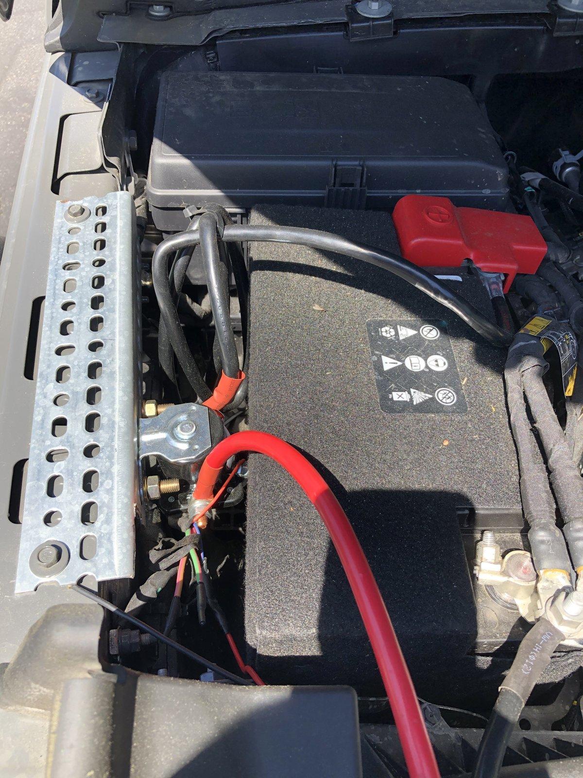

Does anyone know of a bracket / wire holder that fits between the battery and passenger fender in the engine bay?

Looking to place the parts from my winch control box into that space but want it organized and with some protection. Ideas on an off-the-shelf product?

You found this angle at HD and just kind of made it work.
Thanks!
I am putting the control box components from my winch in there so wanted to keep it organized. What material is that bracket?
Also, what solenoid are your running (assuming it's for a winch)?

The bracket is a piece of angle from home depot. It was about 3 feet and I cut it to size. I got the solonoid from summit racing and yes it powers my winch. I have it connected to aux3.

So thats some zinc coated mild steel. Not bad, looks tidy.
Are you looking more for a electrical race track solution? Ive seen some good work with zip ties, don't laugh, like the old ignition wire separators.
Forgive the chris fix nature of the example, can't find the original work I saw which was with data wiring.
