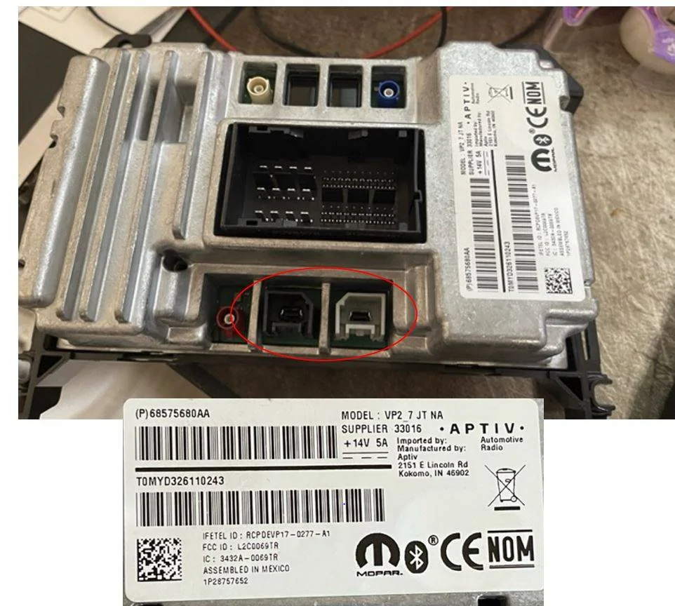

I just recently bought a new 8.4" uconnect with nav to replace my 7" head unit, swap looked pretty simple but when I removed the connectors I discovered that my 7" has two mini usb connectors (gray and black) and the 8.4" has one (gray). I plugged everything in and everything appears to be working correctly except now the assist and SOS lights on the rear view mirror are solid red. Anyone know why there are two mini USB on my 7" head unit, what that "extra" cable goes to and why I might have solid red on the assist and sos lights?

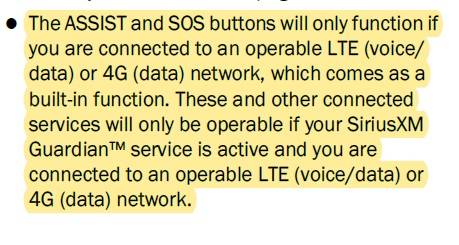

This really is not in the purview of Jeep Cares to drill down on things unless it is "as-built" and most time to just help you coordinate a dealer visit.
The extra USB connector is currently not used.
That being said, below is a screen grab from the owners manual that gives insight that your Sirius Guardian service may not be linked to your new radio to give service. I will say that Jeep does not support 8.4 upgrades to vehicles that were not built with them to begin with and will not allow you to register and get Uconnect 4G services on a 8.4 upgrade from a 7.0 radio. So if your Sirius Guardian is tied to any Uconnect Services, you may be SOL on getting it to see your new radio and give SOS and assist service.

Wanted to update on this post…I have a 2023 jeep gladiator sport s that I just upgraded from a 7” to 8.4” unconnect. Bought a brand new radio and bezel from factoryChryslerparts.com. Total including shipping was $1200. Definitely recommended this as opposed to nismopar, infotainment.com, or used. I too had an extra black mini usb plug from my 7” that didn’t connect to the 8.4” At first I thought it was for the usb ports, but after install and letting the Jeep sit for two hours both ports worked( including the center console that actually runs CarPlay as well and doesn’t just charge only after radio install. My red lights for sos and assist are on, but honestly I only used remote start via the app twice so no big loss. I was amazed that the radio synced so quickly, camera, climate, Sirius, nav…everything worked just by letting the Jeep sit for a couple of hours. I think I probably had less issues since I bought a new unit instead of overpaying for a used or refurb.

Did yoi ever find out what the black one is for? I did a 7" to 8.4 swap and yes the 8.4 only had the grey not the black one also? Just wondering if I need it is all

Apparently it goes to the telematics module "something like that", long story short without massive rewiring it won't have full functionality. It works fine for everything I use, just hate those red lights being on all the time... but it doesn't bug me anymore to the point that I need to fix it.

My telematics works without the black plug, the remote functions in the app work. The red lights are from Siriusxm guardian not showing the new iMei And iccid umber on the new radio on their end. I read on a ram forum that someone called siriusxm guardian and gave them the new radio imei and iccid numbers, and once it was transferred on their end the red lights go away.
